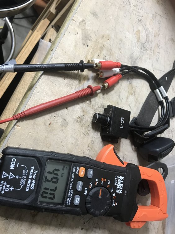

I've got about 6 different models going atm. I'll post some pics when its decided on or done. I'm still trying to figure out what potentiometer to use. I know I need a dual gang linear taper but having a hard time find info on the resistance to use. I've seen lc1s using 20k but I've seen others using 50k.
My LC1 is 50k.  50K gives full attenuation, I wouldnt do less than that.

Hmmm weird. I just took mine apart and my lc-1 is def a b20k ? guess they just use what they got haha. I've got the pots covered my main concern is now the rca ends. Thanks for the info though man its helpful!
