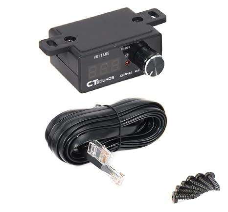

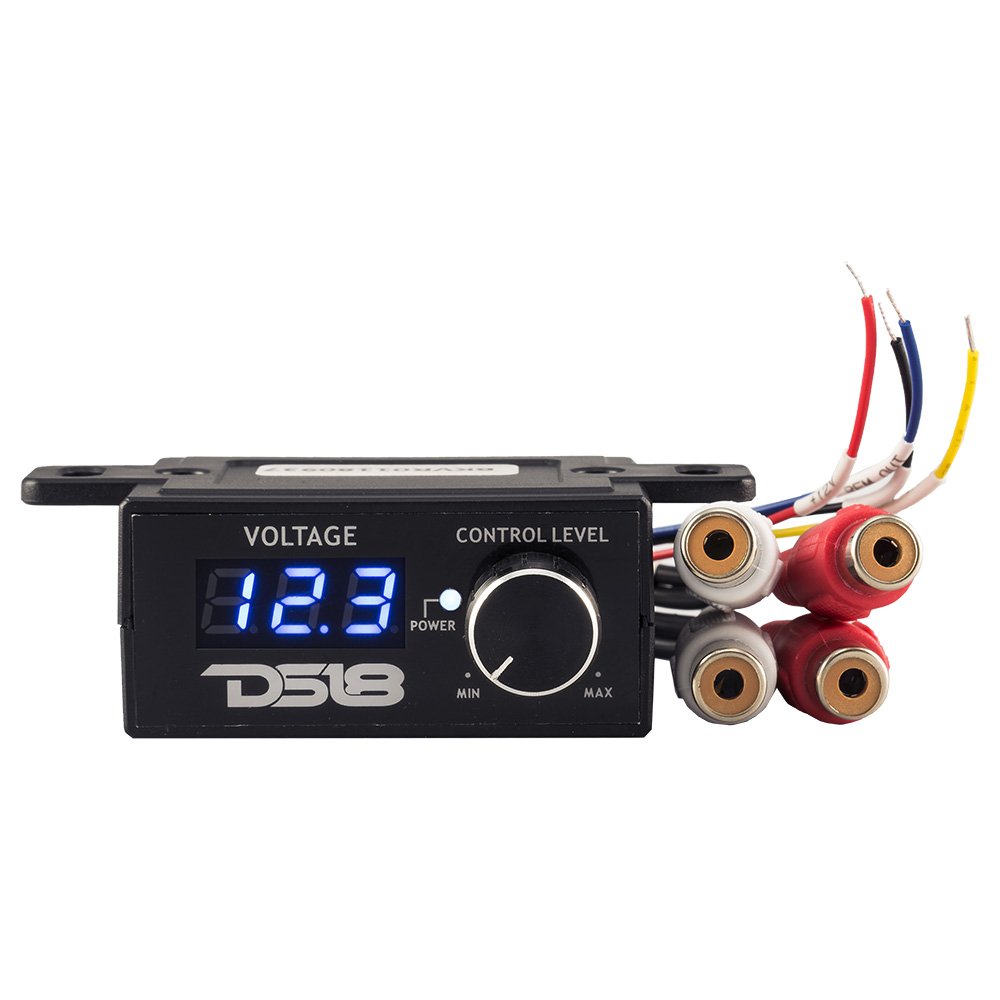

15 hours ago, Crazy 8s Drums said:
Those knobs are fairly crap iirc from all the complaints Ive seen from people, well at least the CT Sounds RCA version  but they are most likely all the same.
They where first designed and used with the CT Sounds amps a couple years ago and used by them, then they added the rca version. Then the whole Paul Kim ordeal who worked for the buildhouse got shafted by CT Sounds. Not too long after Digital Designs was using that knob, and not apparently DS18.
Only the knobs that connect direct to the amp via RJ45 style cable have the clipping indicator, the RCA versions only have a power light with no clipping indicator. Though it looks like the DD knob doesn't have a power light it does but the LED is hidden and when its on the DD logo illuminates red.
