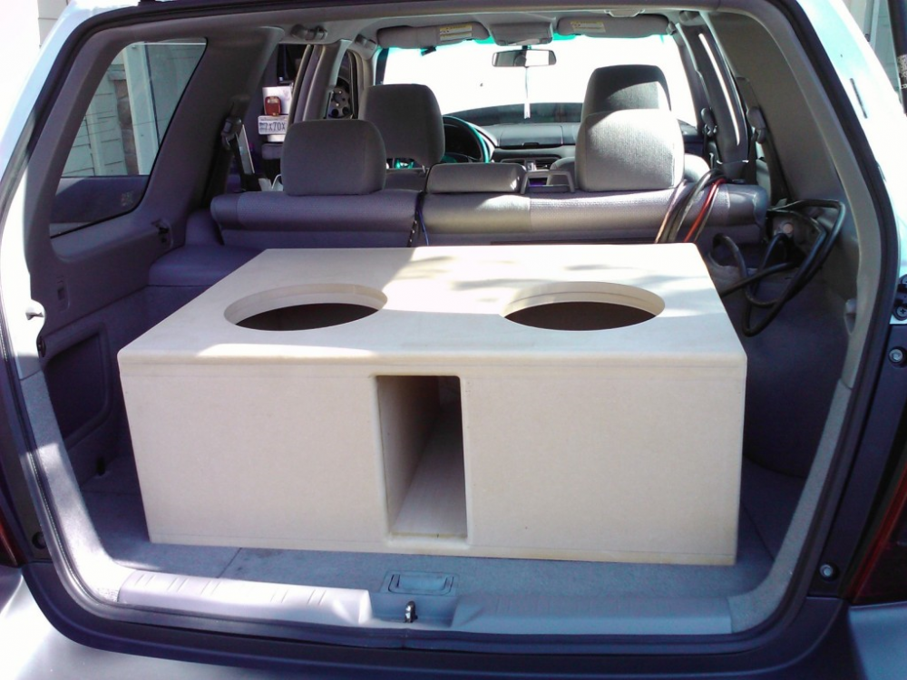

One common chamber, asymmetric sub loading vs. separate chambers, symmetrical, and driver placement furthest from the port opening. Will see if I have box pics somewhere. A lot of my shit got lost in the photobucket fiasco

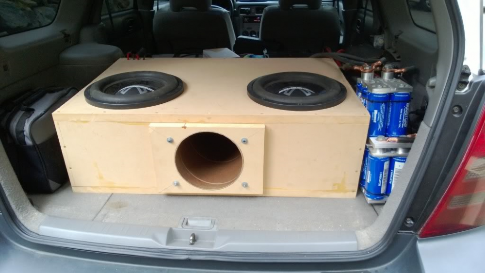

143s
143s. Didn't fuck with it since it loaded pretty poorly. Tuned slightly higher, reduced air space compared to previous box

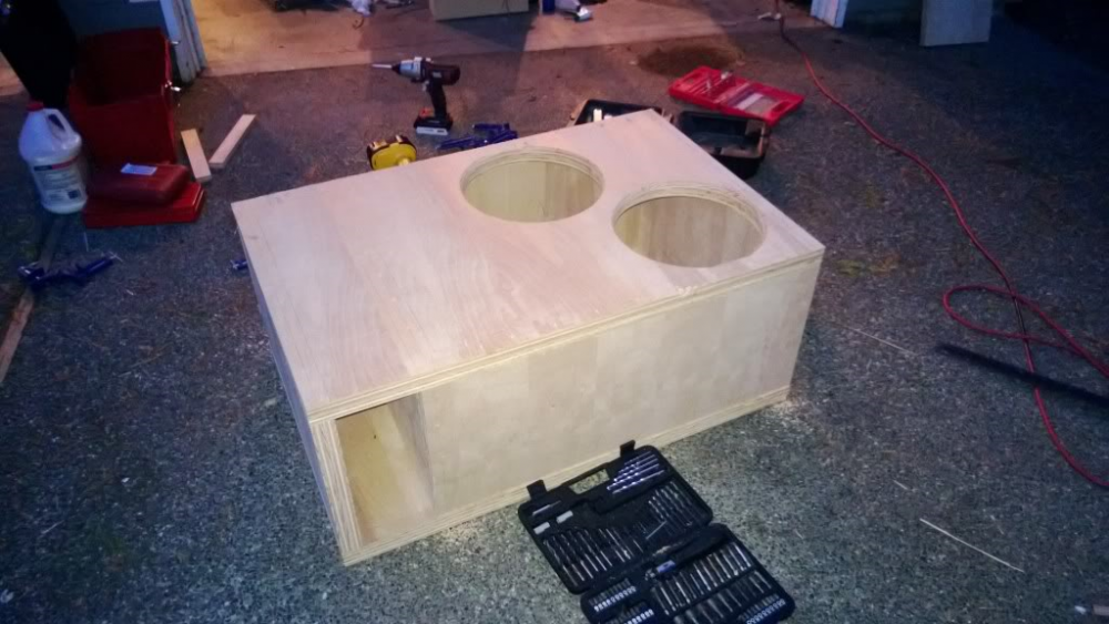

145s. Same displacement and port area of previous box. Shrunk it with some 2x4 and peaked in the high 147s. Actually did this one before the one above. Tried to improve on it without success
This one was just a fail. Bad baffle flex, wasn't braced enough. Busted screws the first time I turned it up

The first box with the port on the side looks like it has lesser port area than the other slotted port ones.
