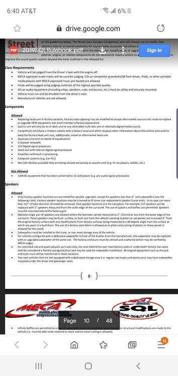

White Lightning Posted October 7, 2019 Author Report Posted October 7, 2019 1 minute ago, ToNasty said: I thought street had to be near stock location and couldn't protrude more than 1" I've competed Street all year, and this design is or will be less than 2 inches (got the rules pulled up on the other tab) ... Kenwood / HELIX / Linear Power (For The Love Of Music) / Brutal Sounds / OverKill Electric Co Questions About Sound Quality ?? Try Here ... Sound Quality, What does it REALLY mean ?? SMD SOTM Winner "White Lightning" 1997 GMT400 Chevy Silverado "The Green Dickle" 1994 GMT400 Chevy "Phantom Dually" Randal's 2007 Chevy Avalanche (we haven't named this one yet) Dylan's "Brutal" 17 Chevy Cruze RS Hatch
