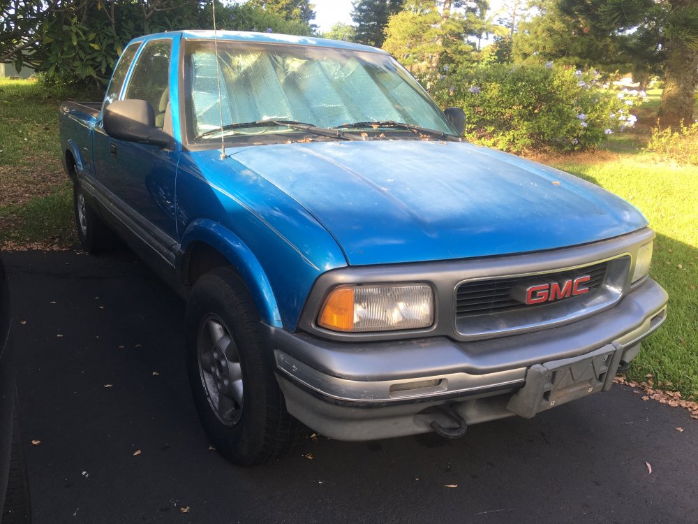

06RTCharger Posted July 11, 2018 Report Posted July 11, 2018 Is that way over my head? To replace gaskets. I know its time consuming with all the disassembly and reassembly, but is there any special knowledge and tools needed to complete a job like that? Shop says labor is almost 2k, gaskets is like $100 lol, im thinking i can save my bros truck and save a ton of money if i do it myself. Im just unsure how technical of a job it is and if theres special sensor tools or gauges ect that would be needed. I know it would make more sense to use the s10forum site but im comfortable here and know ill get some input here. Back story on the truck, i heard my bro got his GED so that same morning i went on craigslist and scooped up the most dencent lookin cheap truck i could find to get him as a present for "graduating". I had noooooo clue about mechanics, it started fine. and i didnt see it smoking during the test drive. I was stoked and so was my bro when i handed him the keys. Couple days later it over heats, oil on the driveway, freeze plugs were leaking and engine mounts were worn out causig the motor to shift and bang the radiator hose causing more coolant leakage. Paid to have those fixed and the shop didnt replace ALL the freeze plugs so then the ones they left started leaking and over heated again. Took it in so they could do it right this time and the head gasket blew after they replaced the freeze plugs. They told us its not worth it to fix all that becuase the labor alone would cost more than the truck is worth. BUT this truck already got a lil sentimental value being i got it for him and its his first vehicle. I feel like diving into that would expand my mechanical noob knowledge if it worked out. Is it worth it and possible for me??? For the sentimental value. Its been sitting forever already but i just cant dump it, besides his value for it, i put a bunch $$ into it already.
