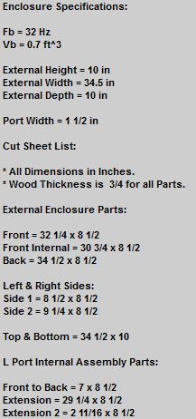

Impression Posted November 16, 2018 Author Report Posted November 16, 2018 Hey Joe X can you redo this in 3/4 instead of 5/8?
Impression Posted November 16, 2018 Author Report Posted November 16, 2018 2 minutes ago, Impression said: Hey Joe X can you redo this in 3/4 instead of 5/8?
Impression Posted November 16, 2018 Author Report Posted November 16, 2018 On 11/6/2018 at 6:50 PM, Joe X said: Here's something different that keeps your internal volume and lets you recess your subs: Power: to subs rated, amp subsonic filter to 28Hz, minimum port clearance 1 5/8", figure is just an assembly guide:
bmwking Posted November 17, 2018 Report Posted November 17, 2018 14 minutes ago, Impression said: Hey Joe X can you redo this in 3/4 instead of 5/8? i just did a box, designed by joe x for 2 CT Sounds meso 6.5s. i used 5/8 for mine and a couple braces and it's rock solid. why do you want to go 3/4? having a hard time finding 5/8? do what i did and use a couple 5/8 particle board project panels : https://www.homedepot.com/p/5-8-in-x-2-ft-x-4-ft-Particle-Board-Project-Panel-1505302/204996444 i used 1 1/4" dowel rod for bracing, but your's being a slot port and double baffled, you could probably get away without the dowel bracing. if you really wanted to (and the change to internal volume would be negligible) I'd say do on from inner face to inner port wall and one from top to bottom. but again, your design looks pretty solid already
Impression Posted November 17, 2018 Author Report Posted November 17, 2018 Yeah I was thinking about the inner face to inner port wall but I have some scrap 3/4 MDF at home so that would save me in cost in going out to but 5/8th. O/T , How do you like your setup?

Joe X Posted November 17, 2018 Report Posted November 17, 2018 2 hours ago, Impression said: Hey Joe X can you redo this in 3/4 instead of 5/8? Sure it can be done in 3/4" wood if you have that: Power: to subs rated, amp subsonic filter to 28Hz, minimum port clearance 1 1/2", figure is just an assembly guide:
