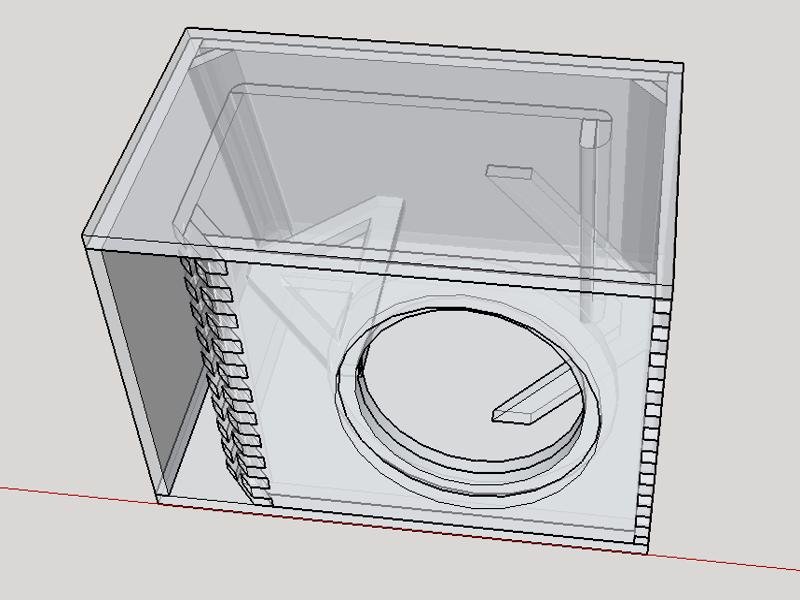

I needed a subwoofer cabinet, but I have only worked in MDF boxes that best match a rectangle. I wanted something a little nicer than MDF, and that fit the angle of the rear seat. I asked for some assistance, and Triticum Agricolam was nice enough to build the box for me.
A design was chosen and built...

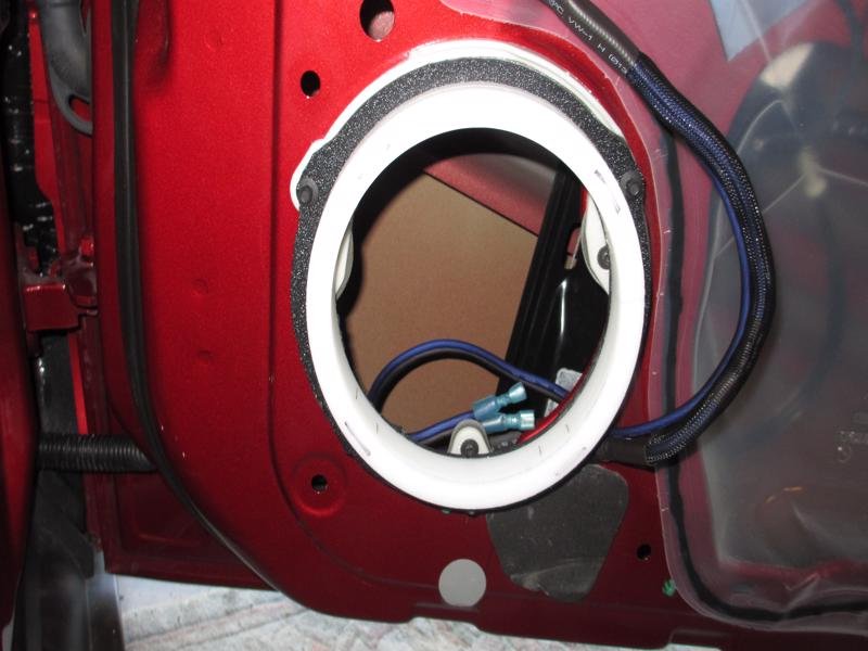

The door panels needed an adapter to accept the Focal speaker components. I never got a photo of the speakers in the door! I guess I got to impatient to have a listen. I also picked up some motorcycles around that time so, distracted might also fit the reason I didn't get the final door photos.IMG_0358-800x600.JPG.a33f64028779ca93ff54b7f85c180ebc.JPG

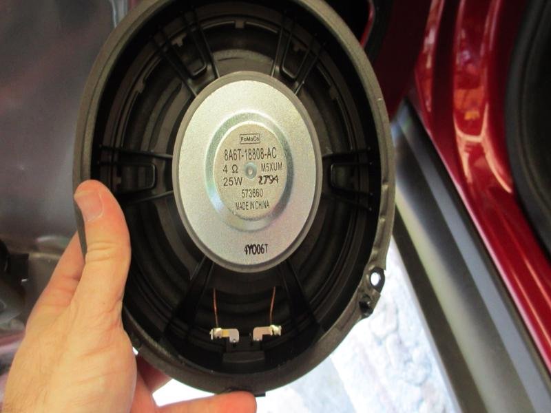

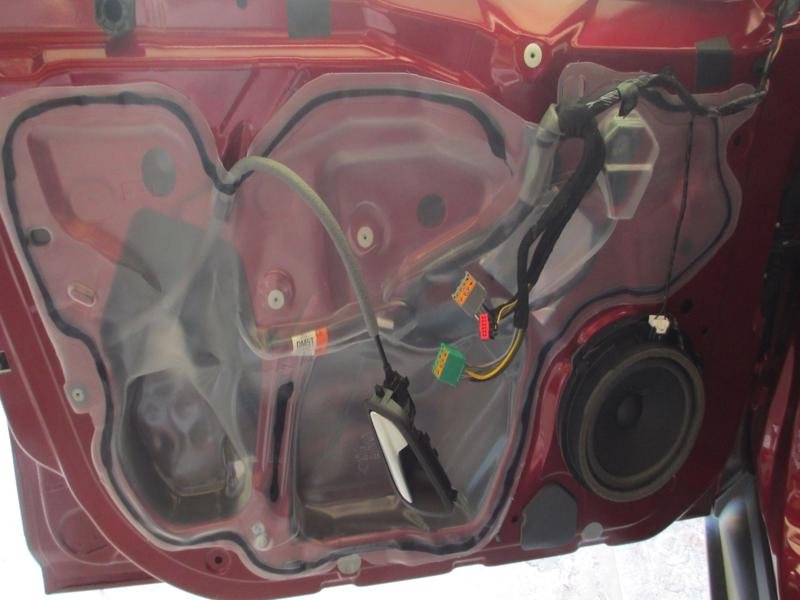

Stock Ford speaker has an adapter ring built in that doesn't exactly match a round shape. i'd need to copy this to plastic.
Stock speakers handle a massive 25 watts. Although I'm pretty sure my cellphone speaker gets louder than these jokers.

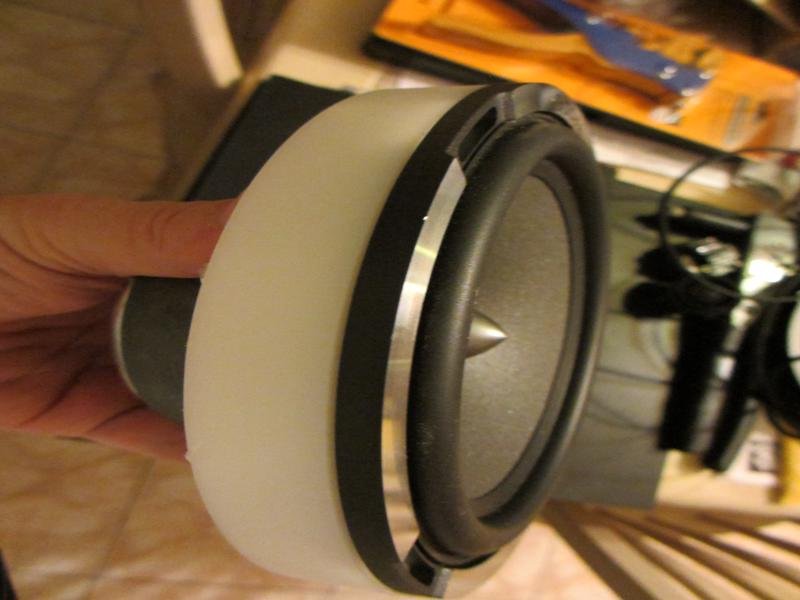

Checking some spacers that I made for the Focal speakers. All 4 door speakers will get the same sound.IMG_0442-800x600.JPG.269f6ba3d4b7b82a58f9161c8079ea7e.JPG
Adapter rings looked good. Nice tight fit that I was happy of.
Spacer rings and the adapter attached to the doors.

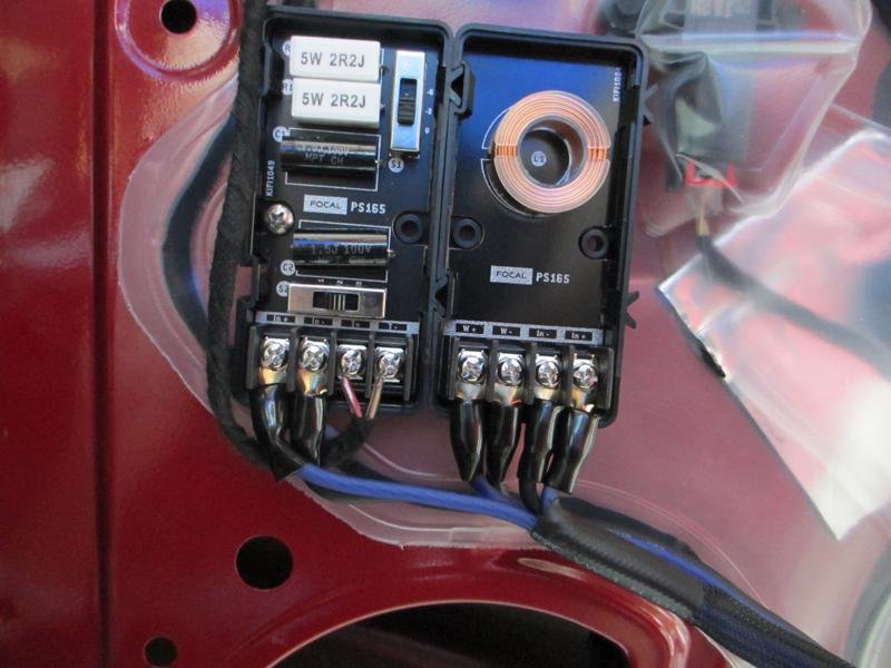

There wasn't much room for the crossovers, but I managed.

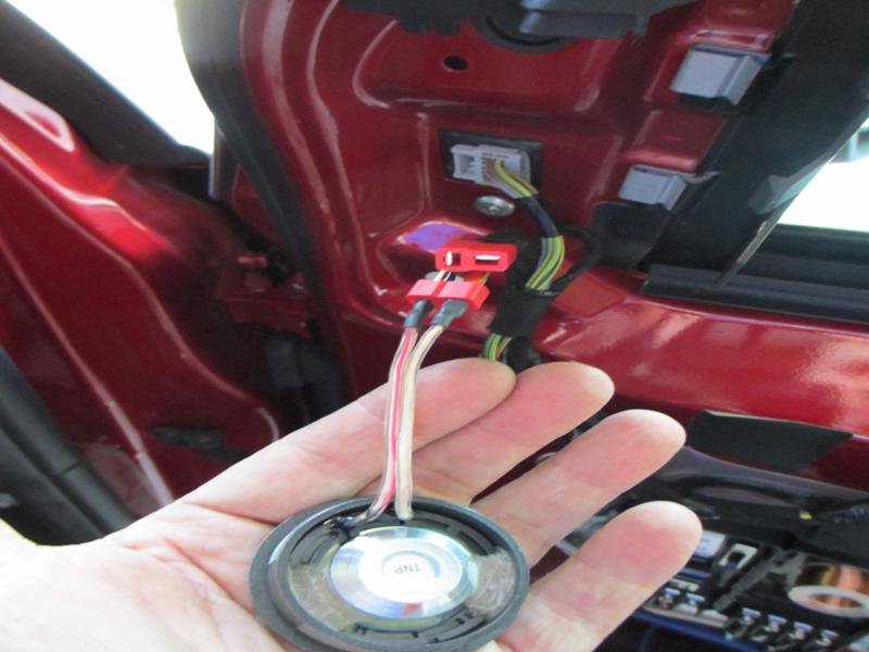

The tweeters would get a little connector installed on them so that I can remove them if needed. I used these connectors in RC cars and had them laying around.

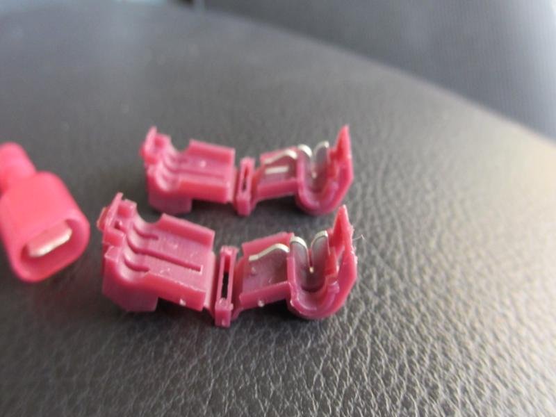

I call these "Vampire" connectors. They crimp onto the existing factory stereo wiring and allow a somewhat less permanent way to get audio from the head unit in case I want to change anything in the future. (That's still an option here.) BUT!!!!!! The closer connector is missing a slit that the slide-in terminal connector required. It took weeks to chase down this problem and I almost sent in my amp for an unnecessary repair.

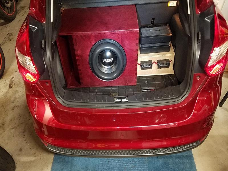

I'm running to 600k file limits I think? So here's a final picture of the build. Yes, on the final install day, it rained on me! I had to scoot my car's butt into the rain so that I could see the wires. Sun was still shining brighter than my garage lights.
Build looks awesome my only complaint is that poor sub  wants way more power . My SA’s can handle 1.2k each but if U love it I love it. I’m sure it sounds great .

Those box joints are the real deal! User Triticum Agricolam from this form cut those box joints! He proposed those over kerfing the port, and I loved it! That's one part of the box build that I could not do after that box was stolen. And something that I majorly miss in this rebuild.
