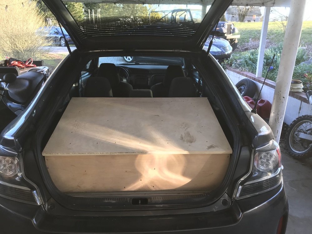

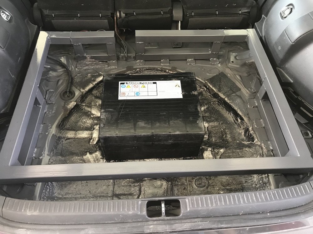

Sequoia_Bass Posted March 18, 2019 Report Posted March 18, 2019 One of the things many people face with limited box space is fitting a decent port in. I'm having trouble even designing a port for over 12sq inches per cube wich is way too small. I have a 2015 scion tc, the tire well is so shallow i had to weld in a frame so i could fit a batter under the sub box. I have the frame and then a "false floor" then the box. the usable dimensions for my space after the false floor is 38'' wide 24.25'' deep 18'' high at the back and then 11.25'' at the front. 18 inches at the back is pushing it though i would rather it be 16. but 18 is totally fine if i helps. I already made a box with these dimensions. except it is 16 inches high. although with the 16 inch high back i had to put another panel ontop of the box because the sub was taller than the enclosure. my trouble though is that i'm having a really hard time fitting both the sub(sundown zv5-15) with the ports. i'm going to have to make a new box but i was wondering if anyone was willing to assist me with designing the new one. p.s the welding done on this was my first welding project, it's not pretty but it's strong.
Joshdashef Posted March 18, 2019 Report Posted March 18, 2019 Damn you have that sucker snug as a bug! Can't help you design a box but @Triticum Agricolam along with some others are excellent builders/designers. Goodluck bro SMD Tool Map (2024): https://www.stevemeadedesigns.com/board/topic/226545-smd-tool-map-2024/ Great Box Bracing Examples: https://www.stevemeadedesigns.com/board/topic/202148-best-way-to-brace-a-box/?do=findComment&comment=3055002

Sequoia_Bass Posted March 18, 2019 Author Report Posted March 18, 2019 21 hours ago, Joshdashef said: Damn you have that sucker snug as a bug! Can't help you design a box but @Triticum Agricolam along with some others are excellent builders/designers. Goodluck bro haha yes it was a tight fit. I had to fold the rear seats down, pick the box up over the trunk as far into the vehicle as i could and then drop it down and slide it back.

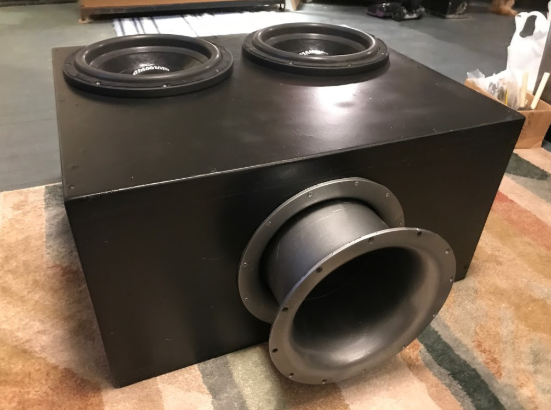

k58.cross Posted March 19, 2019 Report Posted March 19, 2019 Ah so you want to have your port coming out of the top of the box? That's possible with aero ports, and maybe you don't need to bend, check this example pic: My system is in dissaray right now because I'm renovating it a bit and making things look better. I got my box done though and this is how I have it set up: It's a compromise though. I know I need more port area for the power I'm trying to run. It's a small car though so just doing what I can for now.
Sequoia_Bass Posted March 22, 2019 Author Report Posted March 22, 2019 i totally understand your system being under construction, good luck. props to you for dealing with limited space though. unfortunately i only have 3 inches from the top of the box to the trunk lid. and then i have about 16-10 inches of box depth best case i could fit a 10inch port without a bend haha. i did try a single 8 inch port tunned to 30hz tonight, same style as yours and it was better than i excpected but i had port noise, i know there is potential being wasted. also it took 28inches so, 8 inches were sticking out of the box wich wouldn't let the seats fold up. want to trade cars haha. maybe a slot port is the only way to go with this system. it just takes up so much air space for the amount of actual port area you're getting. and less efficent than aero ports
