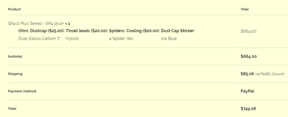

Joshdashef Posted April 4, 2019 Author Report Posted April 4, 2019 That feeling when you drop more on a single sub than your mids and highs and their amp... 😂👍 Honestly expected shipping to be 100+ not that bad going from Las Vegas to Florida SMD Tool Map (2024): https://www.stevemeadedesigns.com/board/topic/226545-smd-tool-map-2024/ Great Box Bracing Examples: https://www.stevemeadedesigns.com/board/topic/202148-best-way-to-brace-a-box/?do=findComment&comment=3055002
