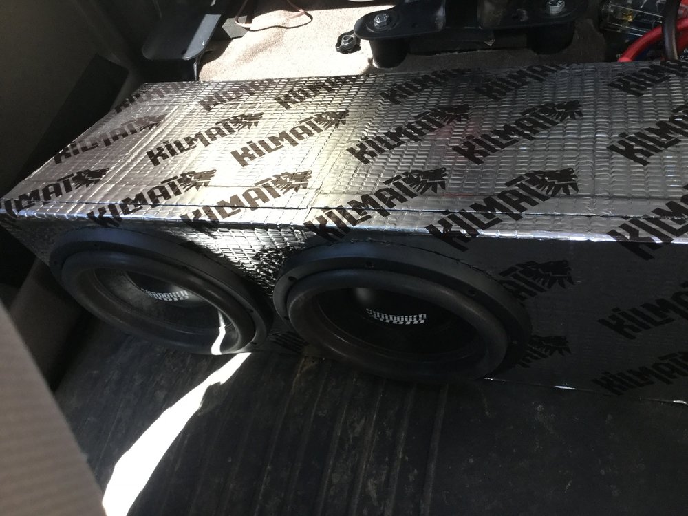

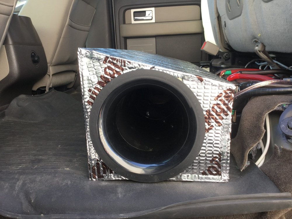

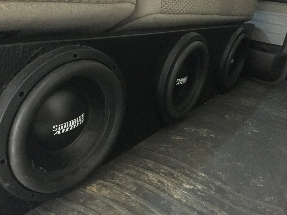

I’ve done 3 Sundown SA 10’s sealed and 2 ported both sounded great the sealed box was more punchy and I liked it better.
