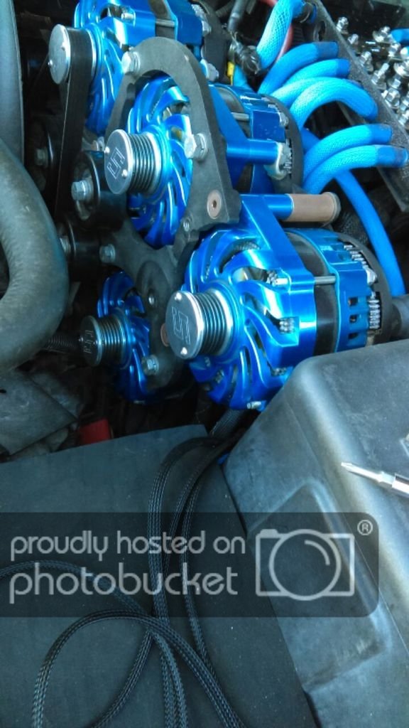

Ran quads on our 5.3 for 4 years. It took some "adjusting" and such, pulley size, placement changes and such. Took the bracket and milled some places where the bolts hung out past the bracket,.... some odds and ends, but, it ran tits, just fine. We had it where we could swap belts in about 1 minute. So, driving 18 hours to world finals or outta state, we would run a belt, with one alt, get to the show, and then put the belt on to spin all 4. Worked fucking great.
We made a LOT of heat. Demoing for hours on end, we where going to cut loovers in the hood and shit, but, never did. Never had any real big issues. One issue like i said, was the bracket. The lower bolt,  on the driver side, would stick out past the bracket, and if the belt slacked at all, say, under a heavy load, it would catch that fastener, and snap it. We took it all off, i brought the bracket into work, and milled the hole, to accept a pan head/flat head socket head cap screw. That went away just like that, and that was the end of our large issues. Then, we just beat the living shit outta the SINGERS for years. This is before the bracket mod. See that one bolt? The belt, rode just over that bolt. I milled the bracket to take a flat head. Done.

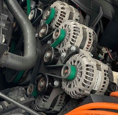

The bracket im running is the best in the industry right now i believe. Dan Blughost made it hes local to me. Many brackets i see have poor belt wrap on the bottom alternator. this bracket has an idler there and gives you good wrap on all alternators.
Jonathon Patrick at CES reccomended a 270 in the stock location instead of a 370, i guess because the 270 can run a stock pulley size instead of the smaller pulley. He stated with the smaller pulley at stock location the belt wrap is not as good.
