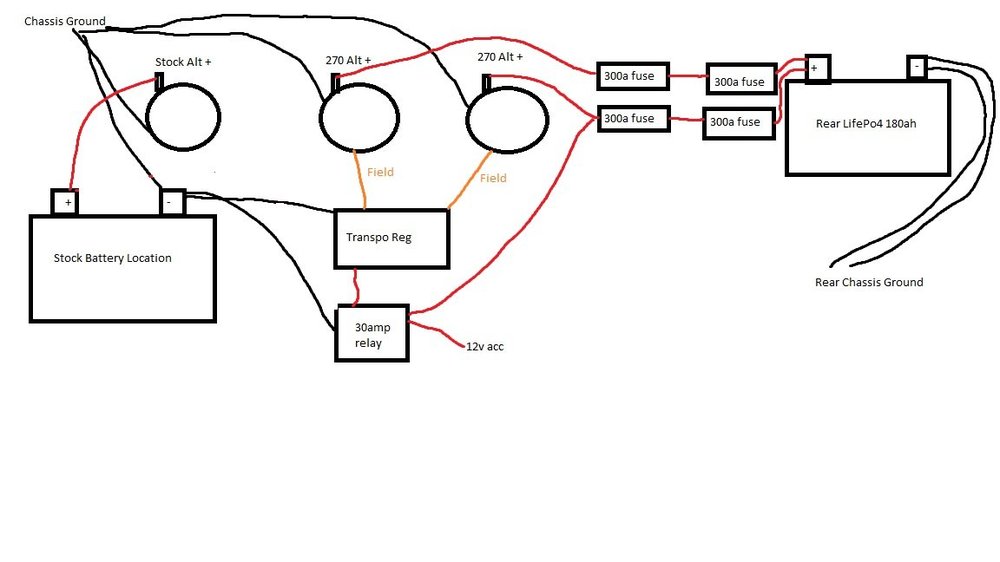

dthomas Posted June 11, 2019 Author Report Posted June 11, 2019 Ok, no laughing, not good at making up diagrams, but this should show everything.

dthomas Posted June 12, 2019 Author Report Posted June 12, 2019 Ok so I think I may have found the problem. I thought I had the +12v for the transpo coming from the audio side, but I had it going to the stock side. I am guessing the transpo regulator reads the +12v to see what the output voltage of the alternator is. So maybe the transpo was pulling alot of current trying to get the alts to make more voltage, but not seeing it since it was powered from the stock alt? Does this make any sense? Not sure if this is how they work, but moving the +12v for the transpo to the 2 270's seems to have fixed it.
Karkov Posted June 15, 2019 Report Posted June 15, 2019 No one is laughing mate. Why does it go from one fuse right into another fuse? Maybe I'm reading it wrong. It shouldn't matter but maybe ground the relay and transpo to an actual ground and not the stock battery negative? If it was me I would keep EVERYTHING, except chassis ground of course, separate, no exceptions. Period. Transpo's need to be near the alts? If so, and you have no stereo battery/reserve up there, can you feed them positive by adding a lug to the fuse holder and use the stereo alts positive? 2007 Chevy Tahoe (SOLD) 12 ~ FI Audio X series 10" w/BP option 2 ~ DC Audio 5.0K @0.67 3 ~ DC Audio 5.0K @1.0 2 ~ PPI 3 way sets (not installed yet) 1 ~ RF T400-4, 1 ~ RF T600-2, 1 ~ RF T600-4 4 ~ CT Sounds 5.25" Strato comps (rear fill only) 1 ~ XS Power D4800 1 ~ XS Power D3400 8 ~ XS Power XP3000 160 stock alt, Mechman 370 Elite, 185 DC Power 320+ Sq. Ft. Sound Deadener Pioneer AVH-X5500BHS Youtube: https://www.youtube.com/user/knfjdkghjudfhsgkjdhf/videos?sort=dd&view=0&shelf_id=0
