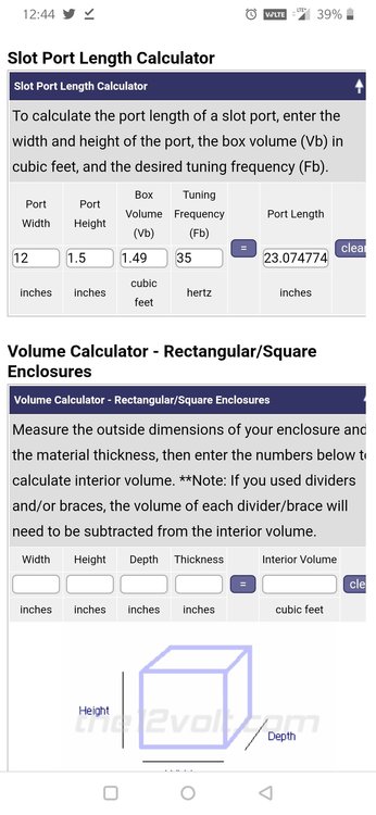

Cbillings1985 Posted October 14, 2019 Author Report Posted October 14, 2019 Trying to crunch numbers on the box I have designed as far as dims and it comes to 1.6cf minus the sub 1.49. I want to tune it at 35hz. I have read SA10 need 18" of port area. My trouble is trying to find the gross volume for the box if port area is 12x1.5 how long does it need to be to be at 35hz? Without knowing the port volume I cannot find the vb to enter into this calculator. https://www.the12volt.com/caraudio/boxcalcs.asp If I can put an SA10 in this size box rather than an E10 I will.
Cbillings1985 Posted October 14, 2019 Author Report Posted October 14, 2019 I'm hoping that the vb is gross volume minus sub volume before port volume is subtracted because I cannot know the volume of the port until I know it's length. If the port only needs to be 23.074 that's completely doable
