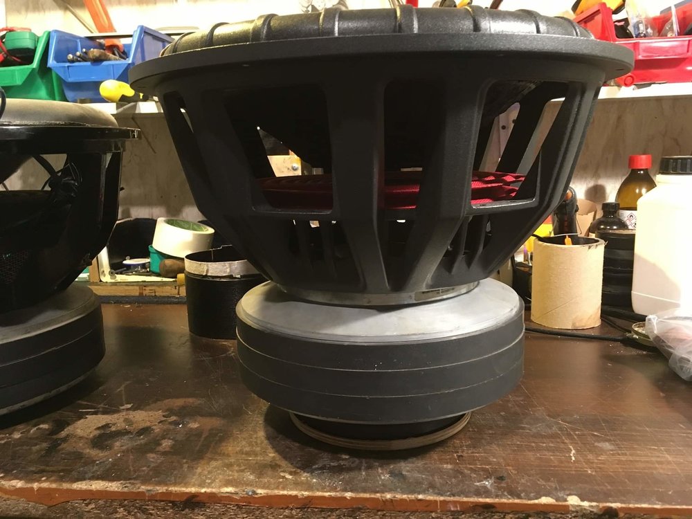

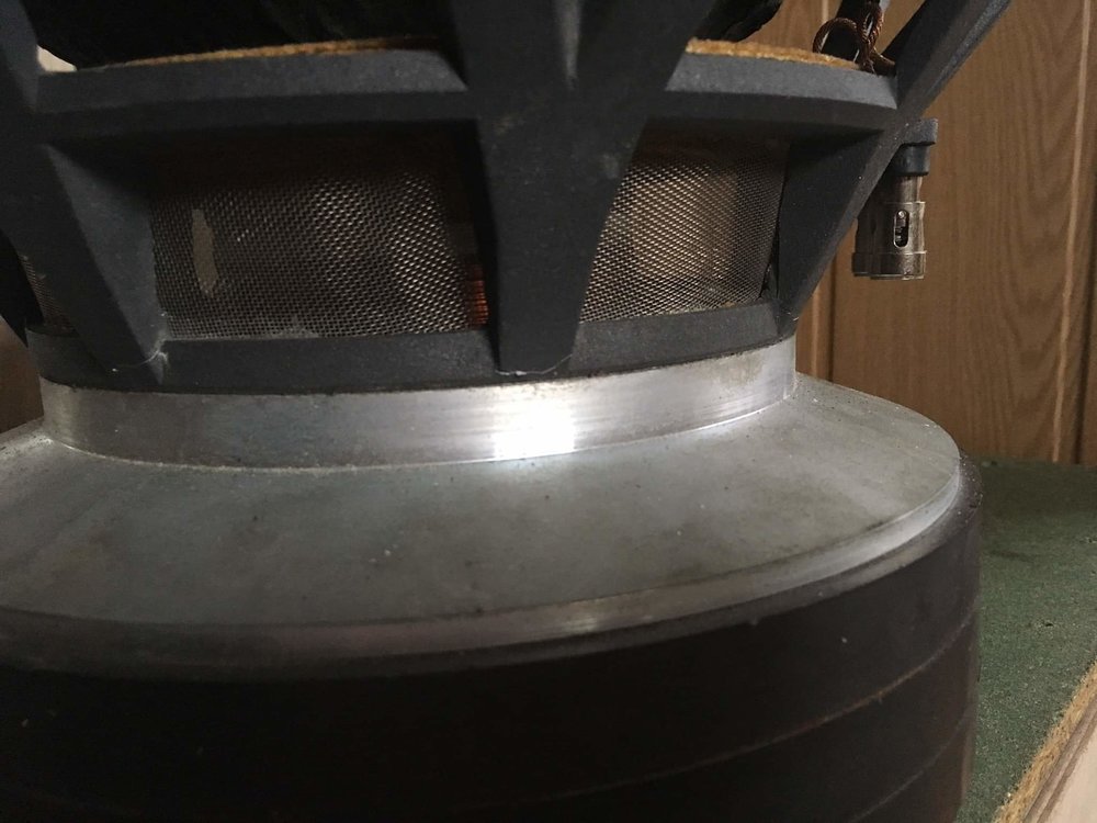

Splecc Posted October 27, 2019 Author Report Posted October 27, 2019 So... coil is still all good, what failed during playing, was the basket itself.
mfdoom7 Posted October 27, 2019 Report Posted October 27, 2019 9 hours ago, Splecc said: So... coil is still all good, what failed during playing, was the basket itself. lol basket cracked ? how is that even possible
AaronT Posted October 27, 2019 Report Posted October 27, 2019 It is 20 years old And that is a giant motor This is why motors need bracing
