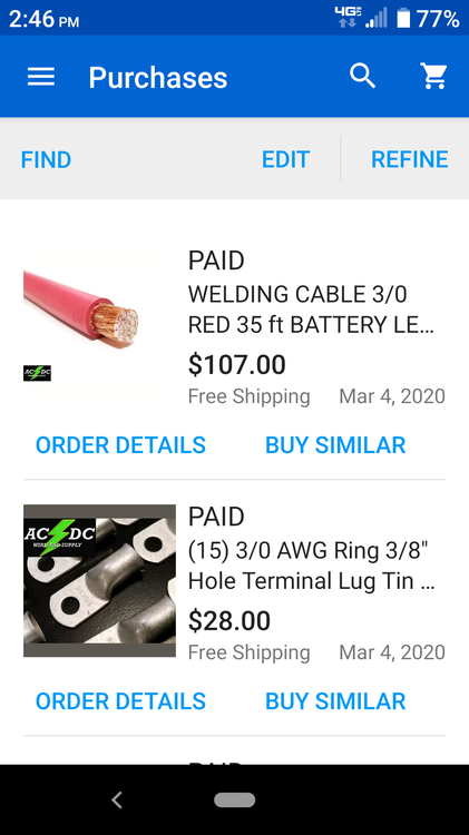

Wire and terminals on the way finally.  Went 3/0 welding wire, that's equivalent of 2/0 car audio isn't it?
4/0 welding would be car audio 2/0 equivalent
So basically I have 1.5/0 lol...2/0 welding will carry 450 amp so I'm sure 3/0 is close to that and I'll be running a second run as soon as I can afford it. Should be plenty to support the MD 8000 and 1 or 2 smaller amps for mids and highs
You basically have sky High 1/0 with with coarser strands that's going to be nowhere near as flexible it's going to put a little more on all your fittings you better get yourself a hydraulic crimper
Solder works.
just hit your terminals up upside down fill them with solder than while it's still hot jam your cable into it
Solder works.
I have a hammer crimp and a bolt cutters style crimper , but since it's ofc I'll solder probably. I'm pretty good at soldering, since its all copper it'll be no problem, unlike the cca shit. Coarser strands won't be an issue since I'll be running it along my frame rail , already have some double wire hold-downs. Won't be any hard bends since it'll only have to really bend once from frame then through into the cab.i have some screw in plastic things that hold wire and keep from chaffing on metal( forgot name of em but have a bag of em from a trailer I built for my old job site arc welder). I'll be running a second run soon, so should be solid wire for a LONG time. Wire is super resistant to chemicals and oils.
