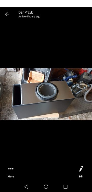

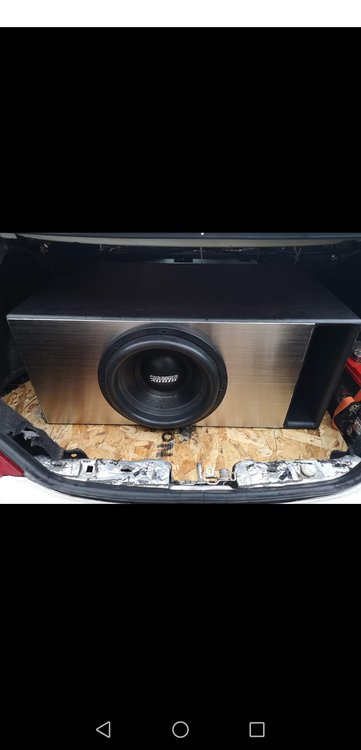

I will add pics of box and sub soon.

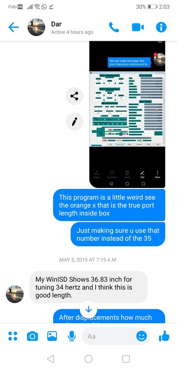

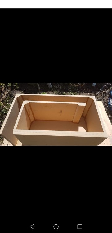

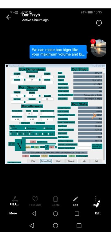

so one thing i noticed, the guy who built my box, i sent him a screen shot from torres and told him to follow the physical port length to calculate the actual length of the wood pieces. But he ended up using Winisd and got a different result for his port length. I will add screen shots of that convo. i guess torres calculates the port length differently than other box building calculators?
this box went inside a genesis coupe which is the worst car ive ever had to work with in terms of car audio. So hard to get bass into the cabin.. thats a whole other thread lol

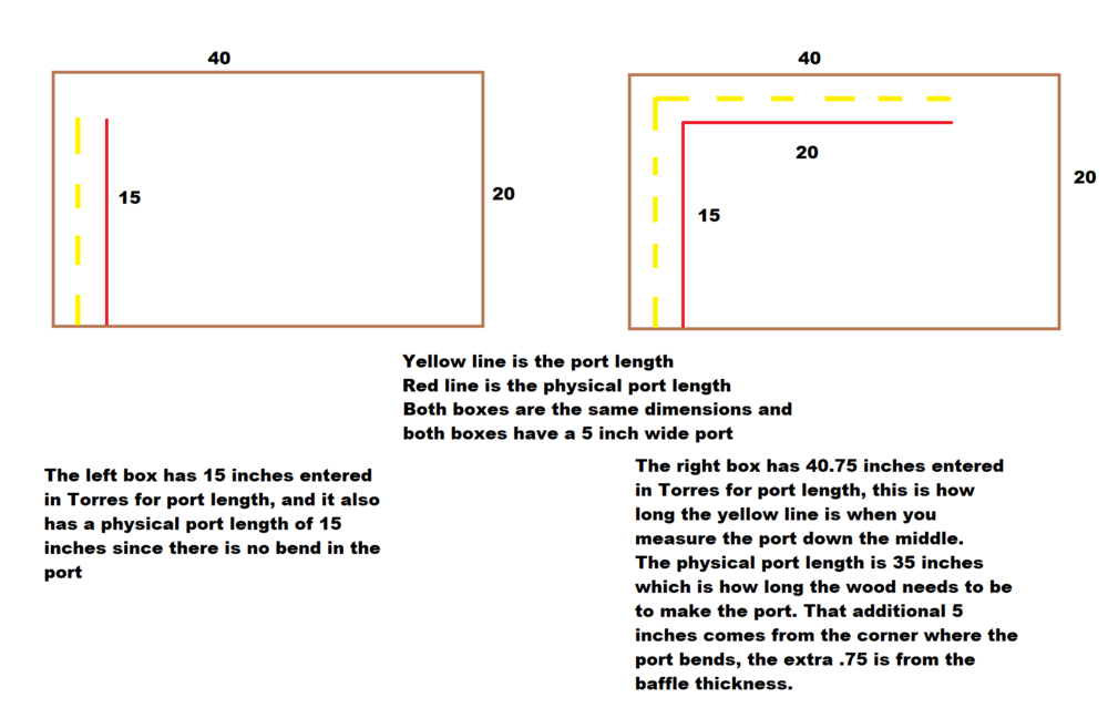

So the physical port length on torres is the actual length of the wood needed to make the port.
The port length that you enter in the box is the actual length of the port when you measure down the middle of the port.
The physical port length will always be shorter than the port length entered into the box, unless the port does not bend because both would be equal length.
