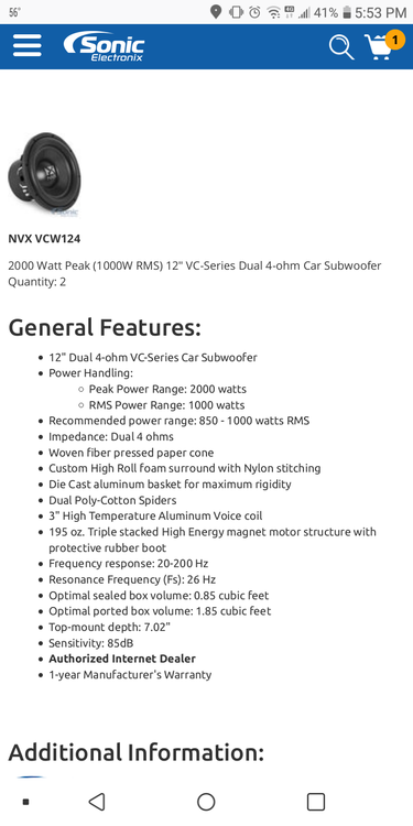

MannyFresh Posted April 10, 2020 Report Posted April 10, 2020 I need some recommendations on choosing the right amp for theae two subs!

1point21gigawatts Posted April 10, 2020 Report Posted April 10, 2020 That’s a good amp and it wouldn’t cost that much and after box rise and voltage drop, it would be perfect for them subs. Meaning don’t let the fact that it’s 2500 rms at 1 ohm worry you because your subs won’t ever see that much rms. Google box rise and you probably already know about voltage drop. All that makes the subs see less rms. “How can we help you?” “And don’t forget to tell them that the customer isn’t always right.”
