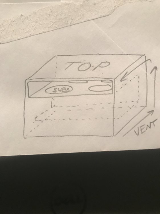

Gunzo Zabuza Posted April 18, 2020 Report Posted April 18, 2020 So it all started when I thought to myself,” if two subs are this good, four would be amazing!” Problem is, room is a little tight as it is, but I figured that I could fit four if I wrap my port over the top of the subs. As in 4 subs firing up and the port over the top of the subs. It’s a bit more extreme design than the old Jl ho boxes, where the channeled the port over the top of the cone. Are these good ideas? What kind of effect does it have on the sound when you do somthing like this? Am I an idiot for believing this is a good idea? Any insight would be helpful, or even just your thoughts, comments or concerns.

1point21gigawatts Posted April 19, 2020 Report Posted April 19, 2020 14 hours ago, Gunzo Zabuza said: So it all started when I thought to myself,” if two subs are this good, four would be amazing!” Problem is, room is a little tight as it is, but I figured that I could fit four if I wrap my port over the top of the subs. As in 4 subs firing up and the port over the top of the subs. It’s a bit more extreme design than the old Jl ho boxes, where the channeled the port over the top of the cone. Are these good ideas? What kind of effect does it have on the sound when you do somthing like this? Am I an idiot for believing this is a good idea? Any insight would be helpful, or even just your thoughts, comments or concerns. So you’re talking about the port on the same side as the subs? Either way. You will be good putting the port anywhere as long as it isn’t behind the subwoofers, like subs front and port back. “How can we help you?” “And don’t forget to tell them that the customer isn’t always right.”
Gunzo Zabuza Posted April 19, 2020 Author Report Posted April 19, 2020 This is what my mind thinks of as a good idea, it just wondering if I was dumb for thinking that, or if there is somthing I’m missing. If this has been tryed before and was total crap. The closest concept to be found is the old school jl boxes, but I don’t think they make em anymore.
AaronT Posted April 19, 2020 Report Posted April 19, 2020 27 minutes ago, Gunzo Zabuza said: This is what my mind thinks of as a good idea, it just wondering if I was dumb for thinking that, or if there is somthing I’m missing. If this has been tryed before and was total crap. The closest concept to be found is the old school jl boxes, but I don’t think they make em anymore. The ho wedges are chamber coupled slot Port designs The reason they did it like that was to get all the port area needed while keeping box a normal size.
1point21gigawatts Posted April 19, 2020 Report Posted April 19, 2020 51 minutes ago, Gunzo Zabuza said: This is what my mind thinks of as a good idea, it just wondering if I was dumb for thinking that, or if there is somthing I’m missing. If this has been tryed before and was total crap. The closest concept to be found is the old school jl boxes, but I don’t think they make em anymore. That would conflict air flow. Just take the top portion off and have the port in the same sense coming out the top or coming out the back. “How can we help you?” “And don’t forget to tell them that the customer isn’t always right.”
Gunzo Zabuza Posted April 21, 2020 Author Report Posted April 21, 2020 If this is taking up my back seat aria, should I face port forward?
1point21gigawatts Posted April 21, 2020 Report Posted April 21, 2020 Face port towards something it can bounce of. If the port is 3” wide then put it with the port facing the rear hatch 3” away from the rear hatch. Subs up, port back. “How can we help you?” “And don’t forget to tell them that the customer isn’t always right.”
