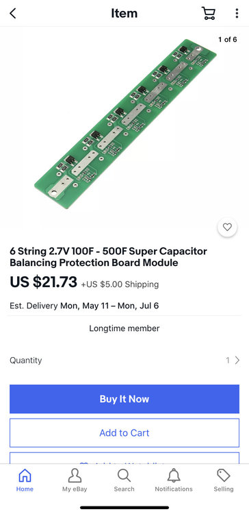

1point21gigawatts Posted April 21, 2020 Report Posted April 21, 2020 12 minutes ago, Joshdashef said: You buy those in bulk for a discount or just over the years bought more and more banks to add on? Looks sick No, I’m not talking about bracing. I’m talking about balancing board circuits/modules. Look at the pic. “How can we help you?” “And don’t forget to tell them that the customer isn’t always right.”
Joshdashef Posted April 21, 2020 Report Posted April 21, 2020 1 minute ago, 1.21gigawatts said: Where do balancing boards come into play? Oh so those just help to keep the individual cells at the same voltage. Same thing in lithium banks like yinlongs. Really don't need them for our applications. Balancing boards just prevent damage to cells from over charging one past its max voltage. They come in passive and active varieties but will connect each battery up to a main balancing board like this: In this video he is talking about LTO lithium cells but its the same thing if you were to use one for capacitors, but it isn't necessary. Some people don't run balance boards on their lithium either but break down their banks to let them passively balance in parallel for a day. SMD Tool Map (2024): https://www.stevemeadedesigns.com/board/topic/226545-smd-tool-map-2024/ Great Box Bracing Examples: https://www.stevemeadedesigns.com/board/topic/202148-best-way-to-brace-a-box/?do=findComment&comment=3055002

1point21gigawatts Posted April 21, 2020 Report Posted April 21, 2020 21 minutes ago, Joshdashef said: Oh so those just help to keep the individual cells at the same voltage. Same thing in lithium banks like yinlongs. Really don't need them for our applications. Balancing boards just prevent damage to cells from over charging one past its max voltage. They come in passive and active varieties but will connect each battery up to a main balancing board like this: In this video he is talking about LTO lithium cells but its the same thing if you were to use one for capacitors, but it isn't necessary. Some people don't run balance boards on their lithium either but break down their banks to let them passively balance in parallel for a day. Thank you for the insight dude! Is it possible to harm a 14.8 peak volt alternator if your staying over 15 volts, like 15.5 volts for long periods of time? Because I have another idea for a battery build too and I’ve always wondered if it was possible to overload an alternator. “How can we help you?” “And don’t forget to tell them that the customer isn’t always right.”
1point21gigawatts Posted April 21, 2020 Report Posted April 21, 2020 35 minutes ago, Joshdashef said: Oh so those just help to keep the individual cells at the same voltage. Same thing in lithium banks like yinlongs. Really don't need them for our applications. Balancing boards just prevent damage to cells from over charging one past its max voltage. They come in passive and active varieties but will connect each battery up to a main balancing board like this: In this video he is talking about LTO lithium cells but its the same thing if you were to use one for capacitors, but it isn't necessary. Some people don't run balance boards on their lithium either but break down their banks to let them passively balance in parallel for a day. Then why does XS put balancing boards in their superbanks (the ones that look like agm batteries) if they are unneeded? I’m a noob to caps because back in the day when the 1 farad and 5 farad caps were popular I heard they could mess something up and then I heard they were pointless, so I never studied nor used caps. Then I found out they are good as long as you have like 500 farads or more. That’s when I started to peak interest. That wasn’t long ago. Then I said fugh it and im just gonna stick with my agm’s instead of learning and now I want to learn after so many years lol! “How can we help you?” “And don’t forget to tell them that the customer isn’t always right.”

Joshdashef Posted April 21, 2020 Report Posted April 21, 2020 45 minutes ago, 1.21gigawatts said: Then why does XS put balancing boards in their superbanks (the ones that look like agm batteries) if they are unneeded? I’m a noob to caps because back in the day when the 1 farad and 5 farad caps were popular I heard they could mess something up and then I heard they were pointless, so I never studied nor used caps. Then I found out they are good as long as you have like 500 farads or more. That’s when I started to peak interest. That wasn’t long ago. Then I said fugh it and im just gonna stick with my agm’s instead of learning and now I want to learn after so many years lol! Not sure why they do that, but I know XS power is a well known company for safe products. I wouldn't doubt they went the extra step of adding one for being extra careful. But you can see with kalilac's build he isn't running one for quite some time with no trouble. 50 minutes ago, 1.21gigawatts said: Thank you for the insight dude! Is it possible to harm a 14.8 peak volt alternator if your staying over 15 volts, like 15.5 volts for long periods of time? Because I have another idea for a battery build too and I’ve always wondered if it was possible to overload an alternator. Since the alternator is the source or generator then I would assume it could output higher than stock but might have a mechanical limit before it overheats, so I would contact your alternators manufacturer. Sometimes you can change to an externally regulated alternator to alter the voltage it will charge at, some companies will even rebuild yours to accept one. However, be careful how far you extend it if it will be powering your stock electrical as well, car components were not designed for over 15 volts. Run two alts if you want to go for a 12v and a 16v side (only advantage is you get more out of your amp if it can accept 16v like a DC 5k I think). I've seen guys run mids and highs off 12v side and 16v side is nothing but monoblocks, pretty effective way to deal with inevitable voltage drop but expensive SMD Tool Map (2024): https://www.stevemeadedesigns.com/board/topic/226545-smd-tool-map-2024/ Great Box Bracing Examples: https://www.stevemeadedesigns.com/board/topic/202148-best-way-to-brace-a-box/?do=findComment&comment=3055002
