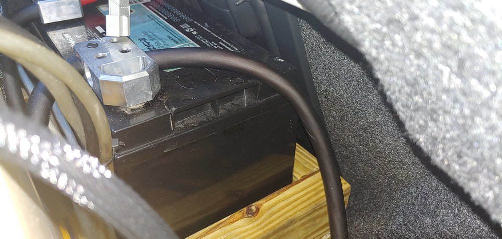

1point21gigawatts Posted April 27, 2020 Report Posted April 27, 2020 Check the resting voltage of the batteries and if any of them are below 12.6 volts then they need to be charged. Disconnect them and check them. Let me know what they read. You never let me know when I asked. That information will help a lot. Mainly I need to know the resting voltage of the rear battery. I’m thinking the rear battery is resting at around 11’ish volts. Let me know. “How can we help you?” “And don’t forget to tell them that the customer isn’t always right.”

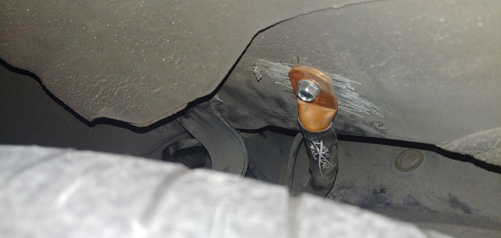

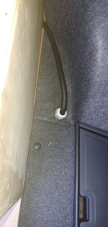

1point21gigawatts Posted April 27, 2020 Report Posted April 27, 2020 I spoke with the OP and his resting voltage on his rear battery is 12.82 but his ground wire is almost 10 feet. @AaronT we were both wrong lol! It’s because his ground wire is too long and might not be grounded hard enough, but definitely way too long. “How can we help you?” “And don’t forget to tell them that the customer isn’t always right.”
1point21gigawatts Posted April 27, 2020 Report Posted April 27, 2020 Clean the grounding point better and make the ground shorter, way shorter, like a foot to a foot and a half and it will be ok until the ofc wire comes. “How can we help you?” “And don’t forget to tell them that the customer isn’t always right.”
1point21gigawatts Posted April 27, 2020 Report Posted April 27, 2020 What’s behind that carpet? Metal or plastic? And what part of the car is that spot, like what location? “How can we help you?” “And don’t forget to tell them that the customer isn’t always right.”
