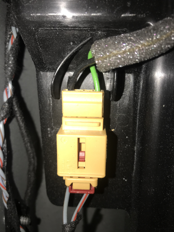

I'm trying to install an amp and subwoofer in my car. Currently I have a stock subwoofer that I would like to tap into and send to the amplifier. Here are the wirings for the stock subwoofer below:
The green wire is positive and the black wire is negative. I want to splice into those and send it to the amp shown below:

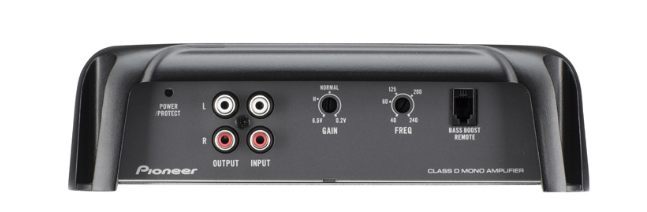

My question is that since there is only one positive and one negative wire would I just plug them into one of the RCA inputs such as the left (white)? Or would I get a splitter to input both instead.

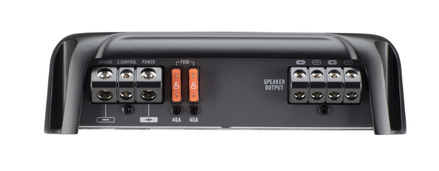

Here is the other side of the amplifier that will be leading into the subwoofer:
I would use one of the speaker outputs, positive and negative to the subwoofer.

What are you trying to accomplish? Power the factory subwoofer with the pioneer or just get signal to use the pioneer and a different subwoofer? If u want to use the factory sub wires to feed signal to the pioneer and run an aftermarket sub, you need a line output converter. Will have to use jumper wire to feed both inputs on the LOC or use one channel of LOC and a y adapter on the RCA output Sonu have 2 rca s to plug into amp. Most amps will work mono with jut the "left" RCA plugged in also.
