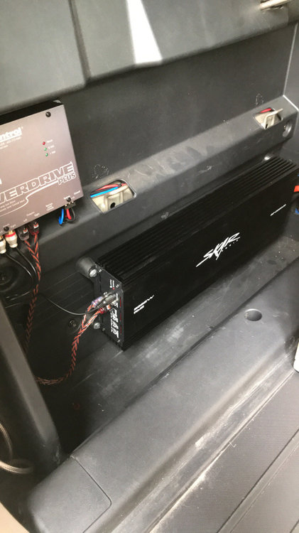

So I don’t know why but I was told to install a line driver. My deck has 2.5v sub preout,so I’m wondering why it was recommended. With the driver set to 5v my amp gain on my rp2000.1 is all the way down. Skar amps can only take 6v max.. If I remove the line driver and match the gain to the sub pre-out voltage wouldn’t it sound the same? Just trying to wrap my head around all of this, and eliminate the driver if needed.
Maybe the reason somebody installed a line driver is because the head unit is sending off a weak rca signal (even though it’s suppose to put out 2.5v, but doesn’t) and without the line driver you probably have to turn the gain all the way up and then are forced to go to the no no zone and turn the bass boost up a little before clipping is ever present because the rca signal is that minimal. That’s a reason somebody installs a line driver. I don’t think anybody would install a line drive for no reason. And the gain has nothing to do with output so why care if it is almost turned down all the way? All that matters is that there’s a good signal.
