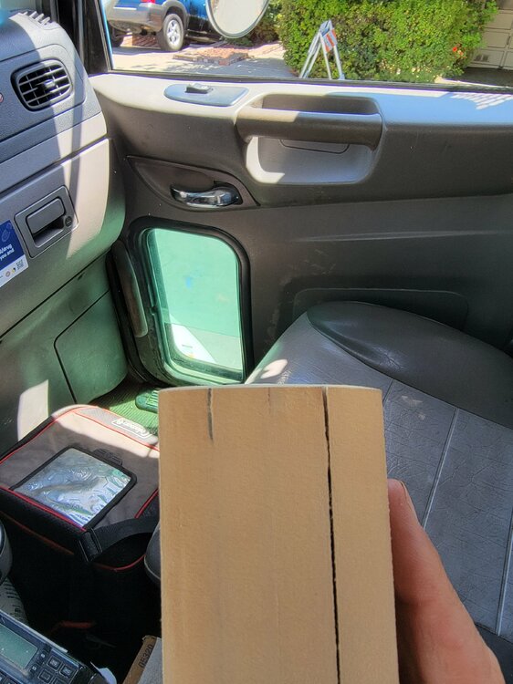

So, I couldn't wait until the weekend to work.... so I brought my sander and some sand paper to work with me to get some done at lunch.
This is the baffle for the tweeters. What do you guys think? Think it'll work? It's got a little roundness to the 4 edges and it's pissing me off, but what do you guys think? 20210831_125522.thumb.jpg.009f56b3d66a0aaa69f923e461b72db2.jpgman, that's annoying! Lol.
I don't think i told you guys my plan. So I'm going to use 2 of these to mount the tweeters and 8's (these are just the tweeters). Then the other 2, I'm going to use to cut rings out. So basically cut the middle out and have a nice 1/2" ring. I'm going to wrap the ring with a steel speaker grill. So you won't see the ring anymore, just the top and the edges will be speaker grill. Then, when I get a router, I'm going to cut a 1/2" channel, 1/8" deep for the speaker grill ring to sort of snap into. Then I'll drill a bunch of little magnets into the channel to grasp the speaker grill and hold it in place
Looks good if u don't like the rounding shave it off or just make it part of the design
I was trying to make all of them perfectly flat... but failed 🤣
It happens

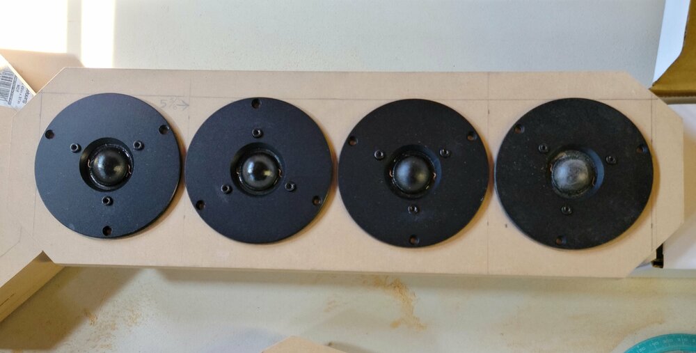

How does this look for the tweeters?
Looks good!  Are you going to pull felt over the MDF when you start the glass/body work on the door panels or lay in chop mat and go to town with bondo glass / body fililer?
I'm going the easy route and using felt, a short strand fiberglass concoction (it has kind of a chop mat in it already), then bondo. I want to find a way to wrap the 8's in vinyl, and paint the rest, but I don't know how to make the vinyl look like it's supposed to, like with a seam where it ends type deal. I don't know if I'm explaining what I mean very well.
Looks real good can't wait to see the finished product
