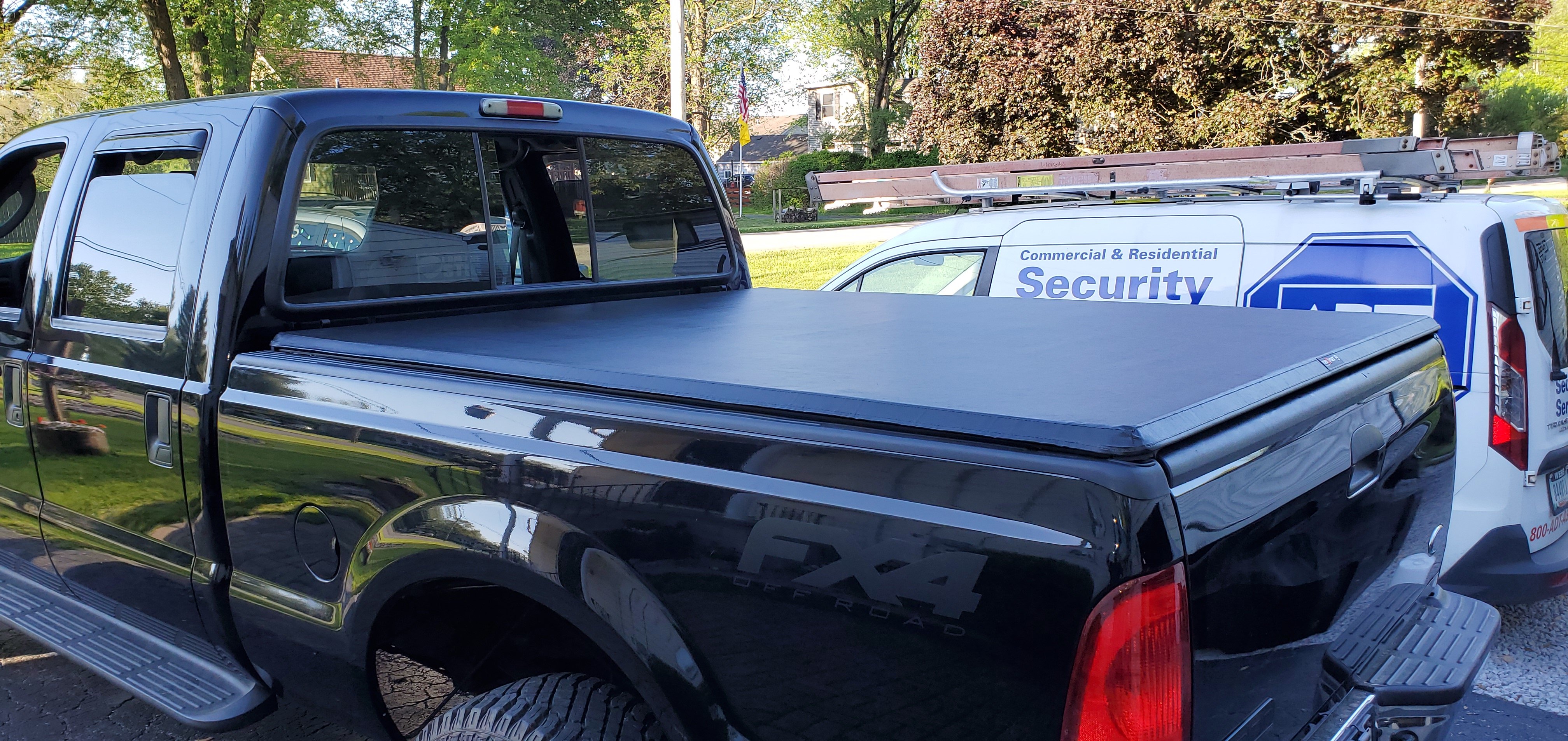

Very close to being done. But here it so far.

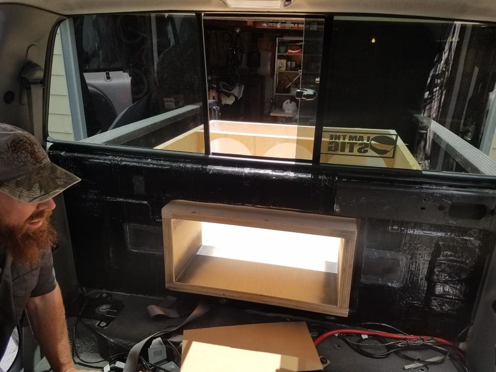

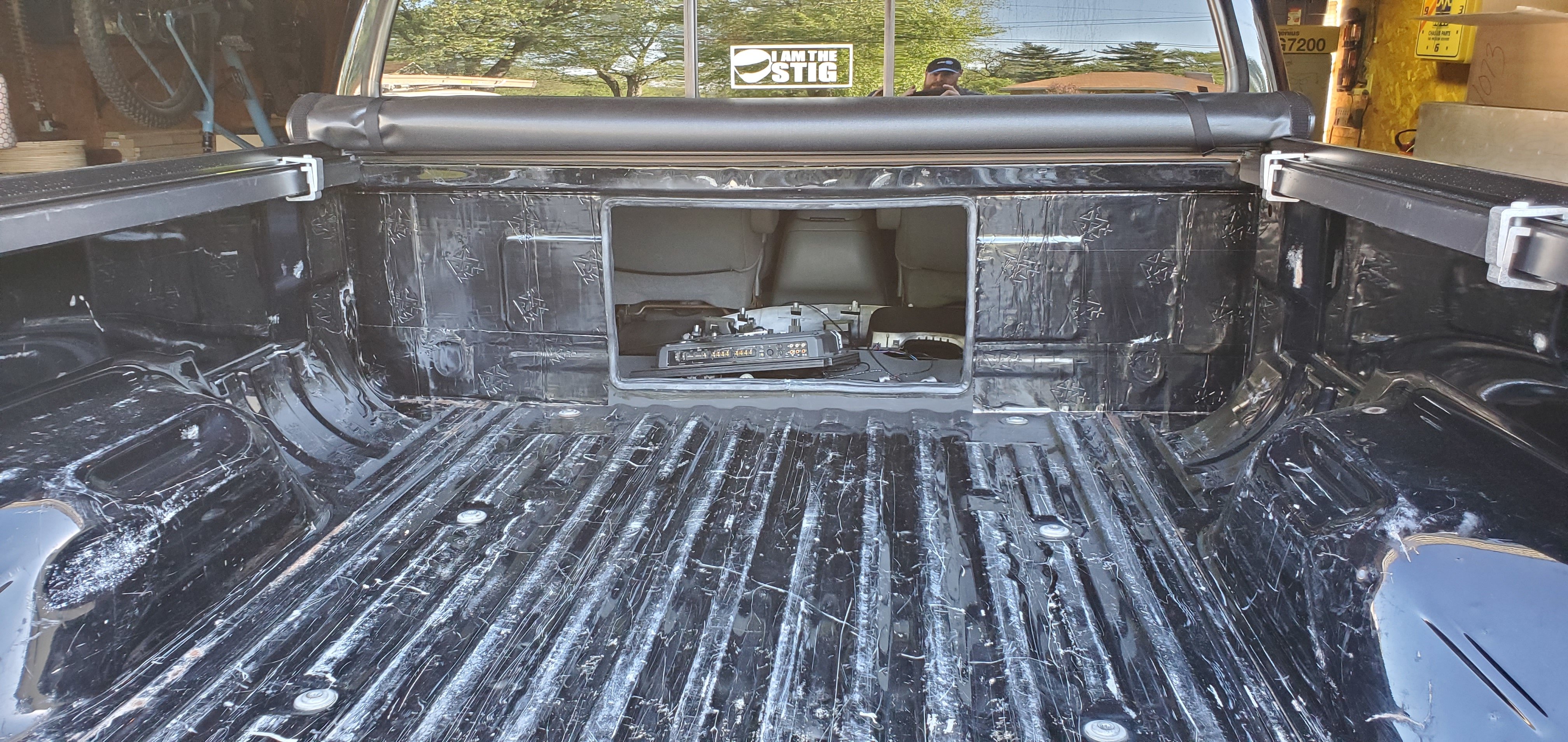

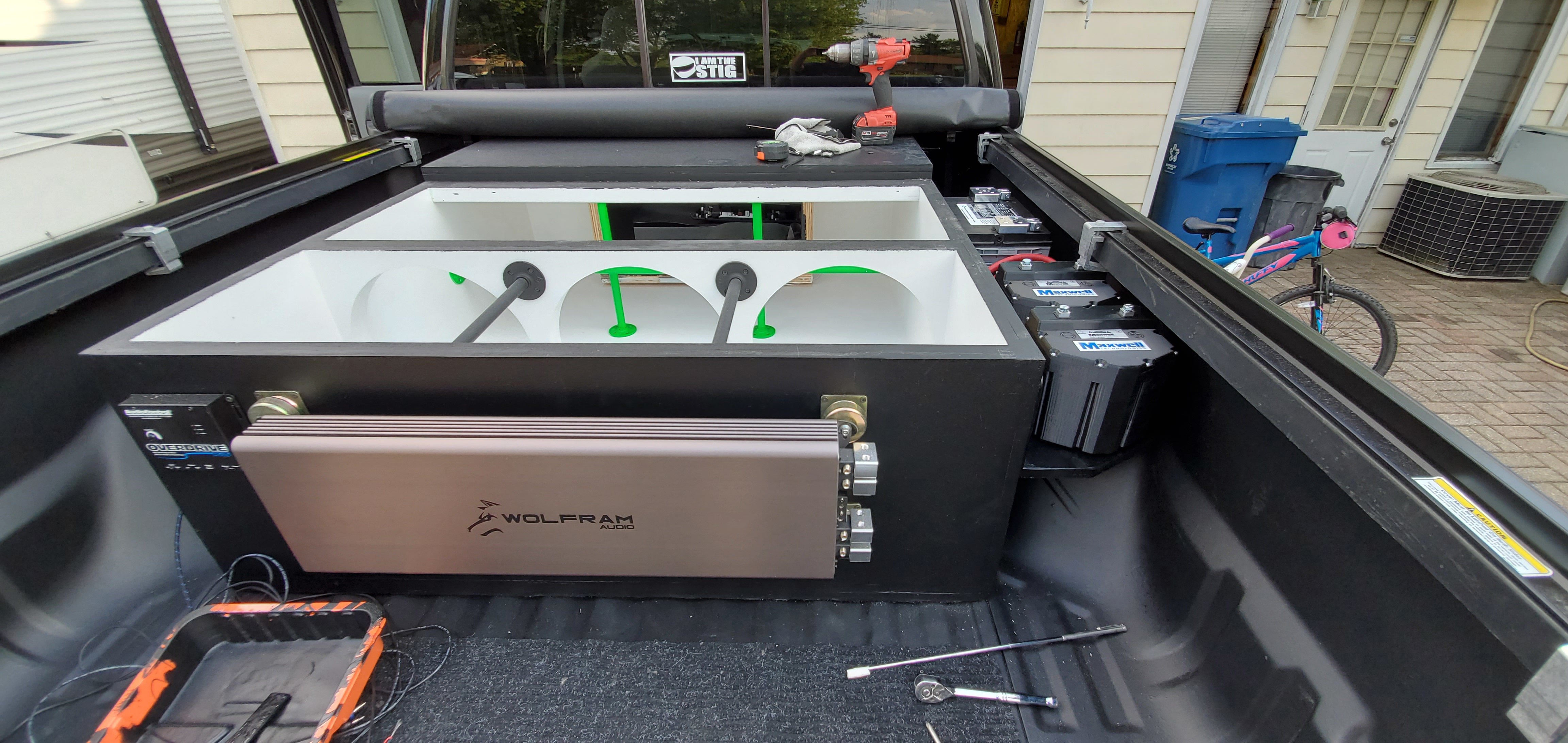

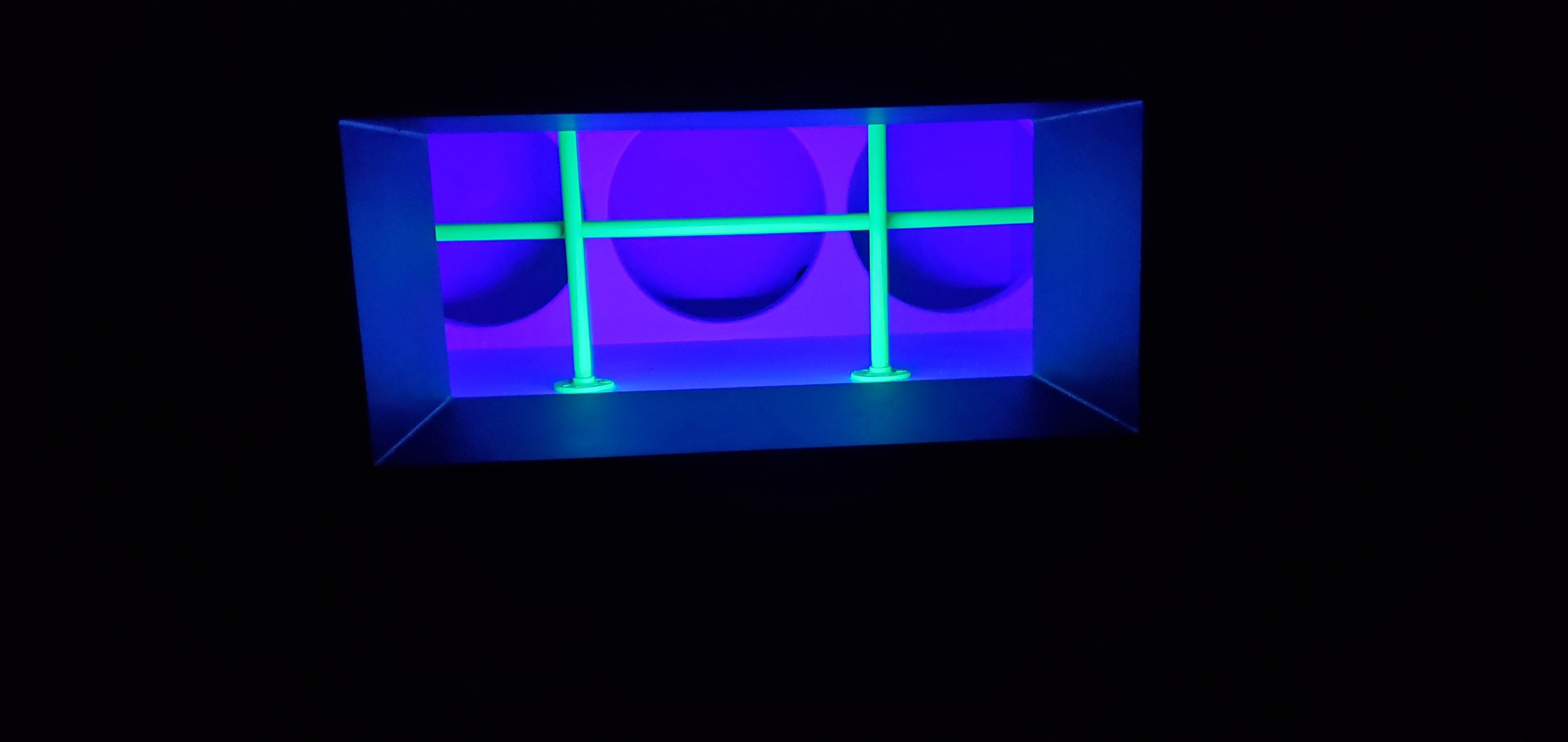

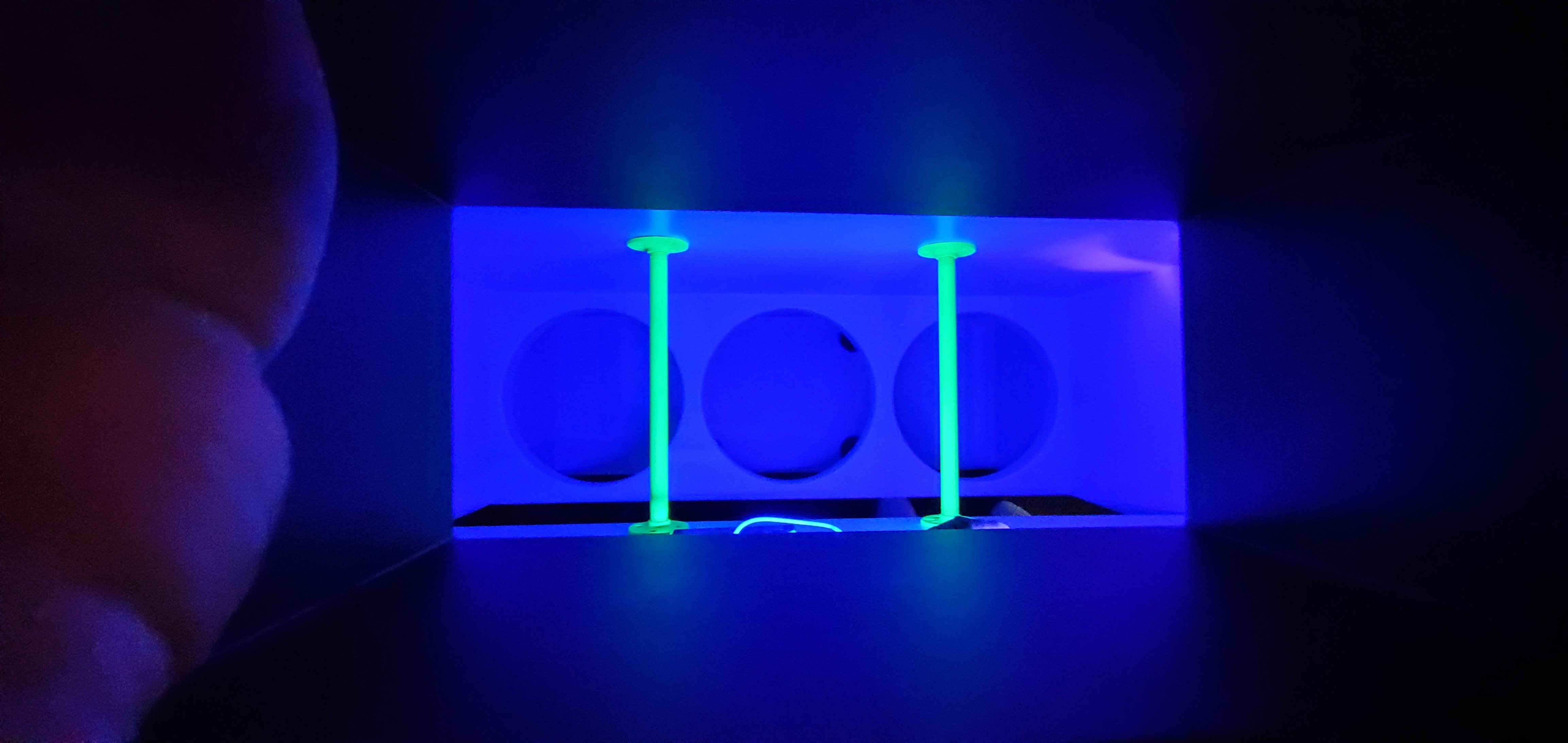

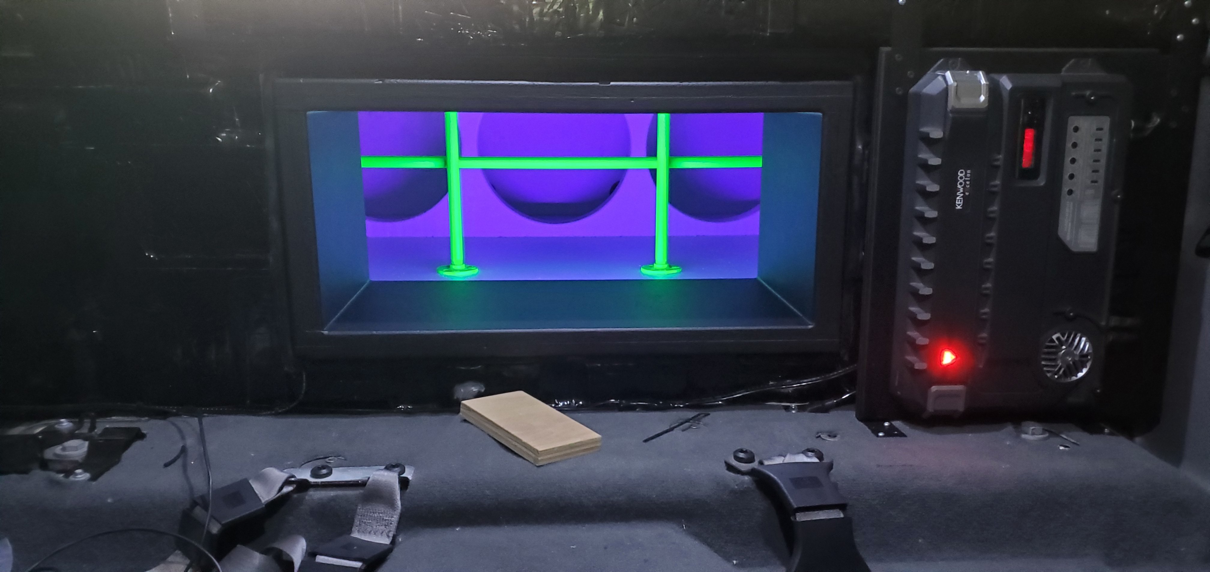

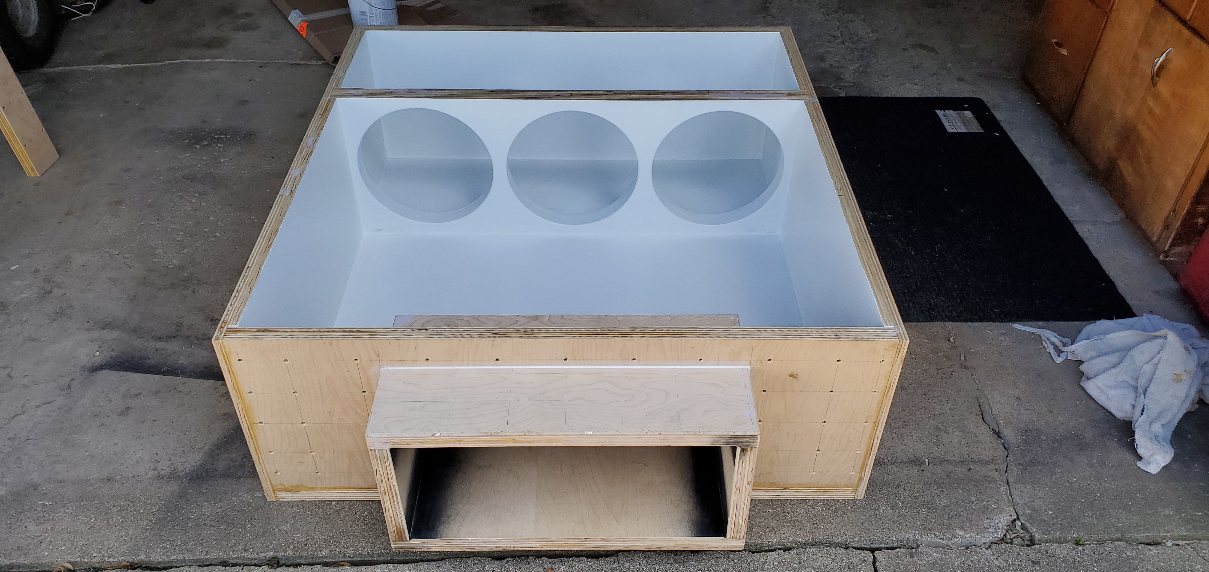

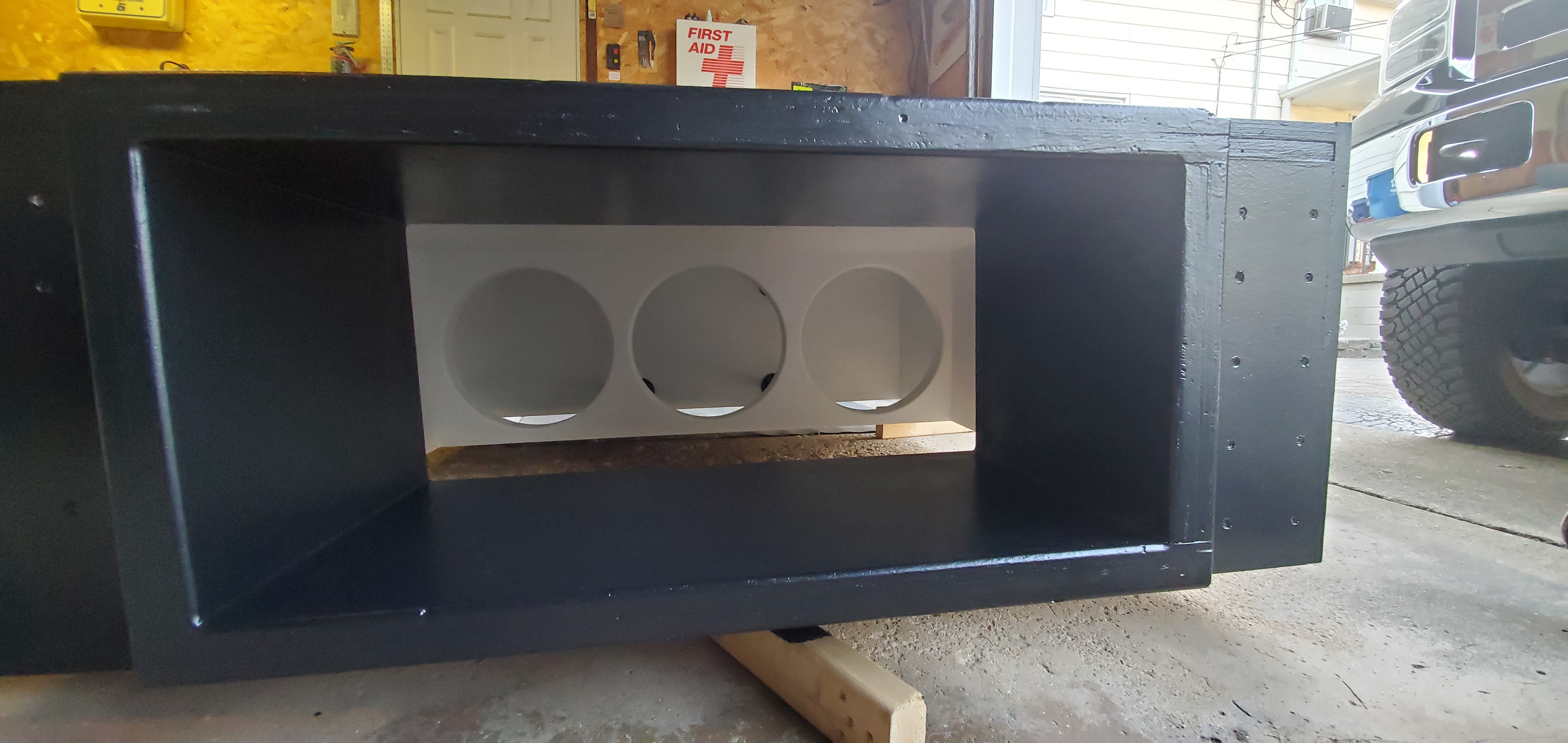

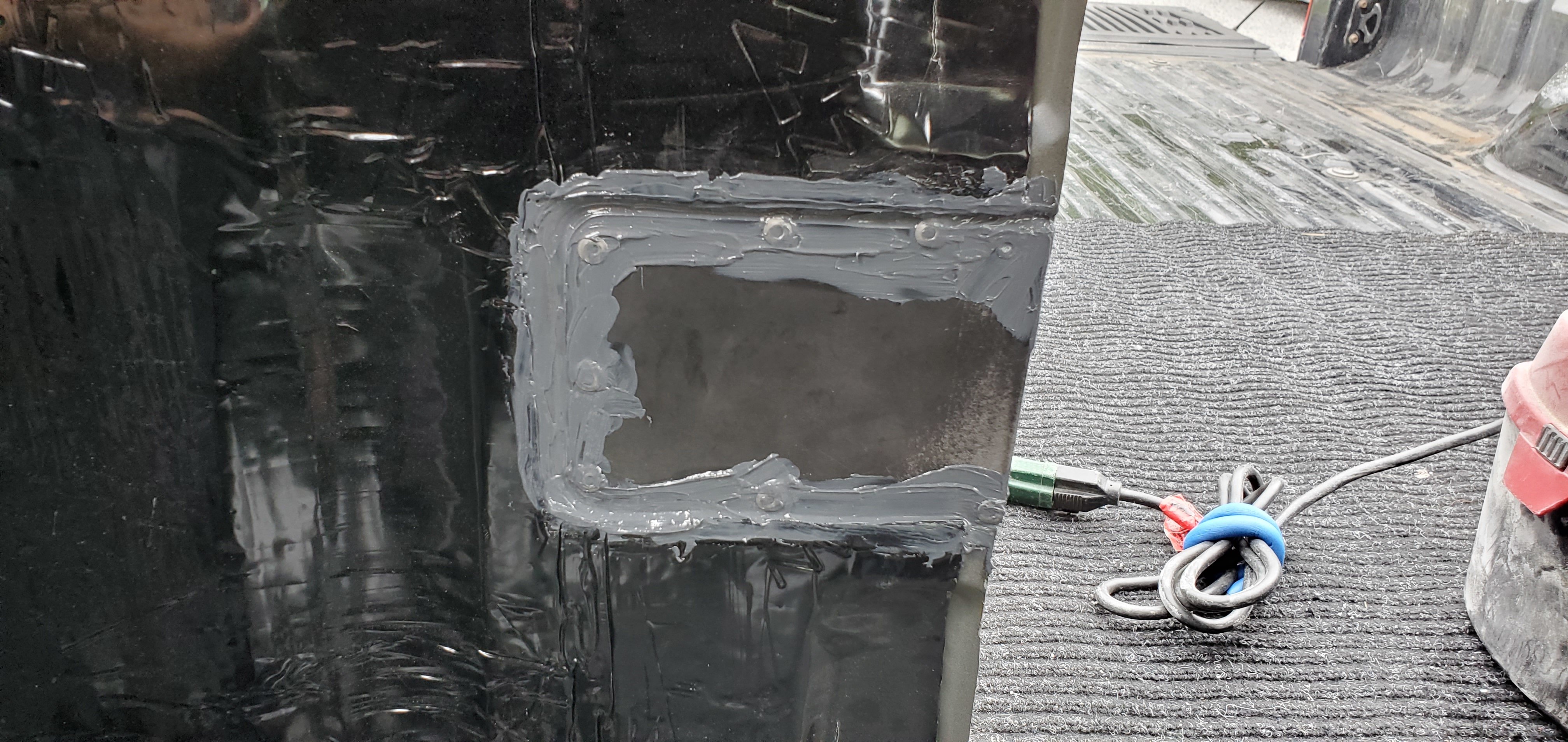

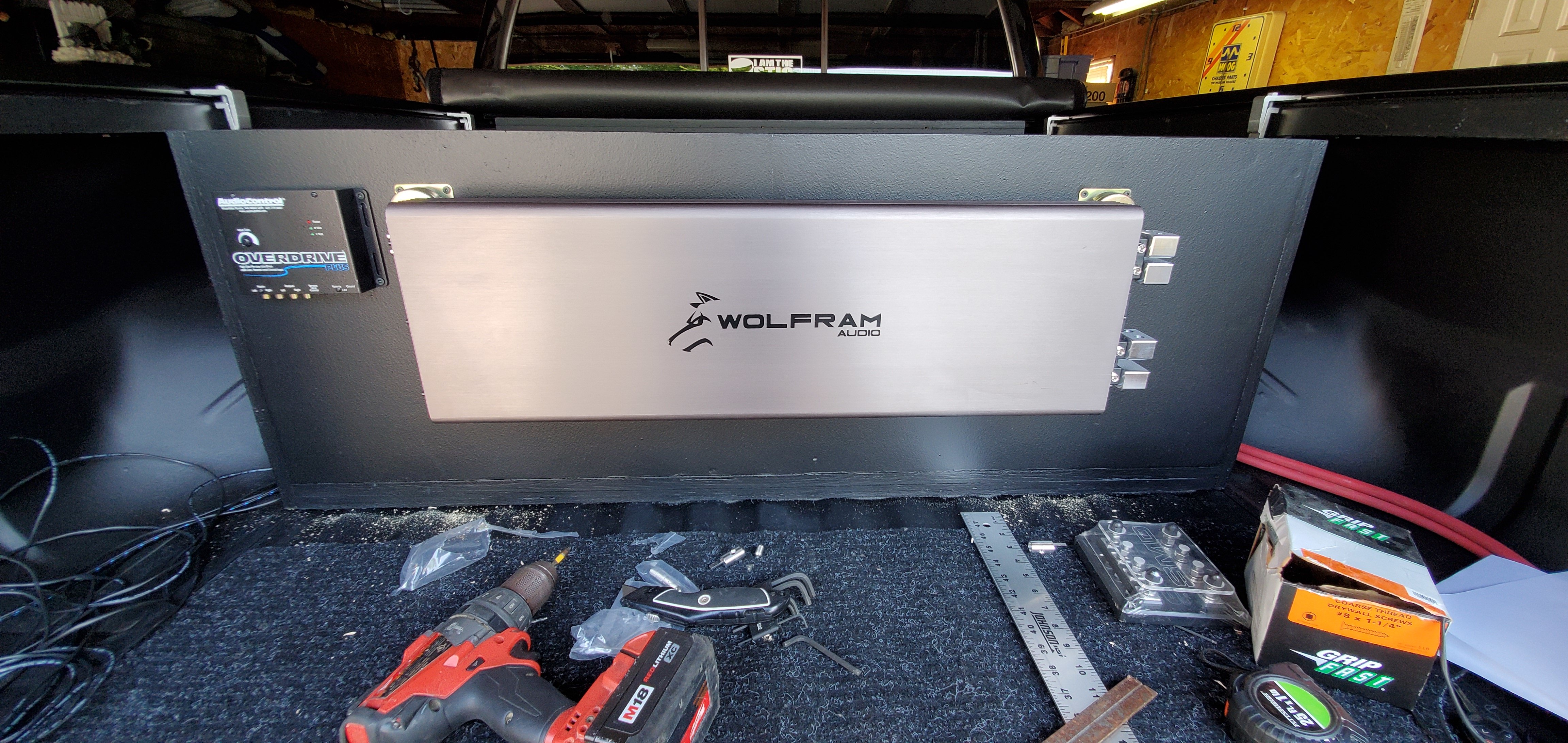

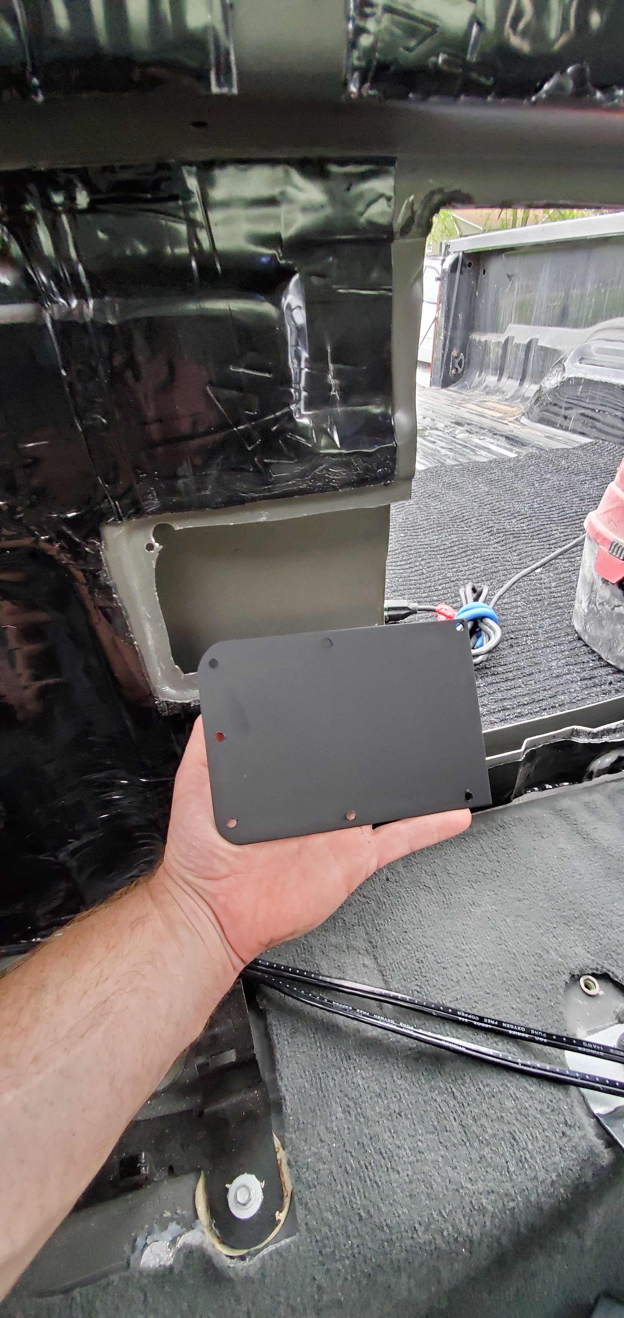

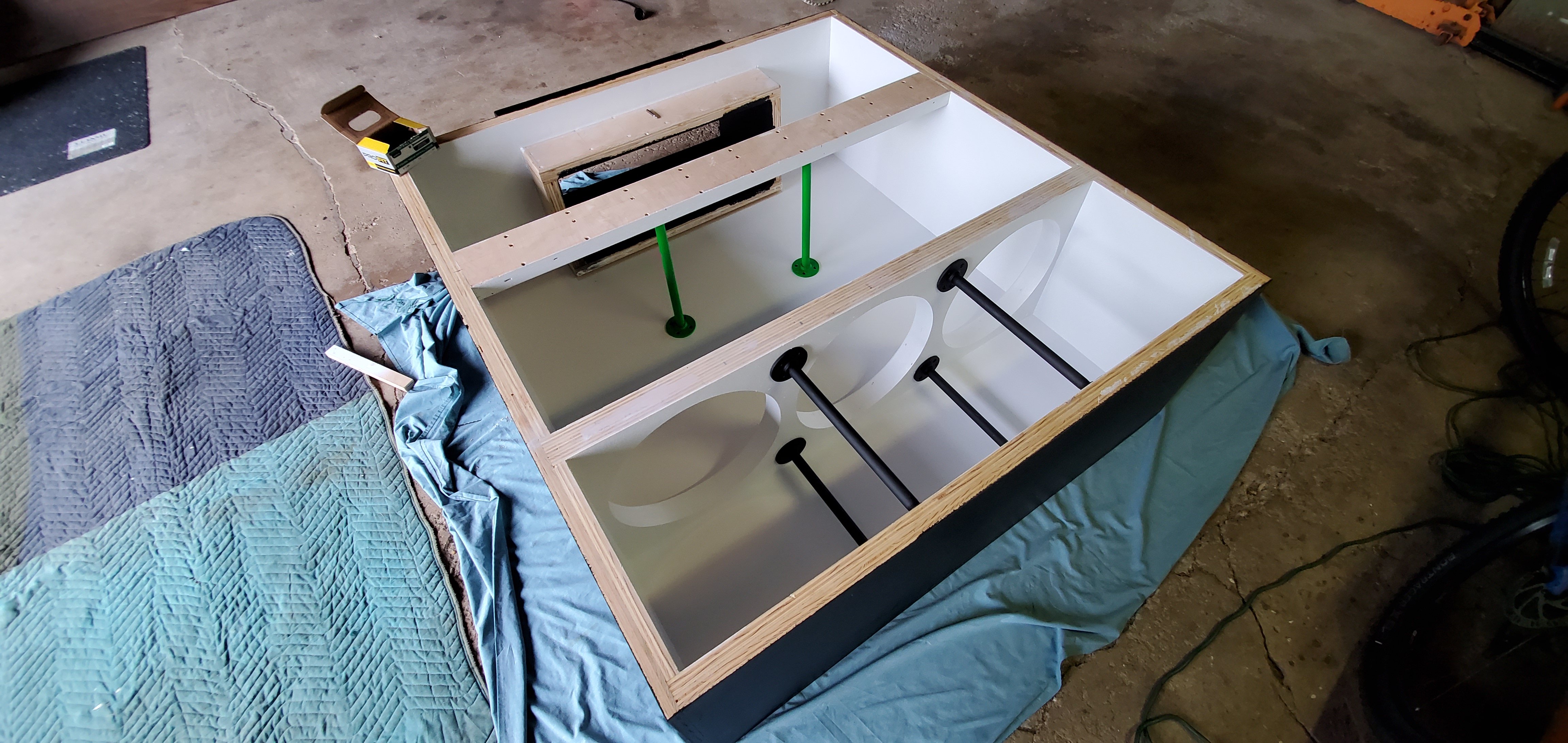

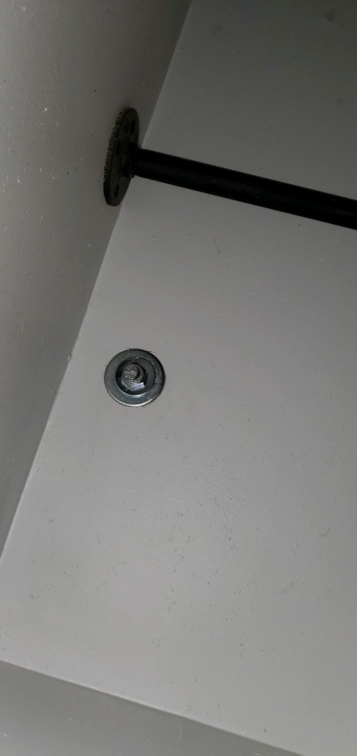

2005 Ford F250 super duty Crew Cab.  3 Sundown X15s v2 D4's( still waiting for them, should be here next week....  Wolfram 7500.1 amp.  Some AGM's for now, 2 banks Maxwell 3000f super caps.  350 amp JS alt. All wood double layer 3/4 birch.  Baffle is triple thick.

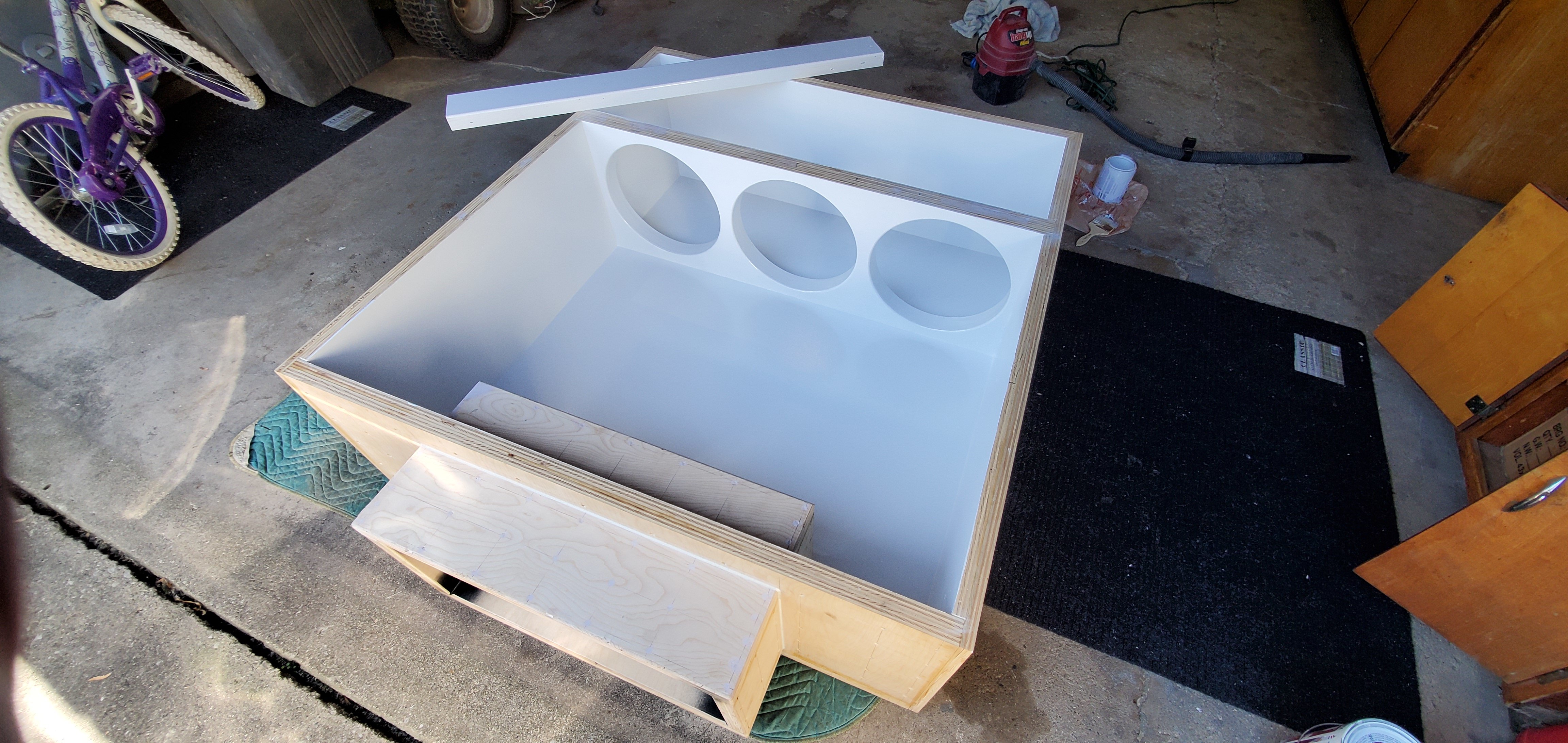

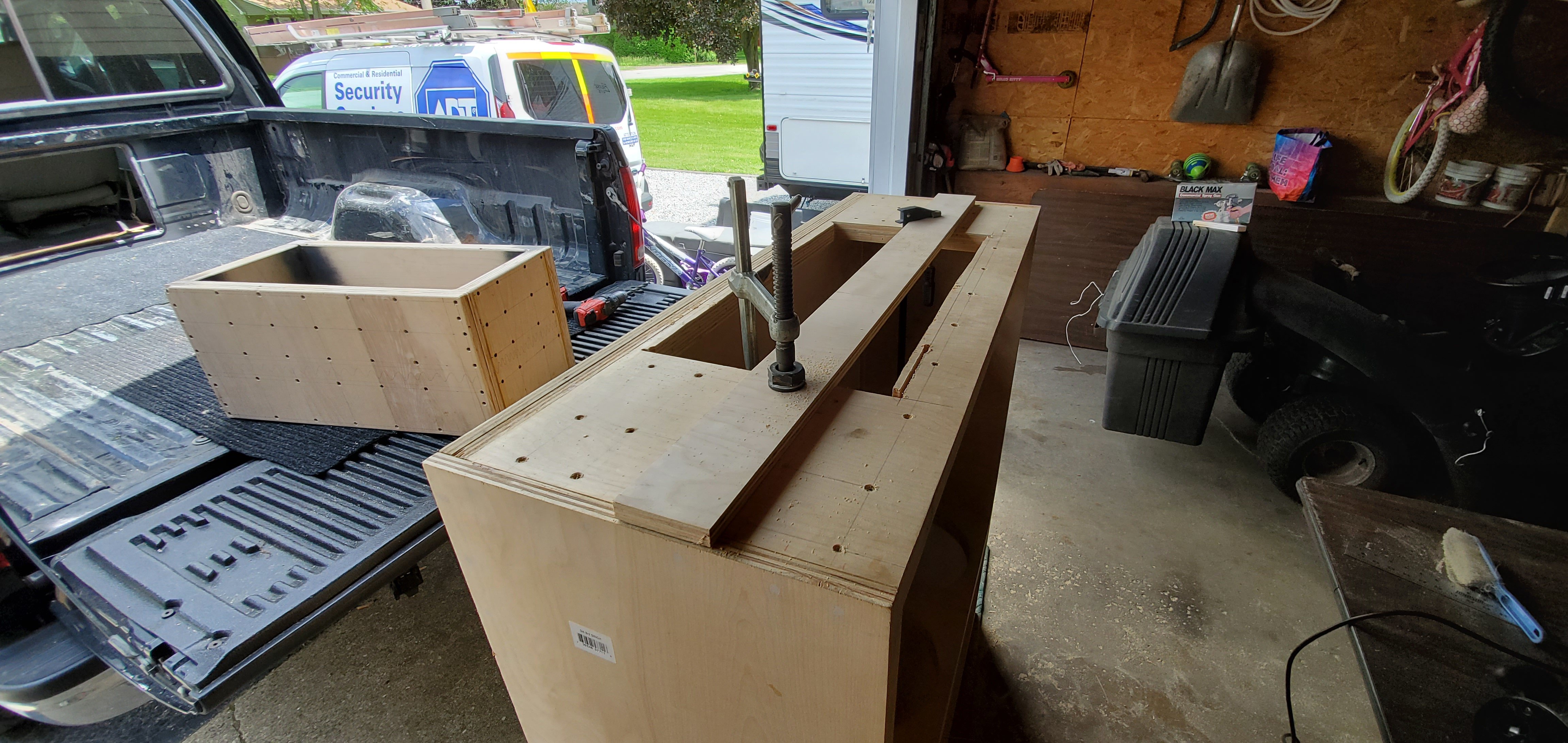

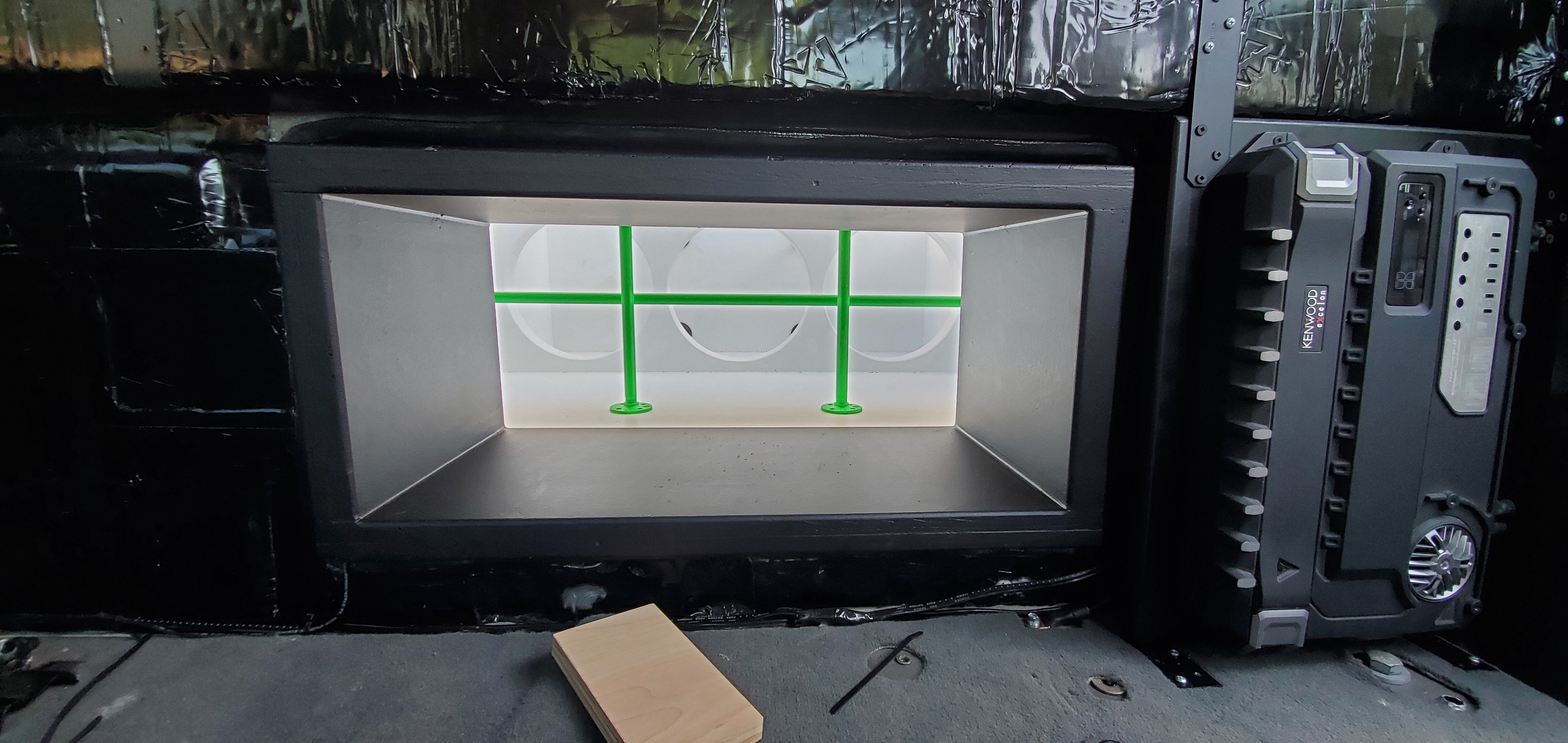

2:1 4th order.  6 cubes sealed 12 cubes ported.  ported side tuned to 44.44hz.  Outside of work this has been taking all my free time.  you think you can do something quick....like i thought....x that by 50!  LOL.  this is some time consuming....basshead.  well worth it.....I built it myself fun stuff!!!  Im hoping for 155db.  I will find that out when done.  I have a SPL labs mini bass meter.  Numbers to be posted later!  All tuned with an Oscope when the time comes too!

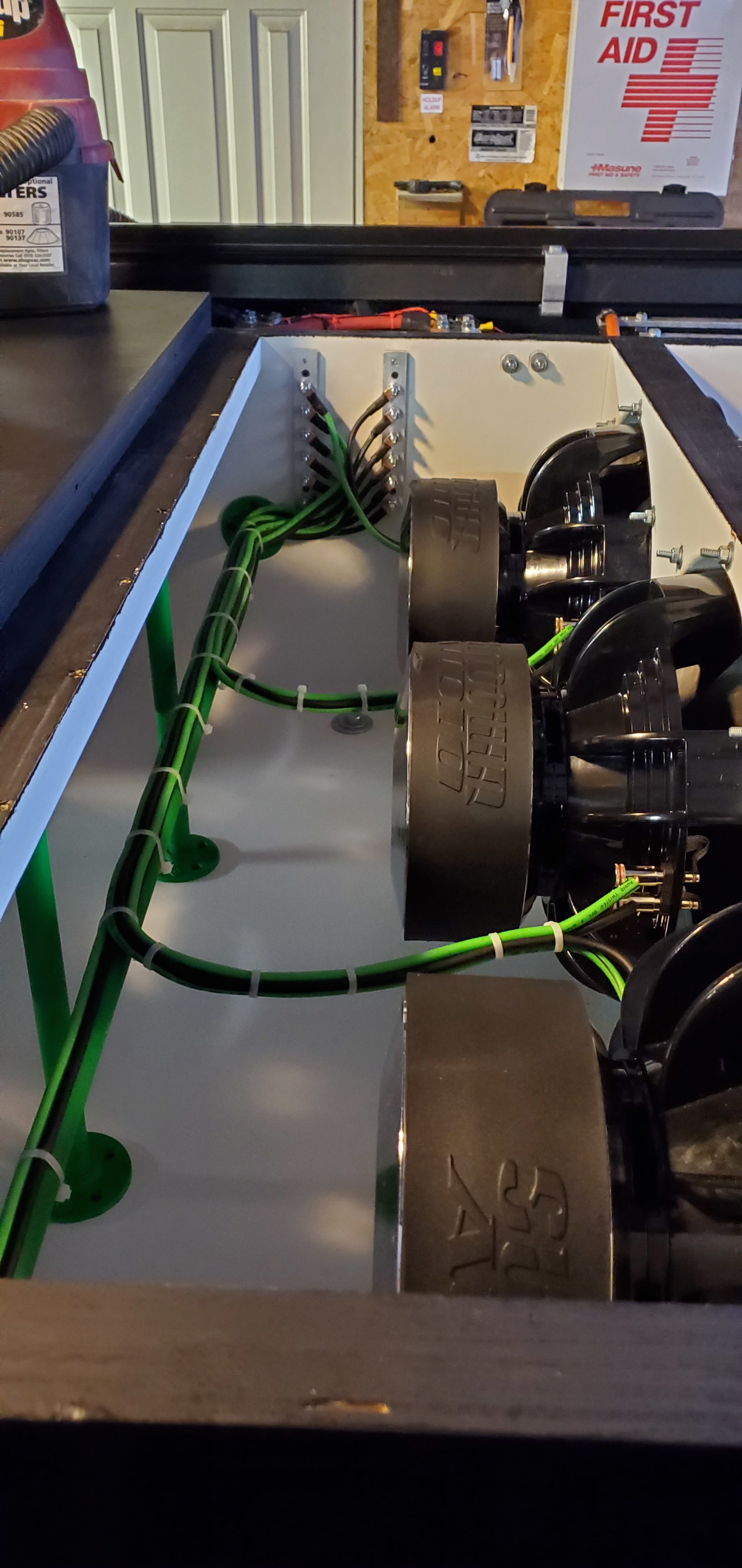

3 Sundown X15's v2 D4's

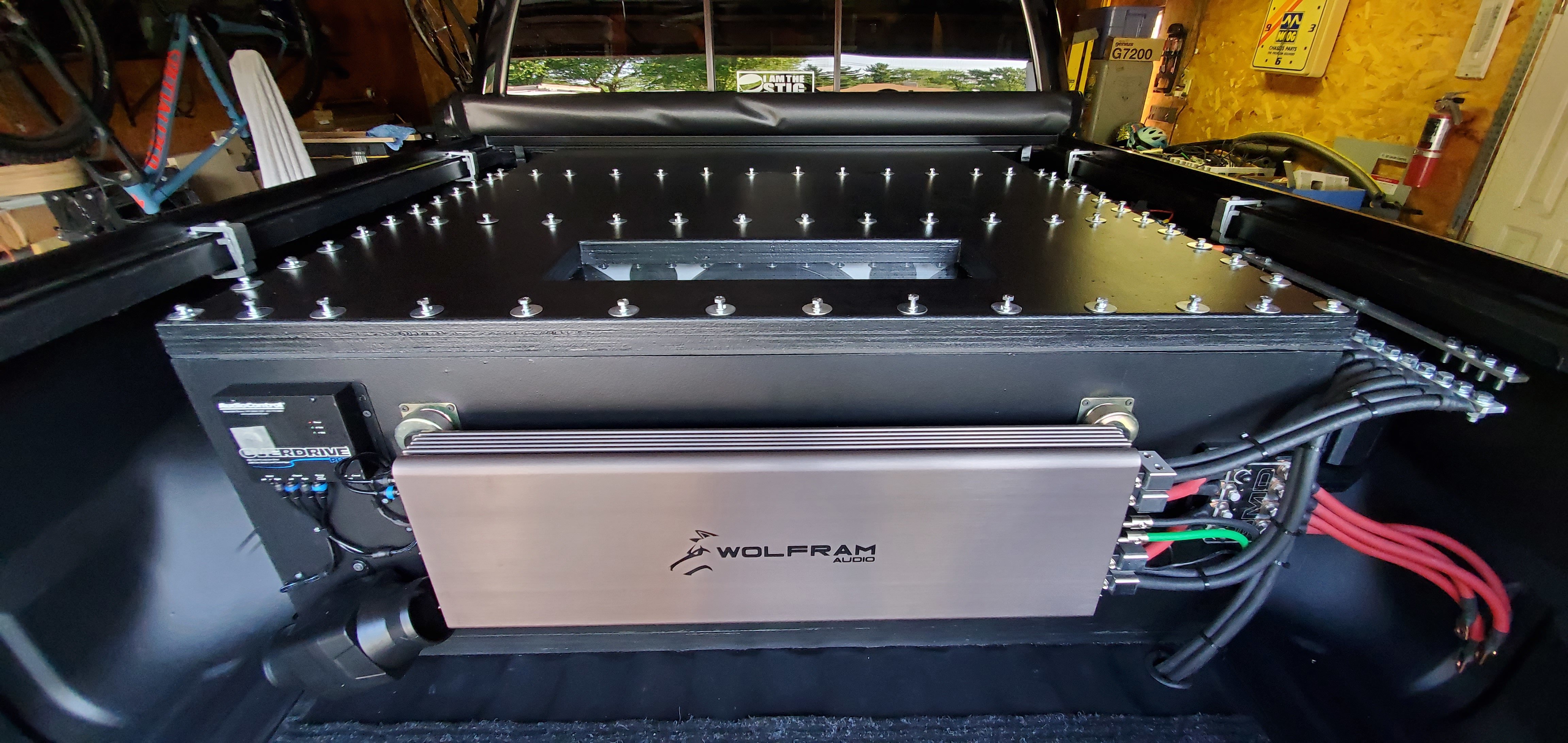

Wolfram 7500.1 @ .67ohms

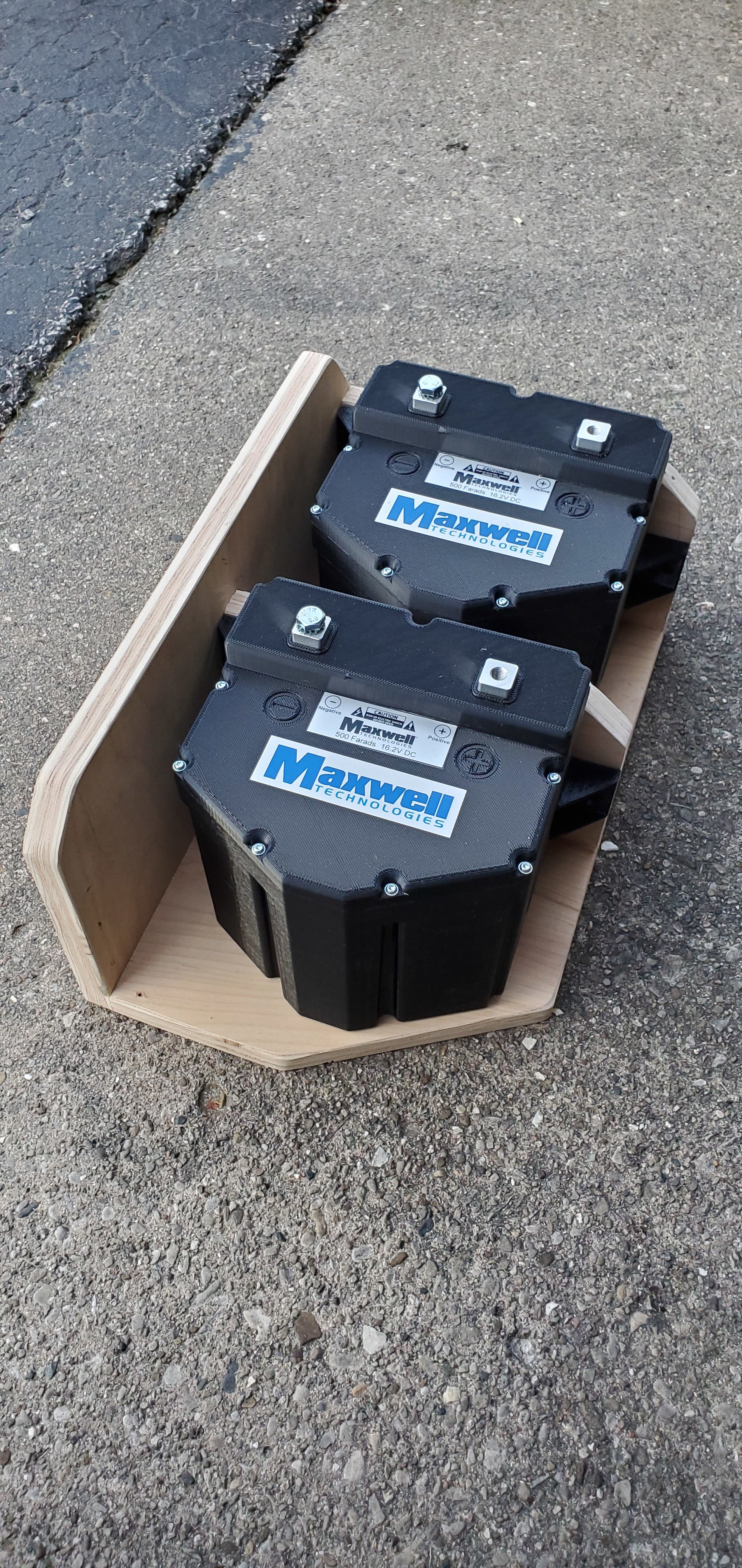

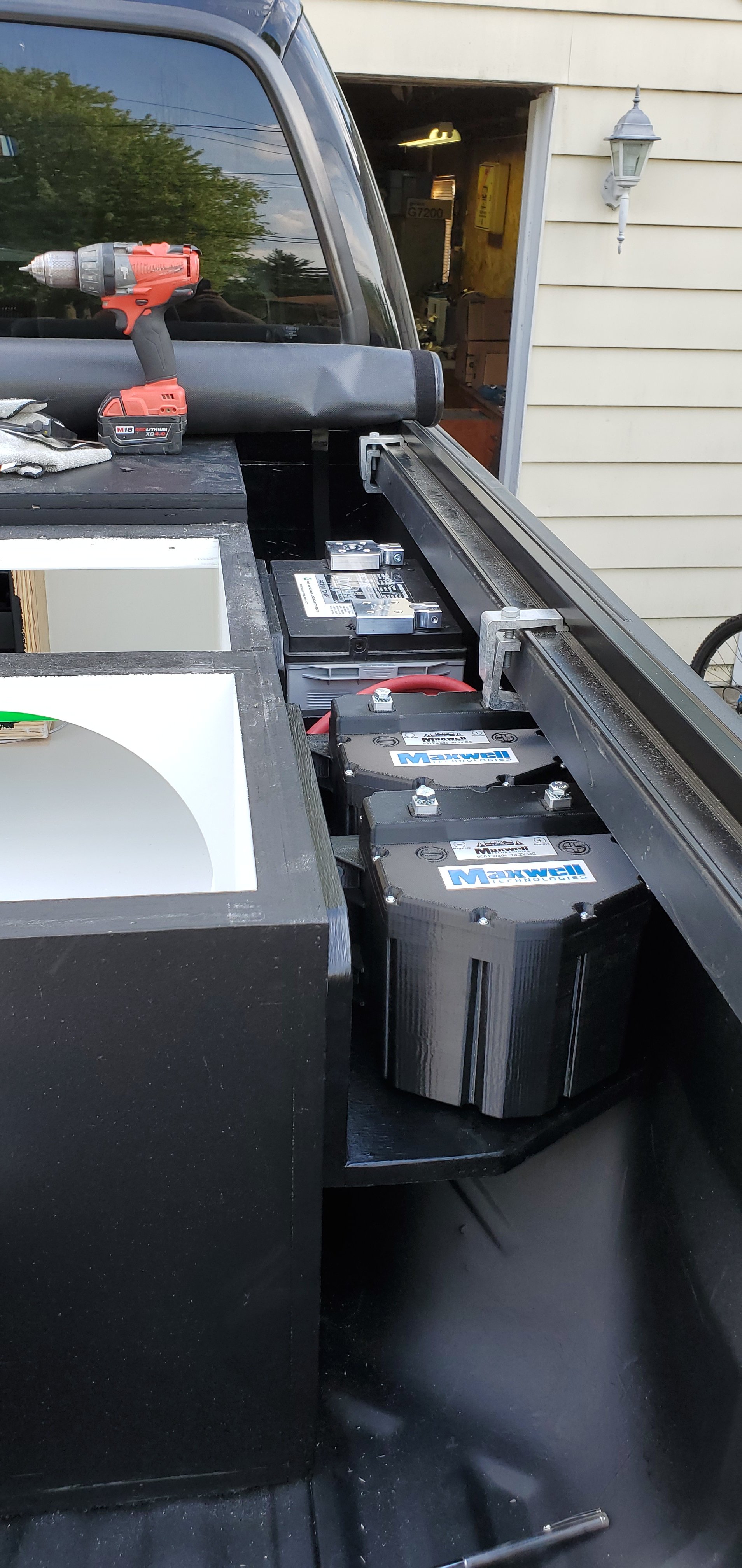

2 Maxwell 3000f Super caps.  16.2v (12 Caps)
350 amp JS alt.
1/0 welding cable from welding supply.com ofcourse.
Quad runs to amp.  eventually
more pics to come

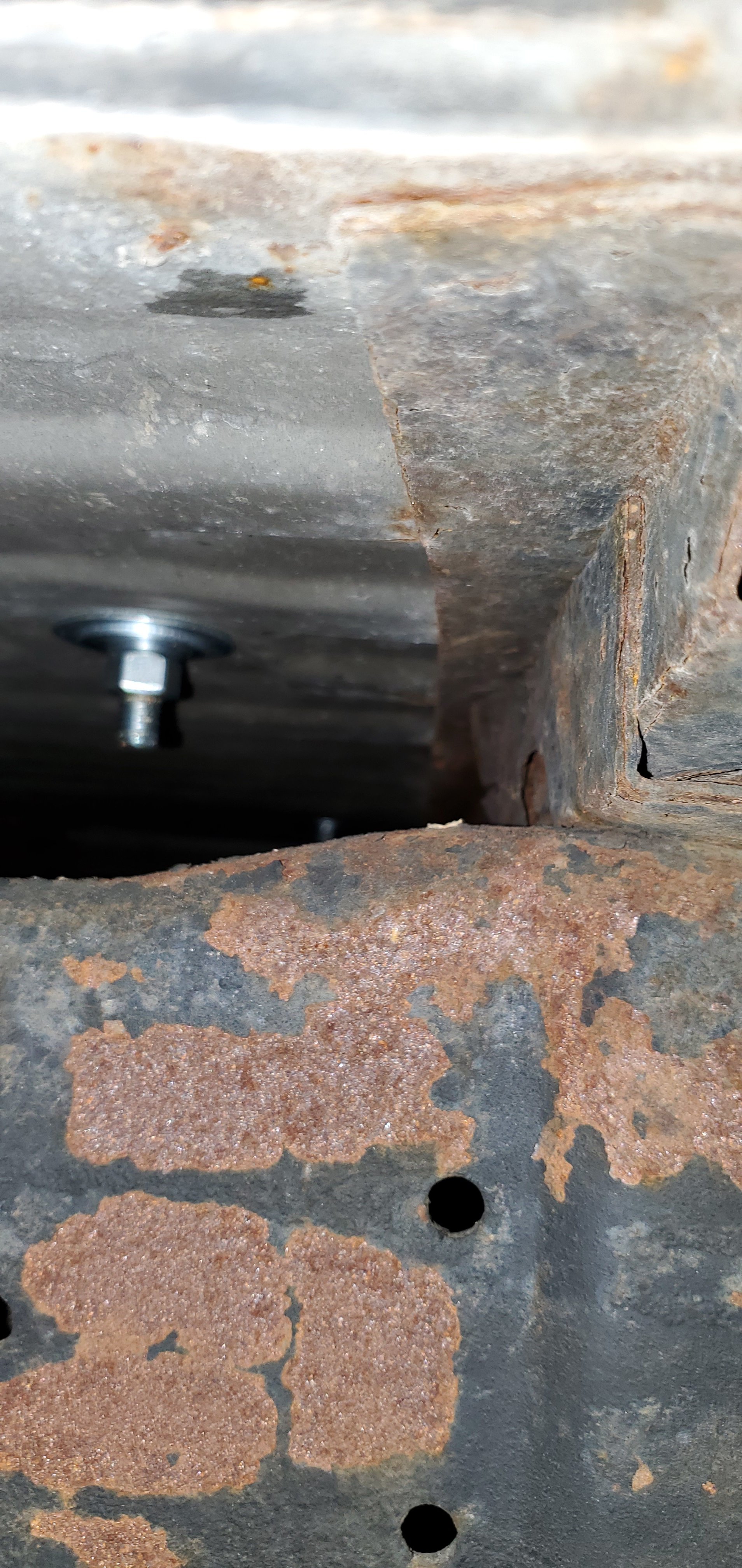

What type of mounting feet are those and where did you get them from?
