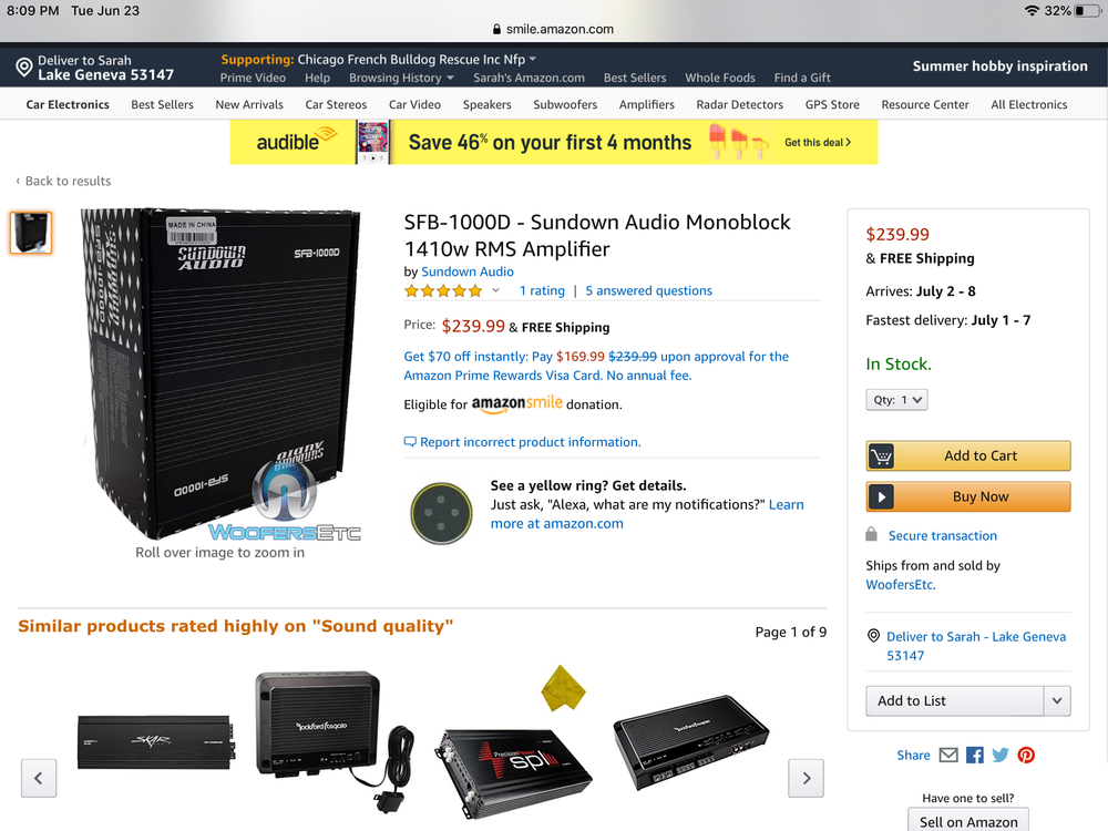

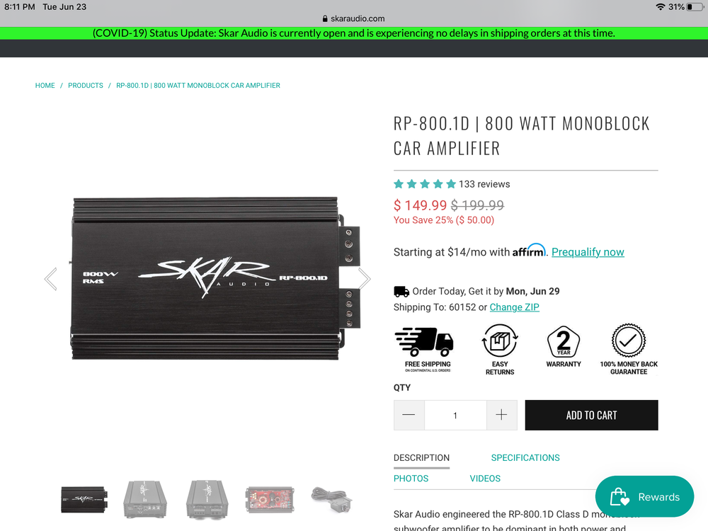

DD makes great subs , I’m sure there subs are all under rated on RMS . I’m running 3 DD slim 10’s and they say like 500rms but I’m running around 2K on them. I would upgrade the amp first before subs.I would go with the Sundown SFB before the Skar. Measure your height U need though cause there a little on the tall side.
Damn that sundown is TINY. Just watched the bench test on it, its a little powerhouse. That would definitely fit where i want it. Thanks for the recommendation.
I guess i could just get that amp and see what happens. If the subs start to overheat i could then look into other subs. Though at that point i wouldnt want to NEED ANOTHER new amp for the new subs LOL
And i agree about DD subs. I miss my 3512s, but not enough to spend that type of money again. If i do end up needing new subs with the sundown amp i would want to stay under 250 each 10" sub.
I cant find the dimensions for the sundown anywhere though. If they are tall i do need that. I might have to send sundown a message i guess.

They are about 2” tall
 Oh ok, the amp i have under the seat now is about 1.85" and there is still some room, so 2" would be fine.
Do you have one of these sfb-1000d? Like it?
