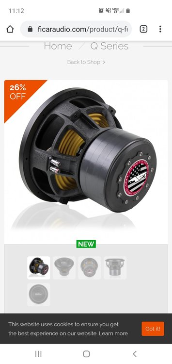

While you are correct, i had to add this because i love this woofer and cant wait to use one.
