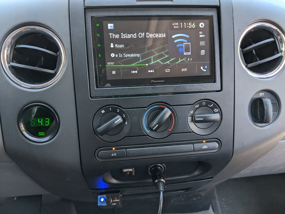

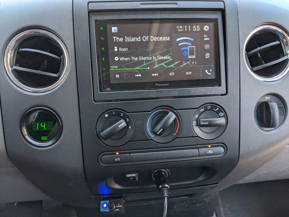

Anyway, it was a little cooler in Sacramento yesterday. So I went to a park, under a nice shade tree, and beat the chit out of my system for probably an hour. Pushed it to one notch below clipping (like I often do) My system has never sounded better :) Got the DSP pretty dialed in now. While sitting at a 600 rpm idle, and never touching the gas peddle, my voltage never dropped below 14.0 volts. I was super happy with that. When driving, it was staying 14.4 (its regulated at 14.5)

PS, Try as I might (because of refresh rates) I couldn't get a shot which showed all three numbers for my voltage... But its kind of misleading anyway, as like I say, it did drop "as low as" 14.0 volts.

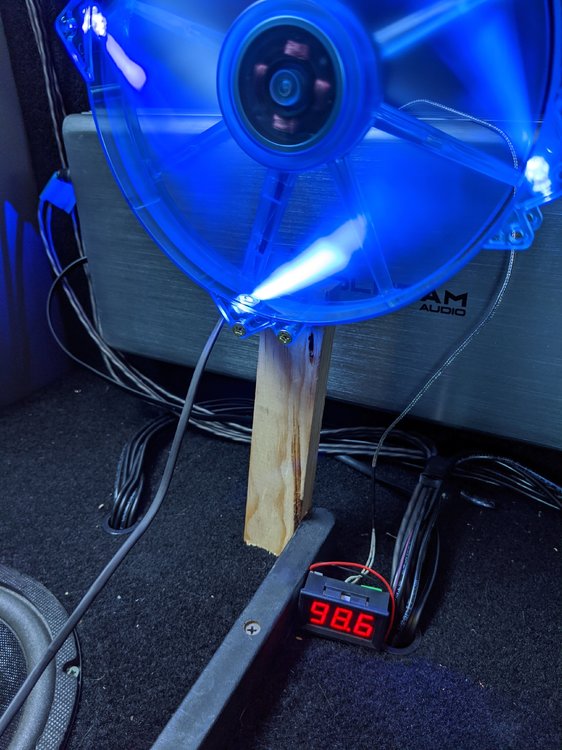

My amplifier temps were staying really good too. Only went as high as 105.... which obviously is like "cool as a clam" :)  They cool to below 100 in like a 1 minute break as well. Still need to build a permanent stand and add the other case fan too.

Not that it will make much of an audible difference, but I think you would be surprised what your voltage is actually doing if you had a meter that could show quick voltage changes. Something like the SMD or a DMM that had min/max settings.
Again, not sure it would be an audible difference but what you are seeing is a limitation of how fast meters keep up with voltage changes. Of course I think you know your voltage fluctuates, why else are considering super caps.
