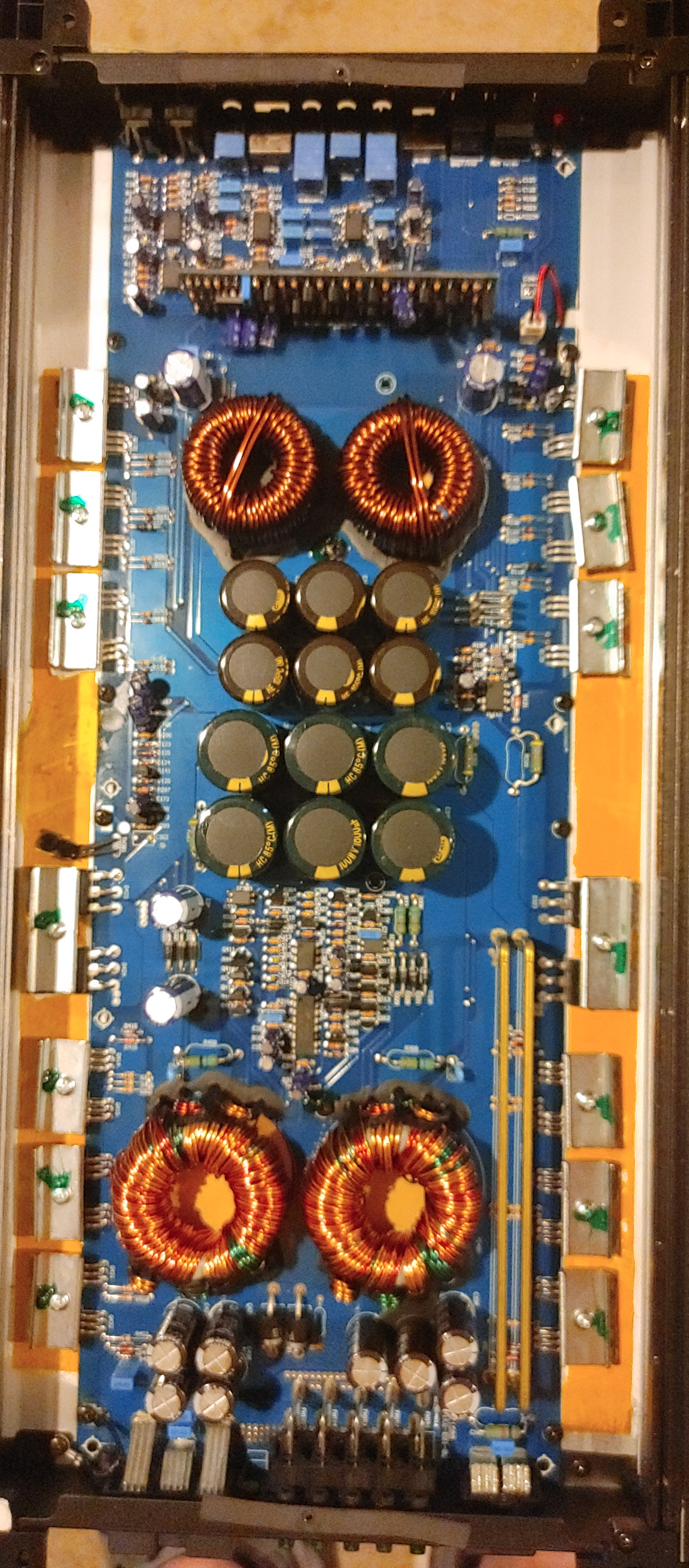

Just for fun. Guess the Country of Origin, Guess the Stated RMS and Huge Bonus if you can tell me what company or factory it came from.

Korea and 3000 watts

It looks like some flea market shit possible made in Korea judging by what looks like Samhwa capacitors.
Looks like a cookie cutter board that a lot of other cheap companies probably use.
Lots of wasted space, on the board, very minimal work done on things to prolong the amplifiers life.
It looks like 4 gauge power/ground connections, and since its using on board ATC fuses that amp would be lucky to do 2,000rms on a good day.
Im sure there is some big number printed on the heatsink to trick people into buying it because they will see some crazy number that the amp will actually never do.....
I wouldn't pay more than $250 for it.

Your in luck lol.. https://www.onlinecarstereo.com/CarAudio/p_45657_Dual_DA8001.aspx
Y'all are Both right.... Stated RMS is 3200 at 1ohm 🙄
Inputs are 2AWG for whatever dumb reason 4AWG speaker out 🤣
Fusing suggests close to 2000w(150A) luckily it was free....
Has a 5000 in the model number
It sounds decent but will be replacing it soon. I've ran it for a few years without an issue but still don't trust it.  MSRP was 259-279 iirc...

Actually 150 amps of fusing suggests 1500 watts rms.
In the real world and not Mr Rogers make believe land there is something called efficiency, and amps are generally 70% efficient in making power.
150 amps X 13.8 volts =2070 wrms
0.70 efficiency X 2070 watts = 1,449 wrms
So I stand by my comment of it being lucky to do 2000wrms on a good day.

The Chinese Version Did 1870 on the AD1
Soundstream T1 4000DL
Not to argue semantics but yes I was not including efficiency
