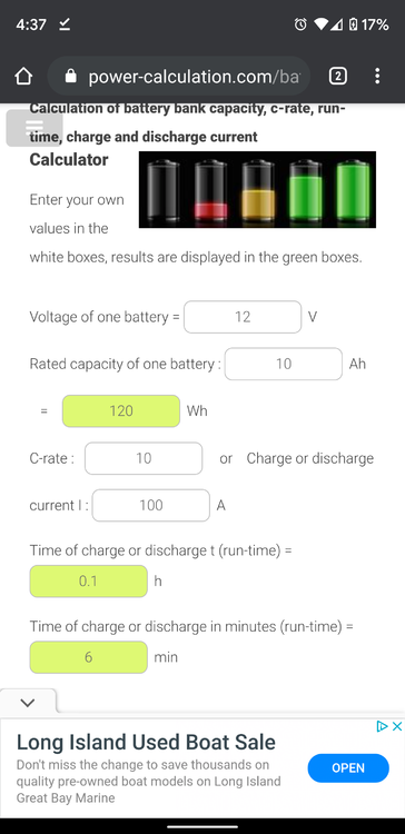

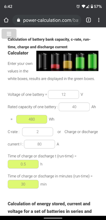

jnasty Posted September 10, 2020 Author Report Posted September 10, 2020 6 hours ago, Joshdashef said: Only if it were that simple ... From what I can see the JY offering has a lower c rating (2c?) than the Titans (10c+). That's why I went with Titan. I think the Titans are smaller as well. Titans are definitely smaller & about half the weight too.. I'm not sure if I'm doing this correctly with this online calculator but it seems the titan will last only 6min with 100a of current & the JY 30min @ 80a. That much of a difference doesn't seem right to me Vehicle: 2002 Ford Escape Electrical: 275A Singer, 160ah XS/Yinlong lithium, 2,000farad XS Supercaps Head Unit: Apple iPad Hi-Res Passthrough Topping d10s Speakers: {ACTIVE} - (4) Arc Audio RS 6.0, (2) Arc Audio RS 4.0 & (2) Arc Audio RS 1.0 Sub Stage: (2) TC Sounds LMS Ultra 5400 18" Amplifiers: ARC Audio - (4)4200SE(comp modded, (2)4000SE Processing: Helix DSP Pro W/ Dash Mounted Director
