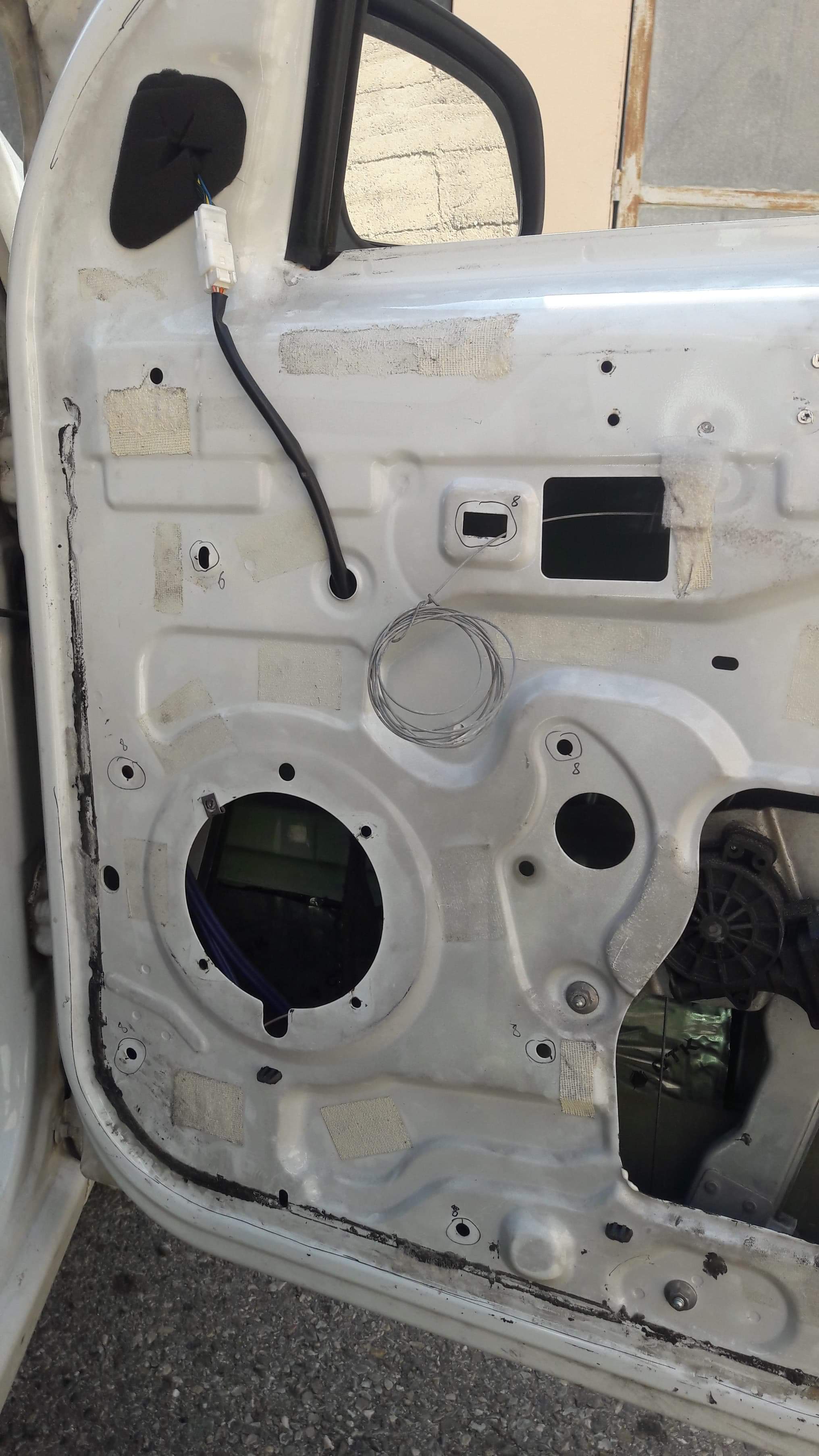

There you go, here is the metal frame, see I marked every OEM holes where I put the bolt.
This is layered like this : Bolt - Metal frame - Locking Nut - Deadener - Wood pannel - Locking Nut

The doors are awesome, I had to change the OEM door opening system (see that steel cable on the panel), now it's located somewhere else.
I also put some kind of sticking foam boards inside to cancel the 120-150hz resonance inside, now it's good.
The only issue I have is that the panel is flat, so while demoing doors opened the sound does not go where it should (door hasn't a 90° opening angle, I have to modify that).

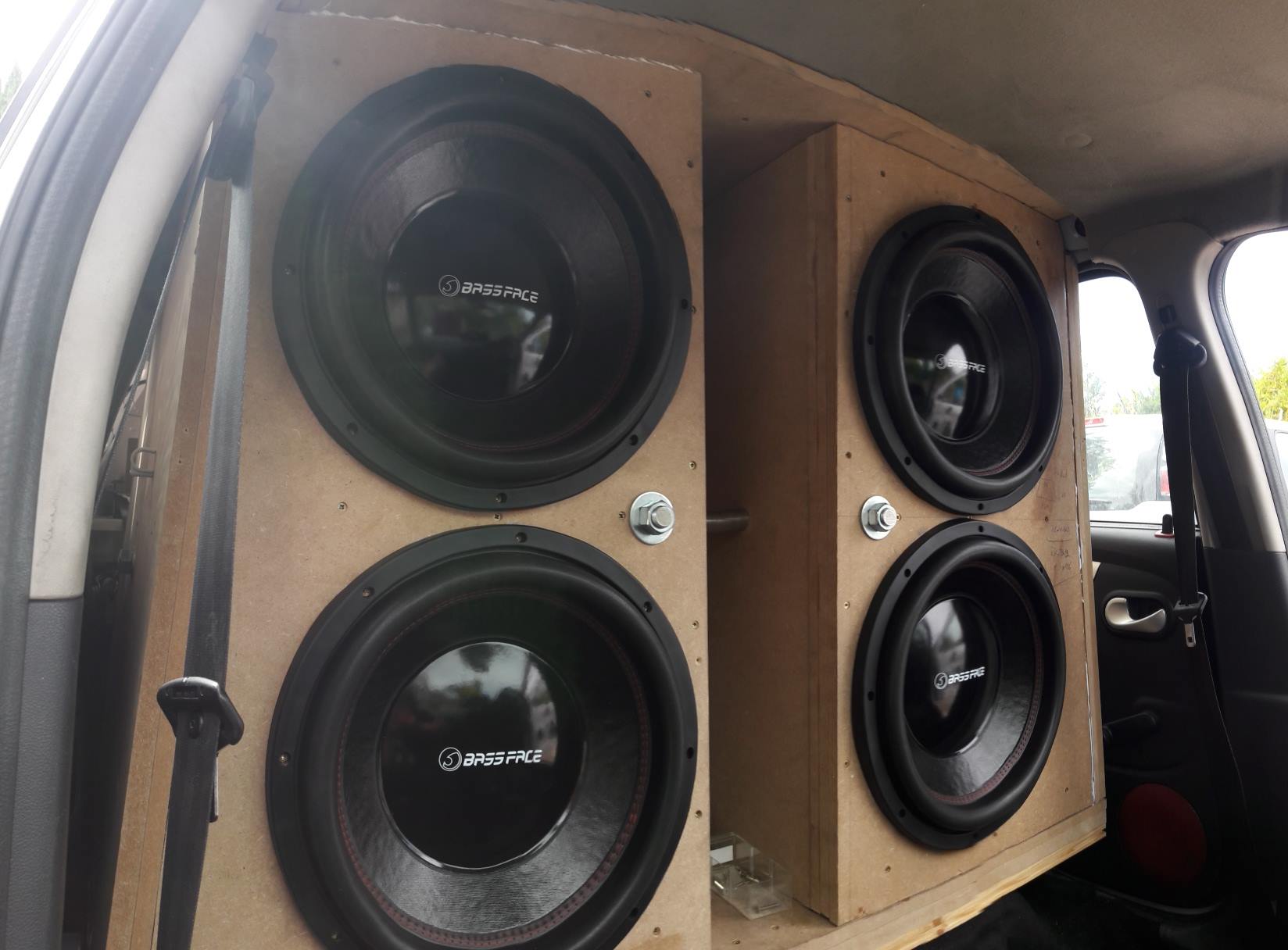

First thing I did was removing the old wall (Wood only wall, with 4 BassFace XPL15.1 (smaller version than for the new build) + 2 x 8k GZ amps (doing 159dB legal, 160.8 outlaw).
Had to go with the chainsaw :D
EDIT: of course, it's not shown in the picture but the old wall was sealed :D

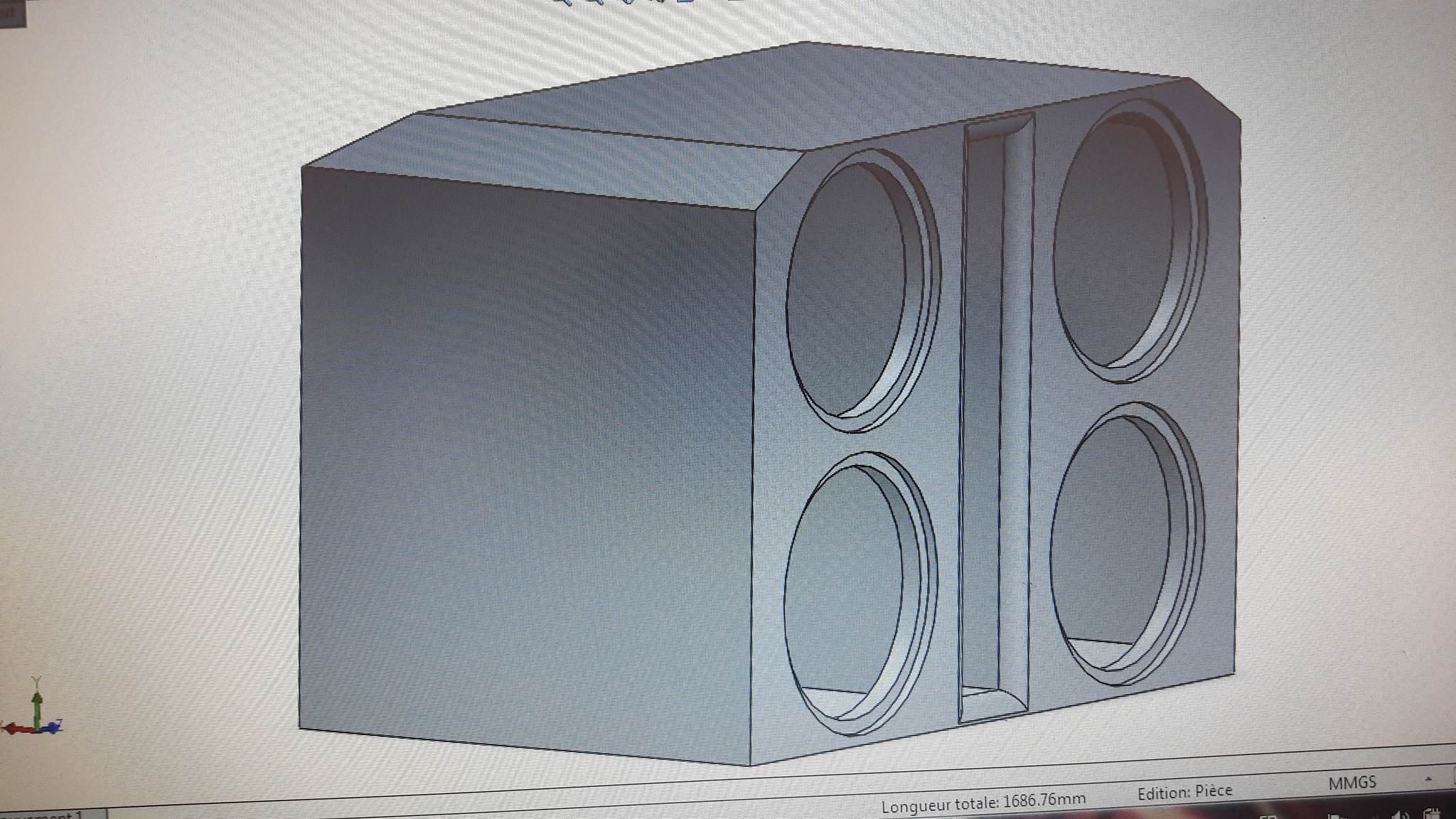

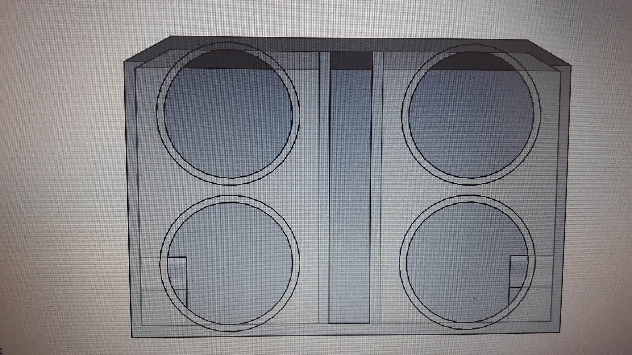

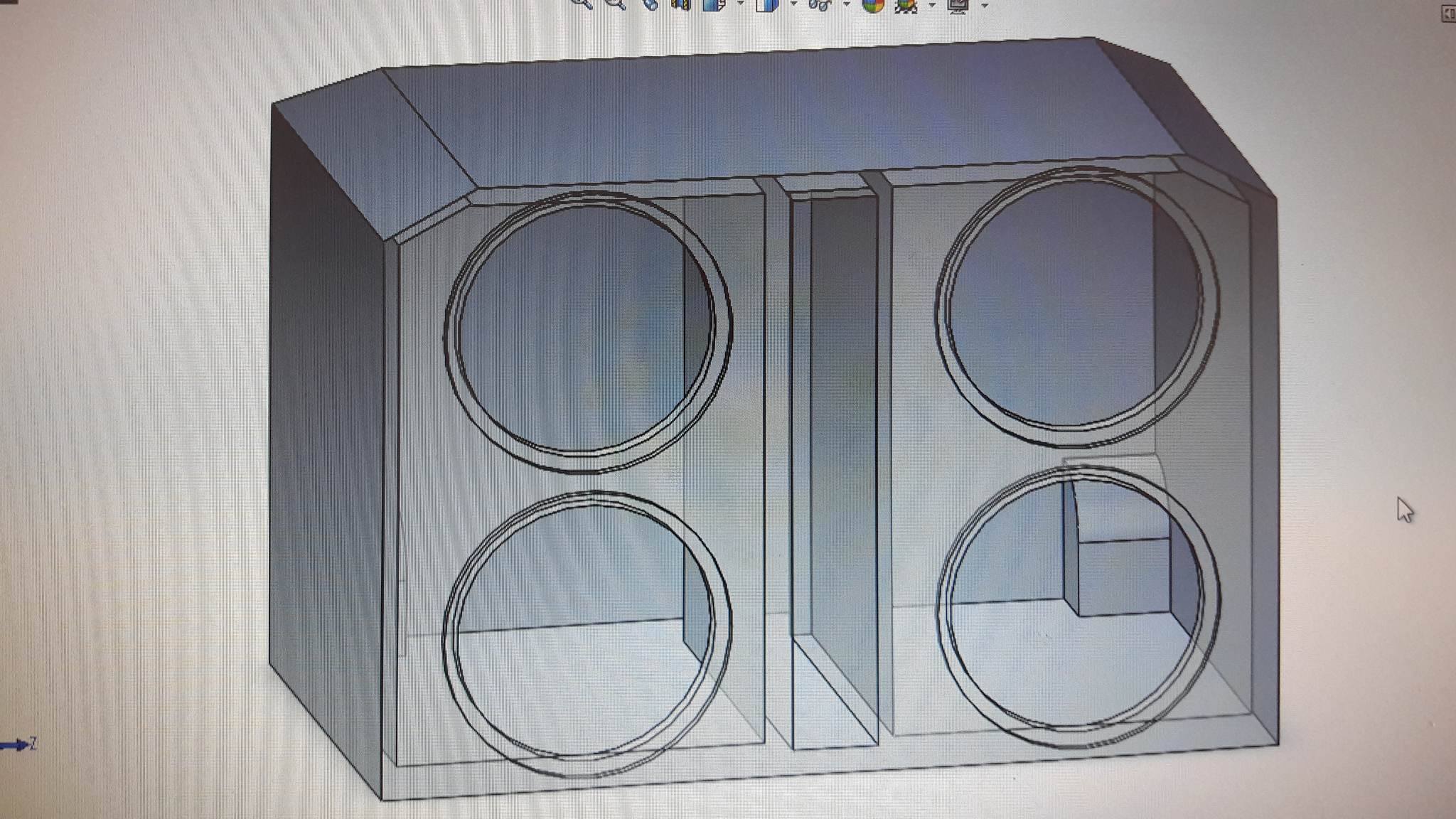

Then it was time for the design, I wanted to have approximately the same wall as I had in the previous build, but much stronger.
So I went for an simple flat wall, 20.5 cufts charge volume after all displacements, with the idea to maximise the width and height and minimise the depth.
I think it ended somewhere close to 51" width, 34" height and 26" depth.

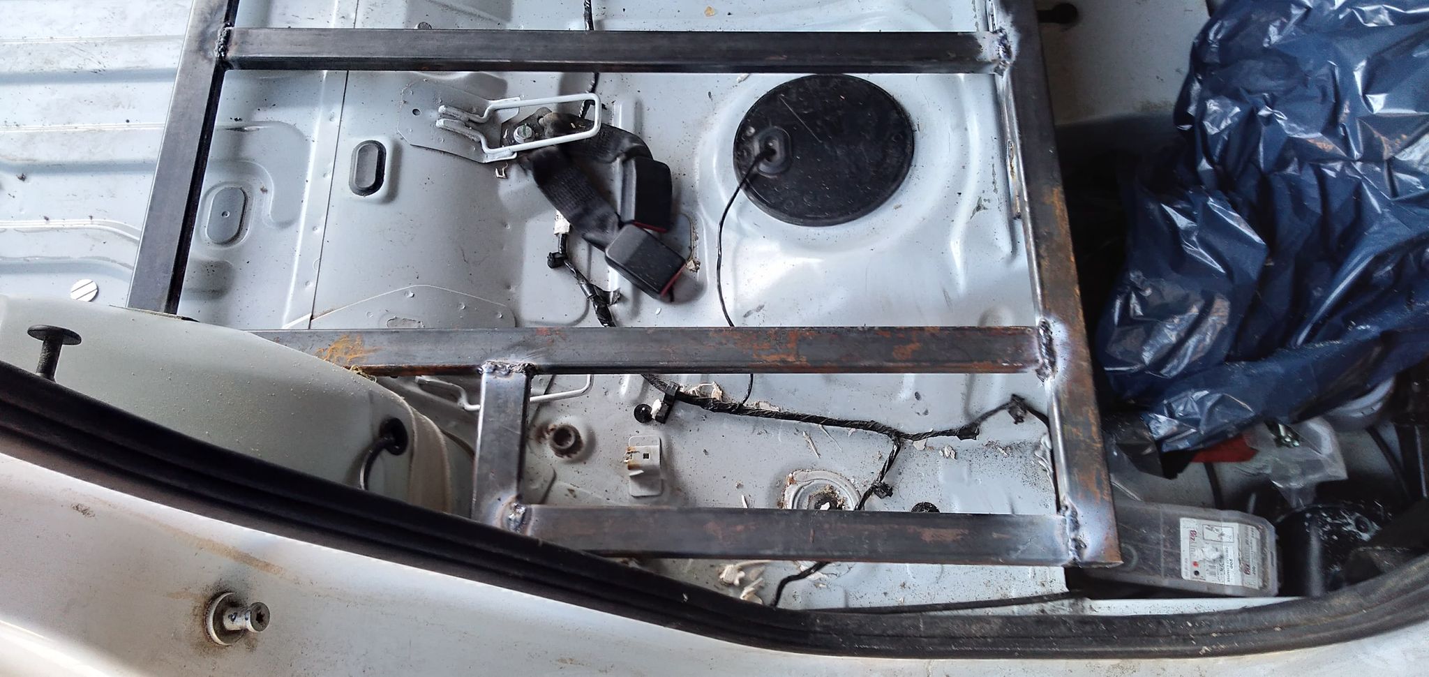

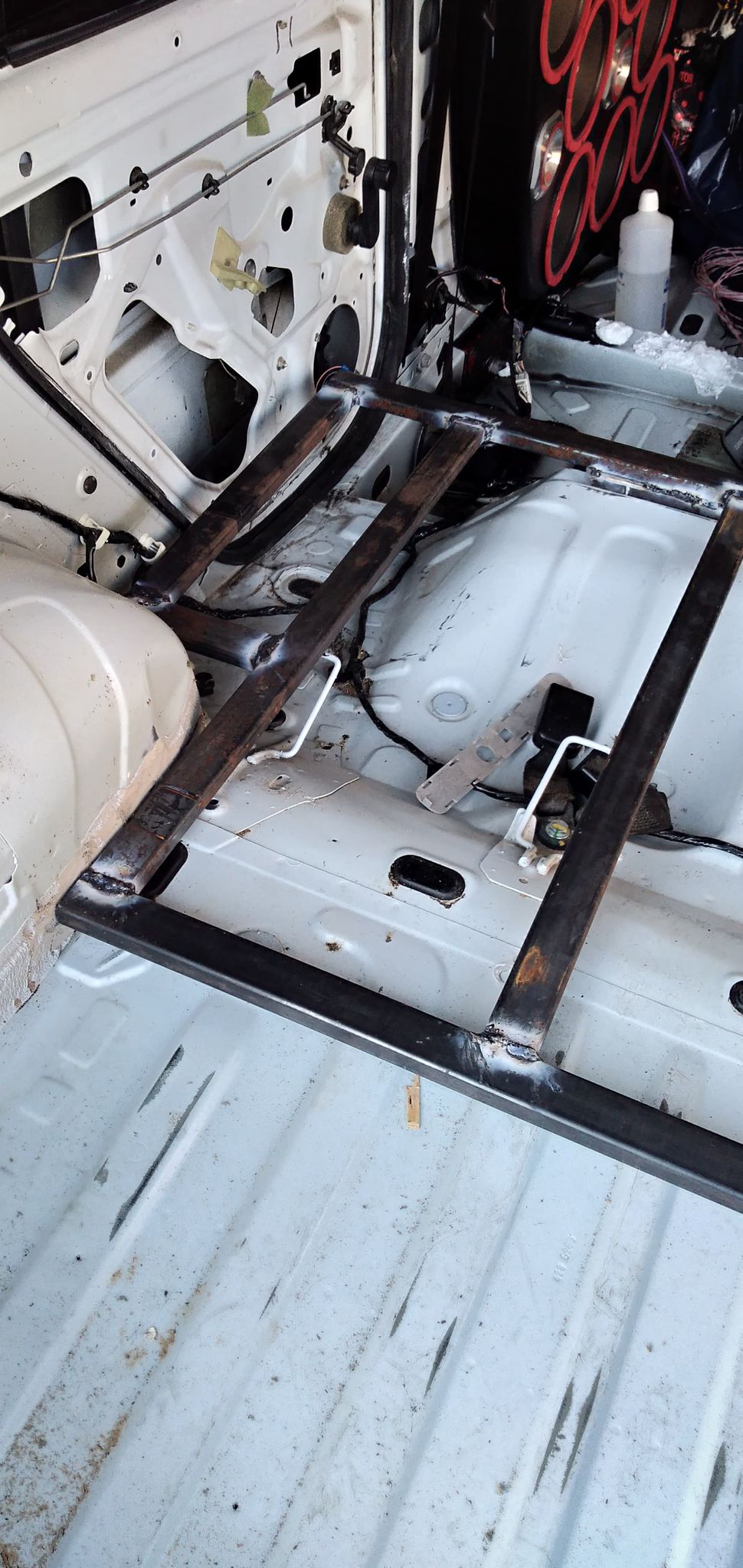

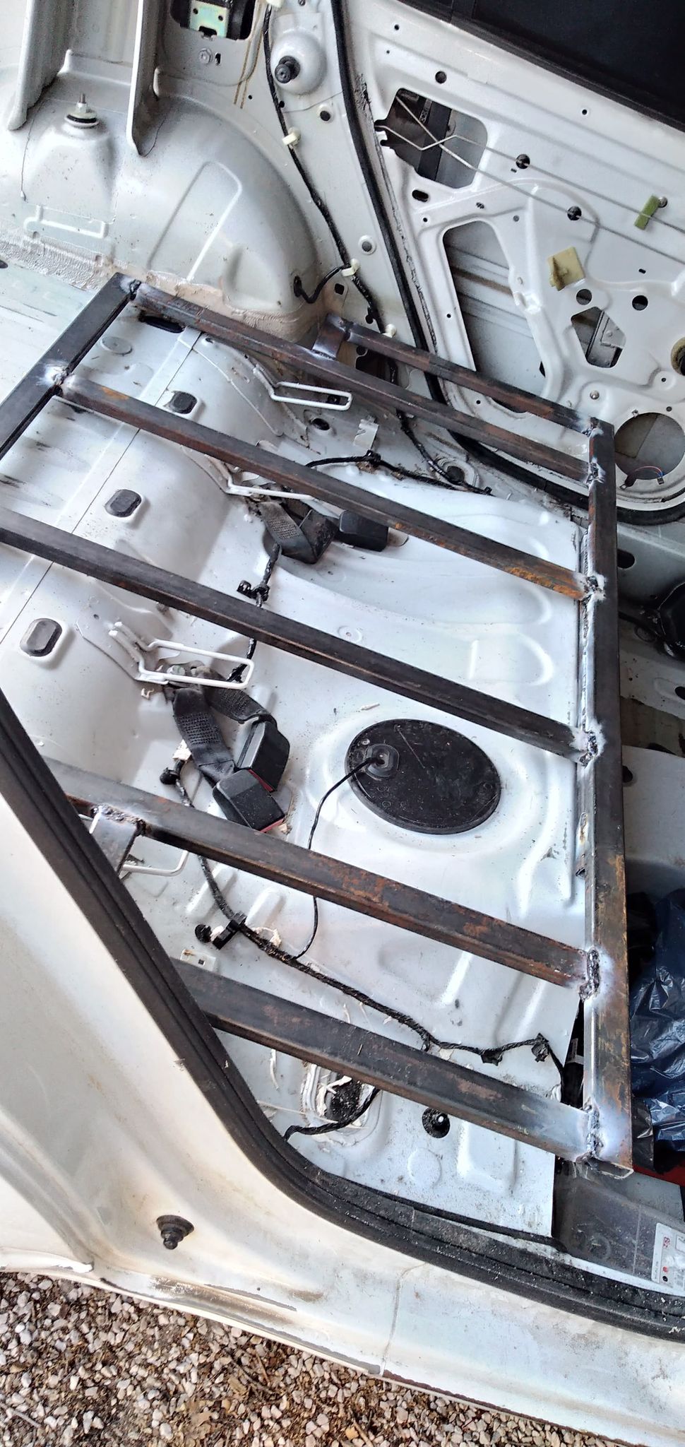

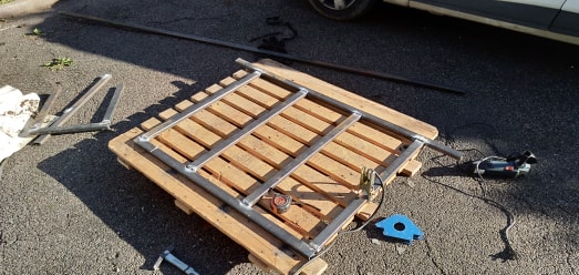

As I had to build a steel cage, I bough a welding machine, and learnt to weld.
The firsts welds were kind of horrible, I had to sand them and weld a second time to get something solid.
I made the different parts separately, as the car is small, it's really a buthurt to work directly inside.
I started with the floor piece, welded some parts fast to test if the fitting in the car was good.
And it was btw :)
