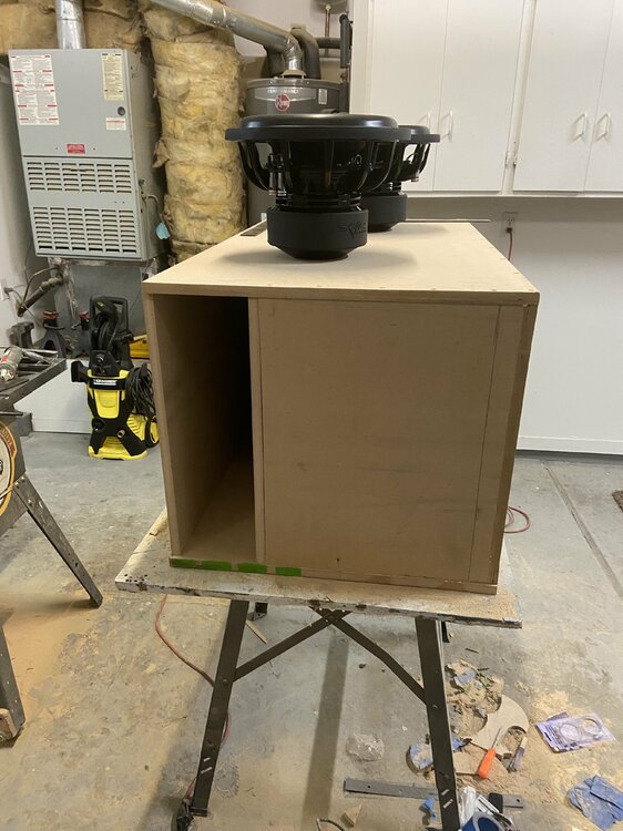

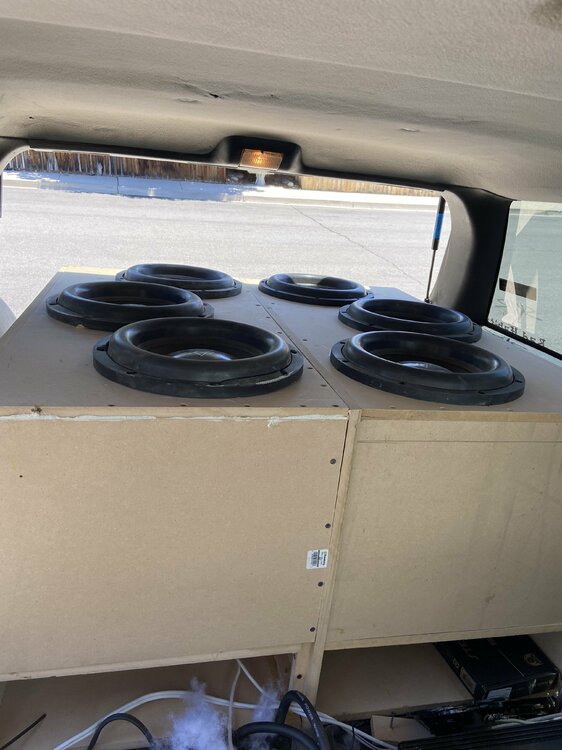

zjKrawler Posted June 17, 2021 Author Report Posted June 17, 2021 Sorry about the delay, I did decide to go up on the amount of subs to 6 Skar EVL 12D4. I have them parallel/series wired to I believe 1.333. Same amp set up just added a SkarRp150.4 for mids/highs. As for power I have 2 Xs power 800 Amp in parallel for my engine/vehicle off of factory alternator. As for the system I have 2 deep cycle marine ( oriely auto parts ) brand. Believe it or not for $100 the batteries blow my mind.. drove for 3days on one while running the system without the alternator at all. Struggled at end but still powered it. Anyway, those (2nd) batts are off their own (2nd) factory rated alternator. 150 Amp each. Every cable is doubled at connection and 1/0 ga. I’ve never noticed any power drain or dimming of anything. When on and running with all acc on I sit at 12.8-10.2 v volume dependent. So the new box is internally 40x20x22 which is 3 subs and 2 overall boxes. 96 sq in port area. Now some calls say 28’’ for port length some have said 28 cm I tried at 28’’ first. Port is approx 5’’ x 20’’ at that length. Internal bracing is equal to (2) sides so .75x20x22. I have stopped at single layer on box cause I’m unsure if I keep this setup or go 4th order. I really want to do a 4th order. Currently it does a 143.3 @ 37-39 hz and haven’t really pushed it but I have the feeling I’m able to get a lot more out of it with tuning or a 4th. Doing first competition this month in a couple weeks. Would be up against 6 12s walled in an extended cab Chevy truck. He does 147. Any help is welcome.
