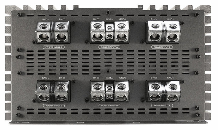

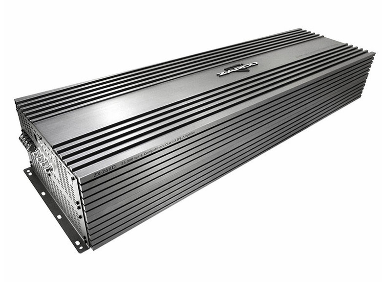

Hey Arthur, that is a pretty bad ass amp :) Never seen those.
