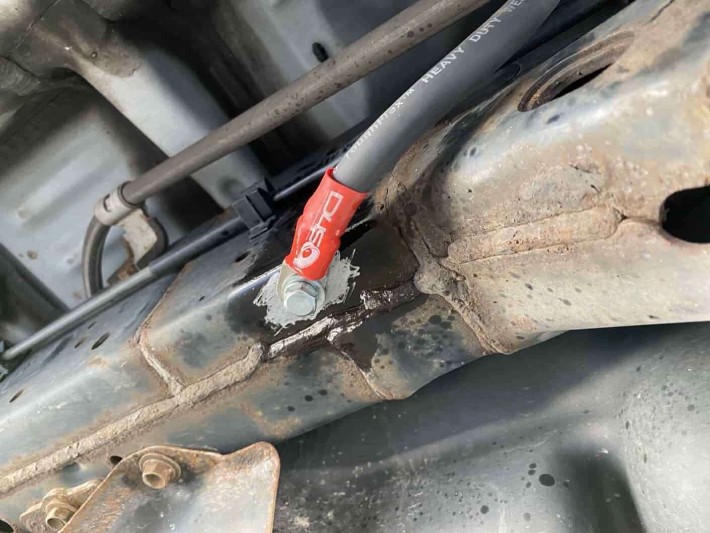

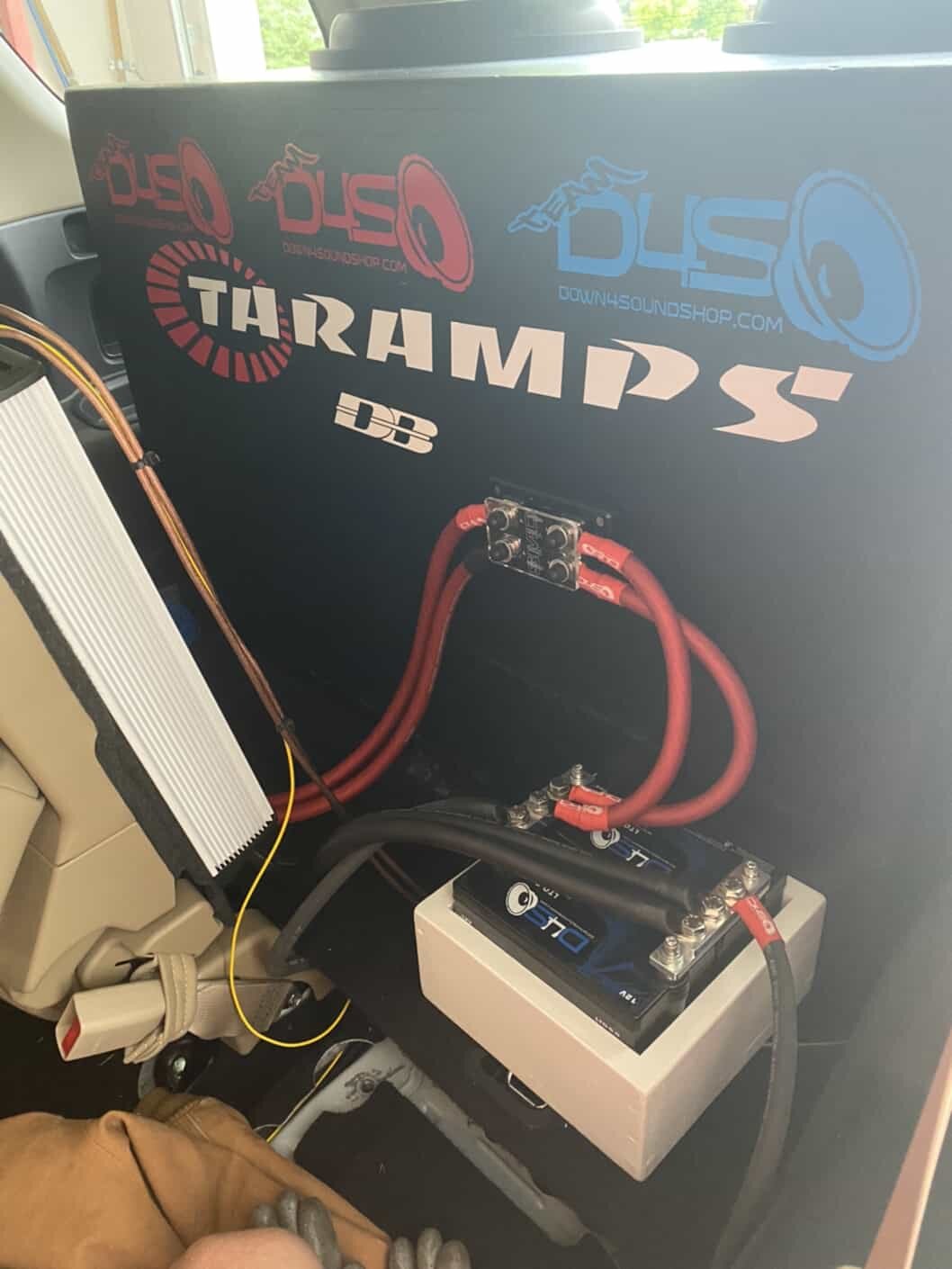

        My system still isn’t what I want it to be:( installed a smart bass Taramps 5k with two d4s lto 6.0s. I have a single run of 1/0 welding wiring going from alternator to positive on lithium bank then I have a 1/0 ground going to frame of car. Big 3 is done with 1/0 welding wire as well. 270amp HO dc power alt installed as well. I have yet to install a volt meter although I do have one. Subs are wired to .5ohms and honestly I’m not that impressed. It’s a decent bit louder than the 3k I had powering both subs but I really thought it would blow my mind.
        I also seem to have voltage drop issues because I clip at idle after going full tilt for a few minutes.  I’m really frustrated and want to give up and walk away from it all. I had high hopes for this system and hoped to enjoy it for years until it’s time to upgrade and rebuild. Here is my setup and my ground. Let me know what you guys think. I want to get this right

Voltage drop is going to happen. It just does. Unless you want to get multiple alternators and more batteries, it is what it is. As long as you're not dropping down into the 10's really, you won't damage anything.
With the Taramps, when that yellow clip light flashes, that's where you want to be. That means you're about to clip, not clipping. When the yellow light and the red light both come on, that means you're actually clipping. Also, soft clipping usually is ok. You just have to make sure you're not constantly clipping over and over again.
Where is your amplifier grounded to? The battery? If so, I would add another ground to the frame, and maybe double up the big 3 runs. Probably won't make a huge difference, but worth a try. That smart 5k eats!

Appreciate the reply. Just got back from slamology and it absolutely blew my mind! Learned a lot and met JP, Jacob Fuller, and Jacob viral too even!! Got a ton of demos and opened my eyes to what’s out there. I also realized I was worried to push my subs hard and I got in today and it does get down 😅 after seeing how hard guys were pushing their subs there (burn your hand when touching the magnet type of hot) I was pleasantly surprised how loud my system is!! I’m happy with it! Need to get my voltmeter installed still and mids/highs but it moves some air at 30hz (box tuning is at 30) Not like hair trick crazy but a nice amount of wind. My amps are grounded to battery which is grounded to frame. Do you think they need another ground? My amp has two negative inputs so should I ground both those straight to frame instead of battery? My port is about 6ish inches away from trunk hatch and my port is 5 1/4” wide. Do you think that is a big deal or no?
My box is already bolted down so I’d prefer not to have to move it but it sounds good!  Can’t wait to louden up my vocals here soon. Really all came down to me being scared to hurt my subs. I was playing them to where I was comfortable and it just sort of got them warm but I don’t think I’m pushing them like I should. You are correct, that smart 5k puts out some serious power and once I turned my hu up to max volume where dd1 said it doesn’t clip that 5k was nice and loud
