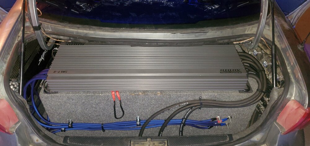

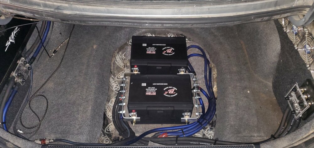

josephj86 Posted October 17, 2021 Report Posted October 17, 2021 Hello guys I recently got a salt 8k I have 2 50ah B2 riot lithium batterys and a 320 amp alt, all ofc 1/0 power/ ground wire, big 3 is done. System was working beautifully then these little issues started happening, Id turn my car on the amp would be in protect so i took all the steps to get it out of protect, amp is back on and working next when at high volume the amp just shuts off I turn my deck off and power it back on and the amp is back on? I've checked all my wiring power,grounds fuses everything is tight and there's no exposed anything I cover my buss bars up with covers when everything is put back together still these issues keep going on? I'm totally confused on what it could be any help would be much appreciated my basshead brothers

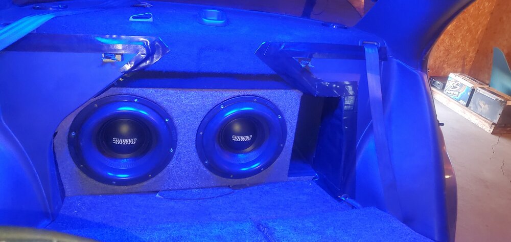

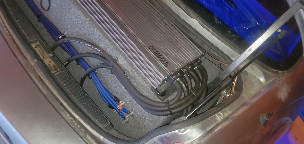

josephj86 Posted October 17, 2021 Author Report Posted October 17, 2021 It only happens with the 8k my 4 ch stays on, my voltage doesn't drop much at full tilt drops to 13.4 and I have the amp is at 1ohm I've double check every connection coukd be ground location as well im going to try grounding in a different location. I think I know what it might be just from looking at the picture I noticed something that might be affecting the amp if you look at the right side of the trunk the strong arm drops pretty low I think that it could be pulling the power wires connected to the amp im going to do see if that's what it is. But DAMN I'm very happy how well the zv5's handle this power they barely get hot thanks for the reply man
Dafaseles Posted October 17, 2021 Report Posted October 17, 2021 4 minutes ago, josephj86 said: It only happens with the 8k my 4 ch stays on, my voltage doesn't drop much at full tilt drops to 13.4 and I have the amp is at 1ohm I've double check every connection coukd be ground location as well im going to try grounding in a different location. I think I know what it might be just from looking at the picture I noticed something that might be affecting the amp if you look at the right side of the trunk the strong arm drops pretty low I think that it could be pulling the power wires connected to the amp im going to do see if that's what it is. But DAMN I'm very happy how well the zv5's handle this power they barely get hot thanks for the reply man Hopefully that's the case and it's an easy fix. That does look like a dope setup! Is the front of the box completely sealed off from the trunk? 2011 Chevy Silverado under construction My build log here. Check it out!
