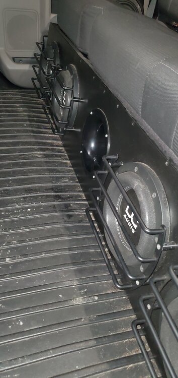

Yes I do now.  That's exactly what their calculator called for.  Their calculator has the option of configuring for multiple ports but I choose single port and for 3.0 cubic feet the given specs were produced.20211229_180447.thumb.jpg.a0d3fd82391bd350650446f2ede8e79a.jpg

Yaaaaa lol just another embarrassing thing I've searched Google far and wide for an answer.  I dont know how to build slot port for my exact type of enclosure.  Let me explain.....it's wedge style and the front height is more then rear height.  Therefore I don't know how to calculate area per the change as the height of the port reduces as it goes back.  I hope I'm explaining this right.
Where did you get or how did you make those grills? I like those
Thanks!  I the grills from Amazon.  They don't have near enough depth to them.  The sub will slap the hell out of them to where you'd destroy the sub.  So I had to buy nylon spacers (I think they are 1 inch) and place 1 between the grill and the box at each mounting screw hole of the grill.
