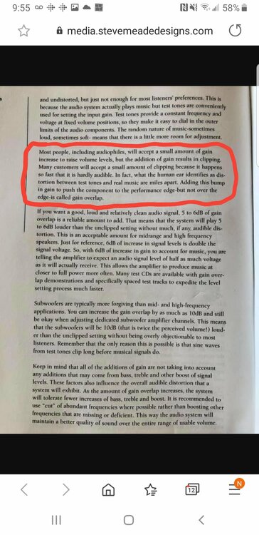

Here's some information about why and how we use an overlap that I found good information946923634_Screenshot_20201103-215547_SamsungInternet.thumb.jpg.4cda855f3656f6c67d66b77c843908f3.jpg

So is it safe to use 0db for headunit, then -5 for mids and highs for the gain part?

That's what I've always done and have never had a problem

safe? you should always be at 0db for the head unit and any other processor before the amps.
