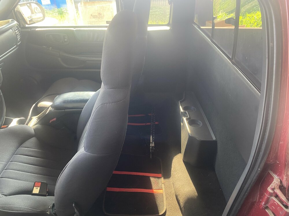

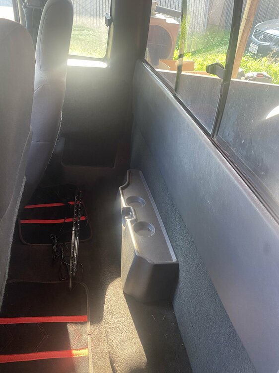

jessdabest77 Posted January 21, 2022 Report Posted January 21, 2022 I have a 2002 Chevy S10 Xtreme ext cab and equipment will be two older FI SP4 15’s V1 dual 2 ohm subwoofers on a 8 k amp. All the electrical will be upgraded plus all sound deadened. I really need help with the box design. I want to play loud and slam on the lows. Subs up, subs forward, port up , box size running? Any idea’s or suggestions greatly appreciated thanks The space I have is 44 1/2” wide x 17” depth from back of seat to wall and 24” high but can go higher if needed thanks

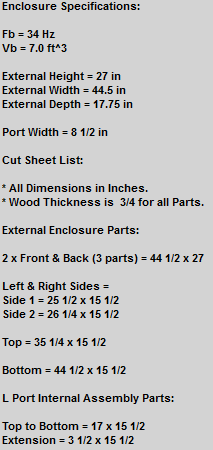

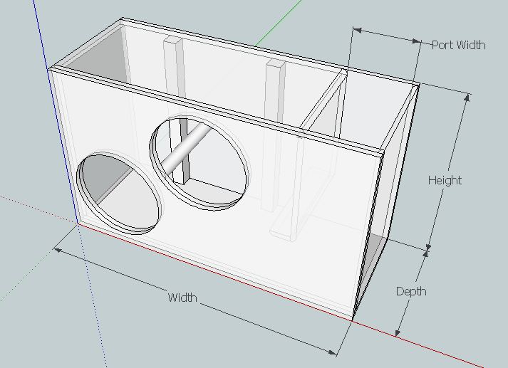

Joe X Posted January 23, 2022 Report Posted January 23, 2022 So here is a suggestion, almost within your specified airspace, amp subsonic filter to 28Hz, figure is just an assembly guide:
Joe X Posted January 24, 2022 Report Posted January 24, 2022 On 1/22/2022 at 11:23 PM, jessdabest77 said: I am not going to be competing just a loud daily on music. I had also thought about 12’s but have had these 15’s for years now and are brand new. I’m hoping I can make it work Posted a box for you that shows you what you can do with the space specified, it's tightly within Fi's specifications and your power but if your expectations are high you will need to give up more space and likely build a wall or a blow through to get the most out of those subs. The "wall" enclosure that tops sp4 box spec would be like this one but 37" high. subs/port forward.
jessdabest77 Posted January 27, 2022 Author Report Posted January 27, 2022 Thanks Joe X I really like that design. I understand I have very little area to work with but hopefully with the right box and and tight power these subs should play loud and low. I was also thinking of an aero port instead of slot port but can not find anything bigger than an 8” round port. I remember seeing some 15’s in smaller boxes do pretty good so who knows but definitely thank you for your help
