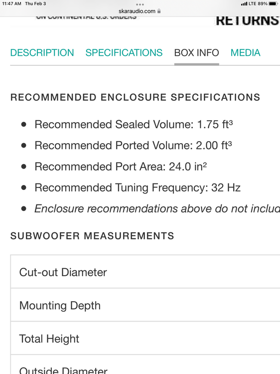

JoeyWelch Posted February 3, 2022 Report Posted February 3, 2022 Hi all. New here and have been enjoying all the knowledge on the site. Thanks My current project is a Jeep (2015) Wrangler JK 2 door. I’m installing a single Skar EVL-12 subwoofer. The box ID’s provide 2 sq ft to work with. That’s max. Sealed specs call for 1.75 and ported call for 2.00. On ported, after backing out port area and displacement Im down to well below 1.4 sqft. Which way do I need to go? Ported or sealed? Sub will have max power on it if needed. I’m thinking I should stay with the manufacturer’s recommendation and go with the enclosure sealed. But I don’t have enough experience to know how smaller volumes affect ported enclosures. Thanks for any advice
SnowDrifter Posted February 3, 2022 Report Posted February 3, 2022 Volume is after displacements. Net volume. Generally speaking, stick to spec. There's a 15-20% fudge factor in there that's still acceptable and can be tweaked to personal taste / needs, but 1.4 is really pushing it. If you don't have the space for a ported box, just run 'er sealed! I reckon you'd have an easier time with a properly sized sealed box vs. an improperly sized ported one. I'm going to generalize *really* hard here because there are a *ton* of variables.... But the issue with going too small on ported being that it's a resonance system, and losing air mass really boinks the behavior - your response curve will tend towards higher frequencies / peaky response. Sort of like how prefabs only really get loud on A Milli. ~~~~~~~~SAY NO TO PHOTOBUCKET~~~~~~~~ Snow's DD-1 tracks here: https://www.stevemeadedesigns.com/board/topic/167433-snows-dd-1-tracks/ My take on OFC vs CCA: https://www.stevemeadedesigns.com/board/topic/110381-things-that-piss-you-off-in-the-car-audio-world/?do=findComment&comment=2461444
JoeyWelch Posted February 3, 2022 Author Report Posted February 3, 2022 Then sealed it is. Thanks for explaining that. That clears things right up for me. Thanks SnowDrifter
