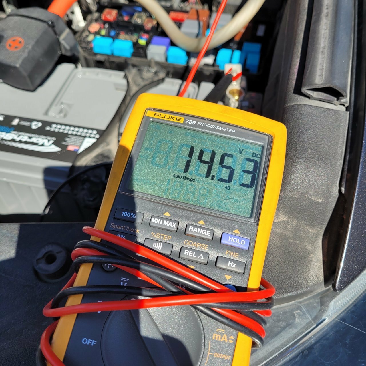

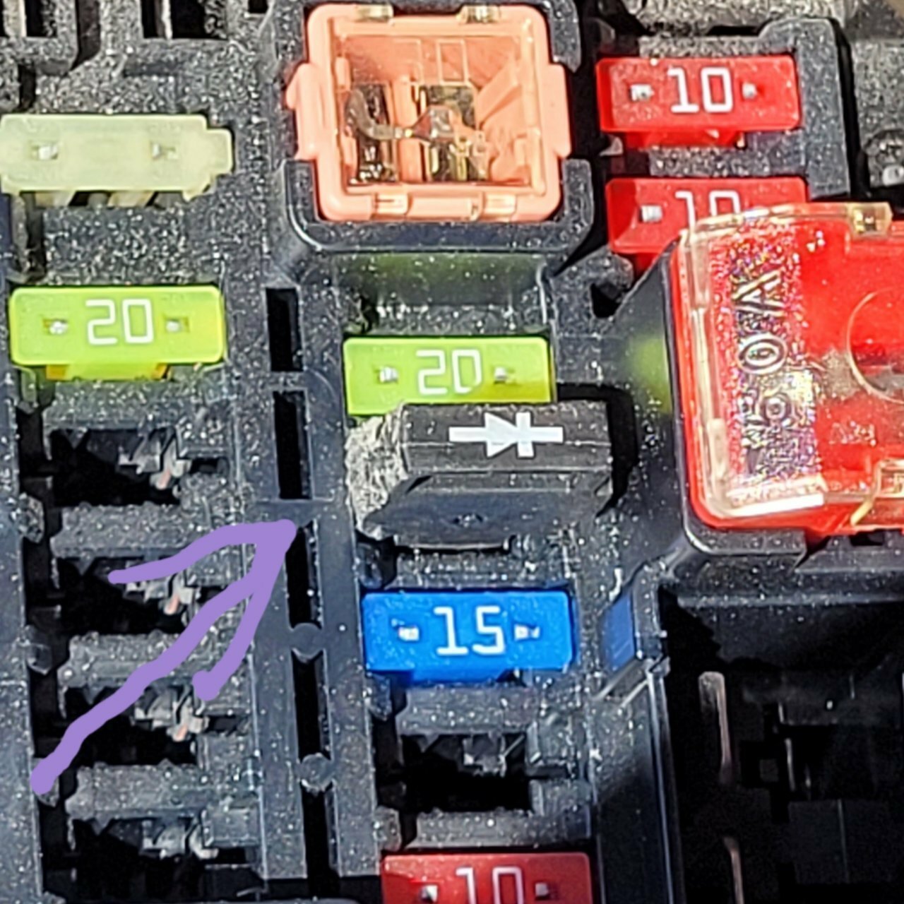

I found, that the 5th gen, has a fused, line, to sense turn on voltage. I got a GMC fuse, with a diode, that tricks the alt to see about 1 volt less, that its actually putting out. (like we use to do to alternators back in the day, to get a higher charge voltage, i use to do the same, but opposite, when running a tick higher voltage, but my amps didnt like 15v,.. id put a inline diode, and show the turn on wire, a volt down, and it did the trick)
I would never see over 14v even cold as balls,... now, even hot.
EDIT-
Part number - General Motors, DIODE, 12135037
