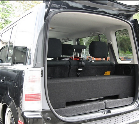

Joe X Posted February 24, 2022 Report Posted February 24, 2022 3 hours ago, YachtMaster said: @Joe X Yea, and ideally I would get that or something similar; however, I do deliveries in this vehicle and have the backseats laid down 99% of the time to make use of the cargo space. That's why I'm limited to the area I've spoke of. I know it's not ideal and I truly do appreciate your suggestions. I'm just hoping I can make something work for the area I do have to use. I assume that worst case scenario, I can do something similar to what @CorNut spoke of, and have some kind of enclosure to fit shallow subs. Do you guys think that would be a better idea, given the variables at play? Depending on what you transport you could do a down firing design, you can place heavy stuff on the top of it and nothing will happen:
YachtMaster Posted February 24, 2022 Author Report Posted February 24, 2022 @Joe X That's exactly what I was envisioning going in that floor board area. I was thinking I would have 3.5 inch legs. I'm assuming those legs are 2" there. Only difference is the box would also rest on the middle hump. So, I was thinking as long as there were a few inches of play between the sub and legs/hump, it might could fly. If resting on the hump is a deal breaker, I could always build it taller. I just liked the idea of it being flush with the top of the folded down backseat. The dimensions look fairly close to what I'm needing, only I would be giving up a few inches in width but having extra in height. With that being said, what subs would work best in a downfiring enclosure (under $300 per, presumably 10")?

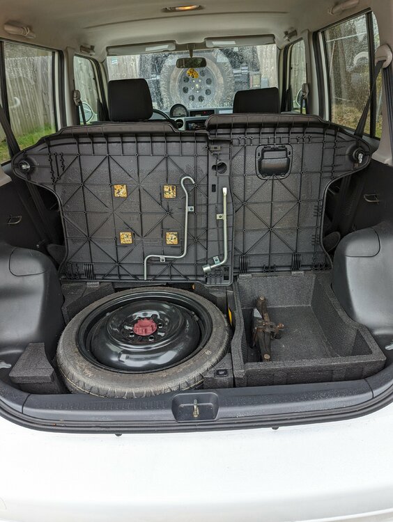

CorNut Posted February 25, 2022 Report Posted February 25, 2022 Is your spare tire under the floor in that cargo area, if so what size is it? By the looks of their no wasted space design, I'm guessing there might not be enough room/height for a JBL Basspro Hub. Have you seen those? Not having a trunk to middle it, it might give you some bass. You won't be floating towels, but your limitations don't leave many options that aren't a lot of work. You don't lose your spare tire with that sort of thing, it sits inside the rim of your spare. I've never seen/heard one, but it should help fill out the sound. Are you willing to build a side firing enclosure to put against the wall of your cargo area? Is it just the depth you need or can you not sacrifice a little width either?
YachtMaster Posted February 25, 2022 Author Report Posted February 25, 2022 @CorNut Yes, it is. It's a T125. Here's what that area looks like with the floor lifted. Unfortunately, I can't do a side firing enclosure either. When I'm doing my deliveries the entire width is used and the depth that I attempted to show in one of the previous images.
