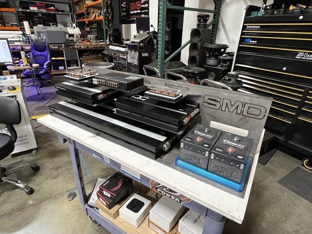

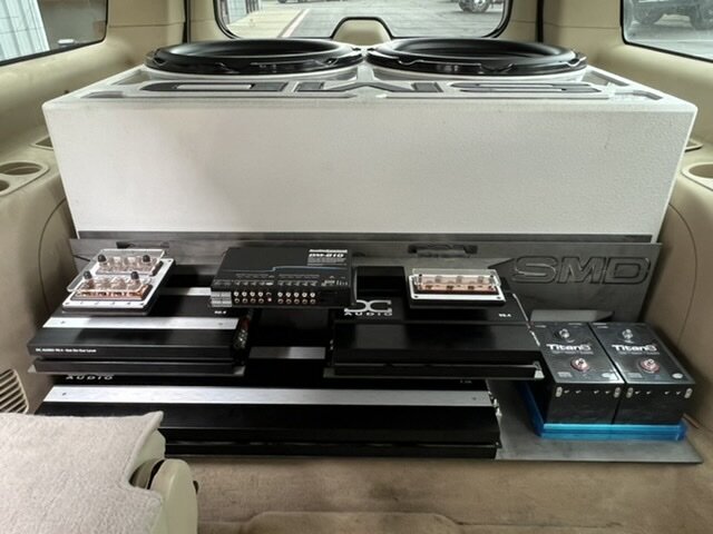

This has been a long time coming but i had good reason for the delay. Time to get started.

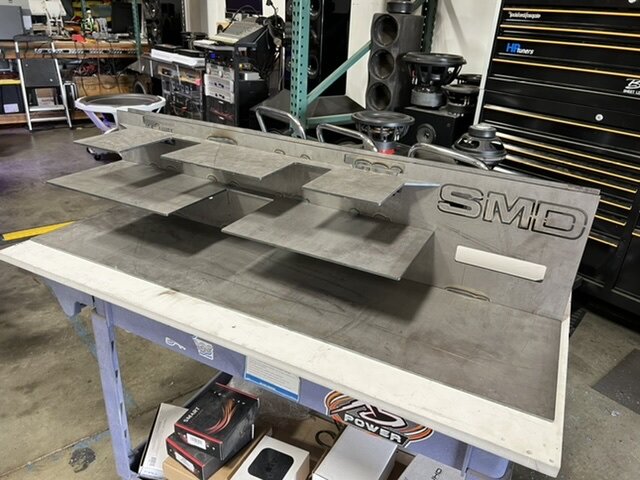

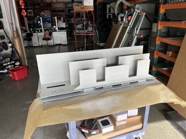

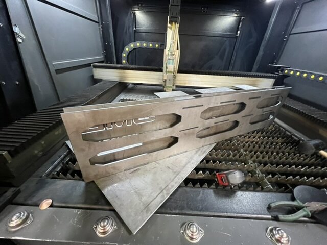

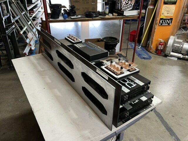

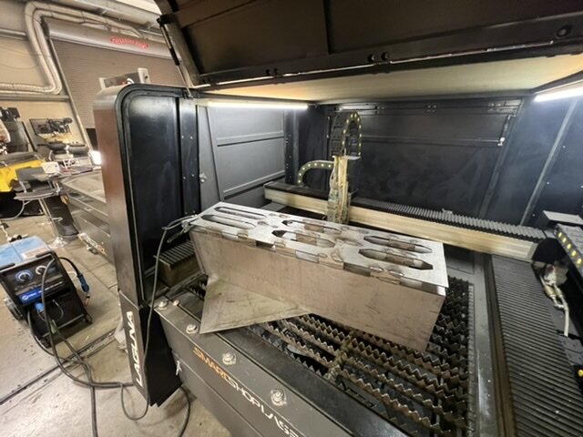

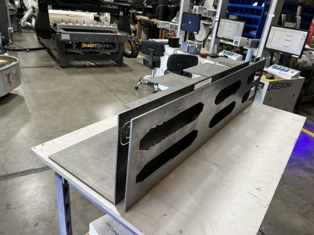

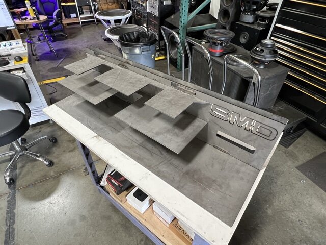

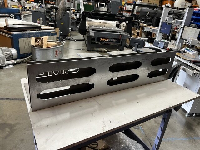

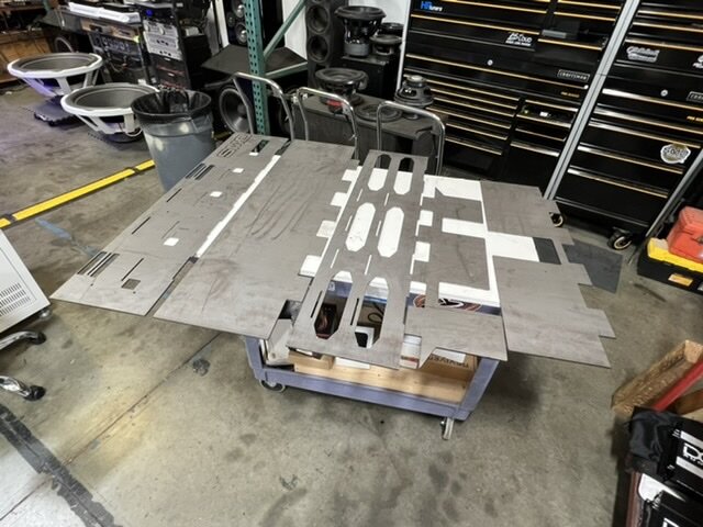

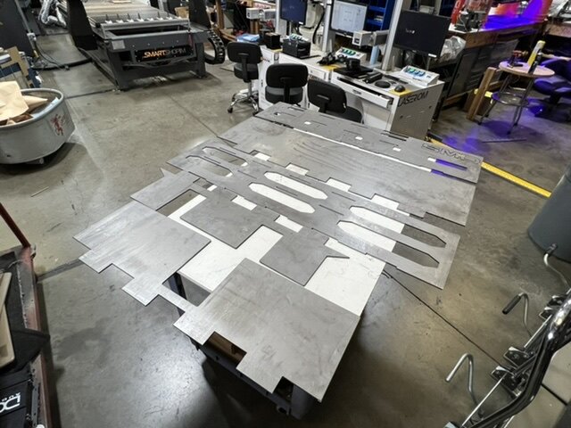

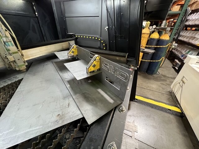

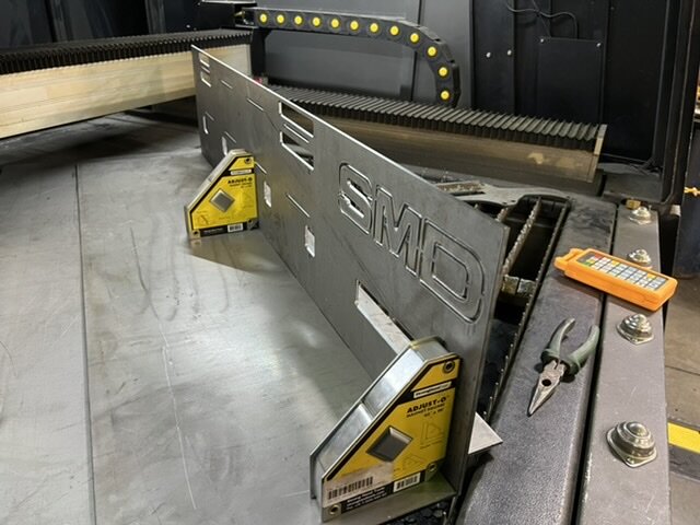

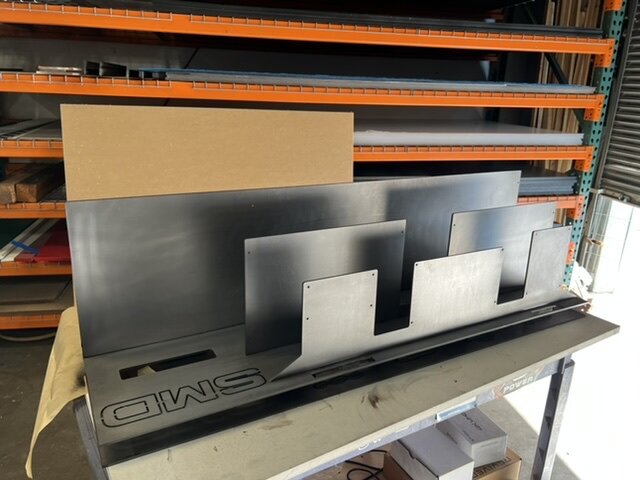

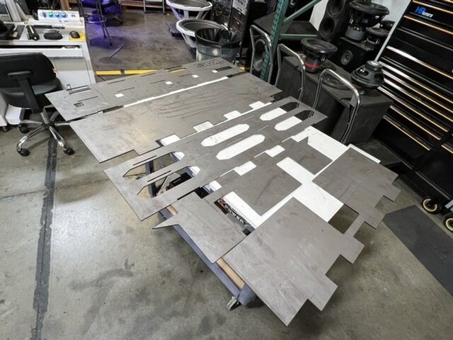

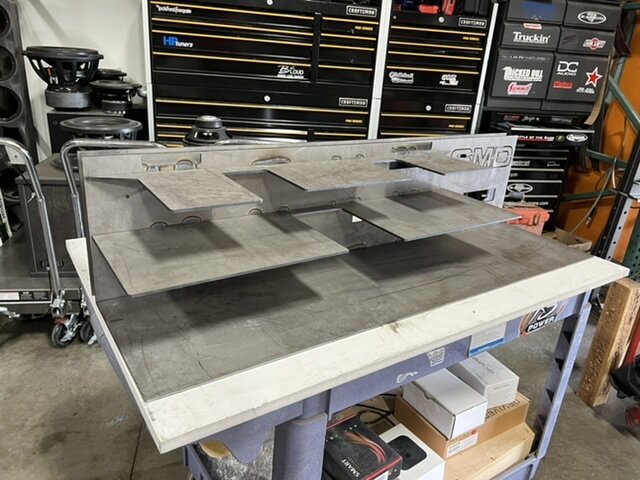

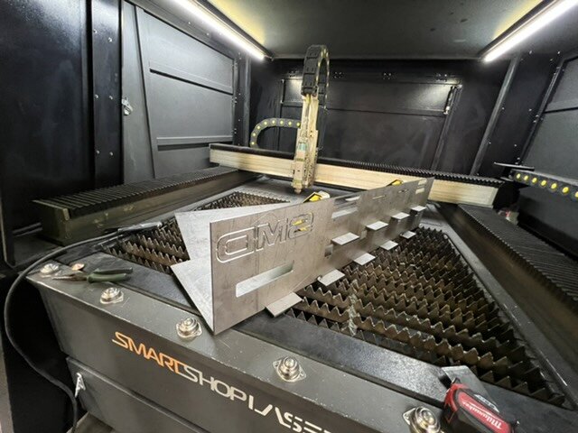

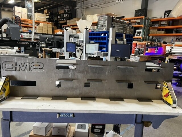

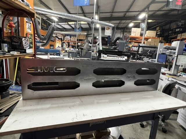

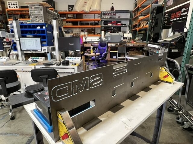

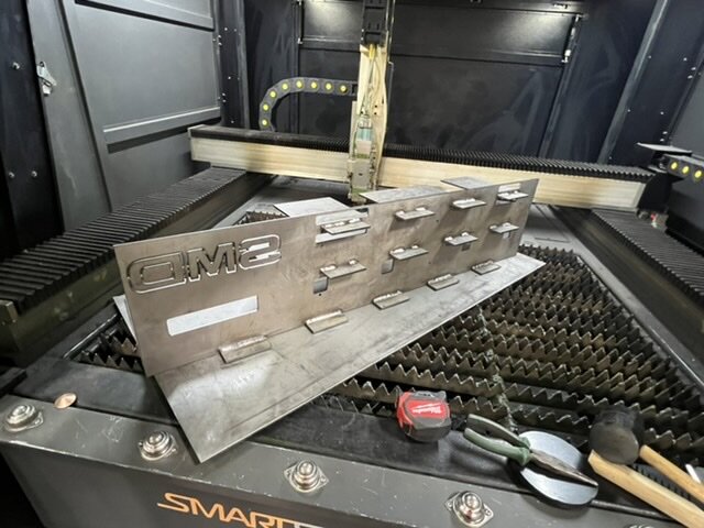

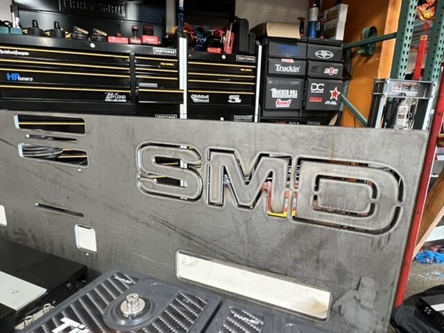

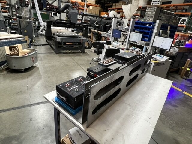

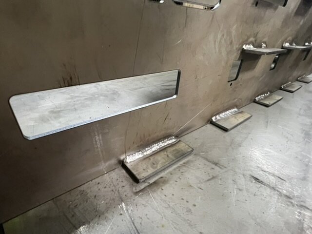

i decided to make the rack out of 3/16 steel and weld it together.

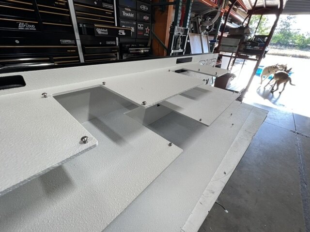

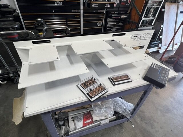

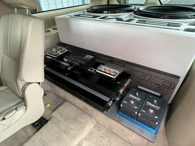

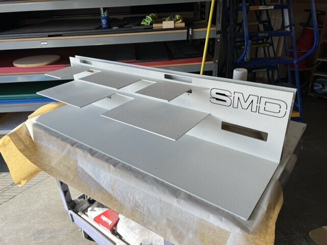

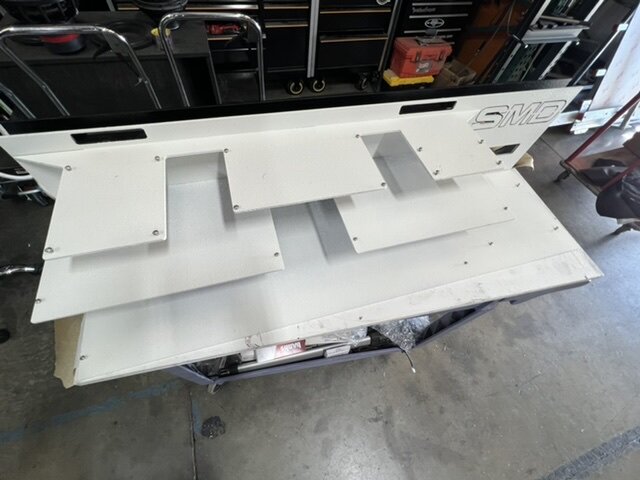

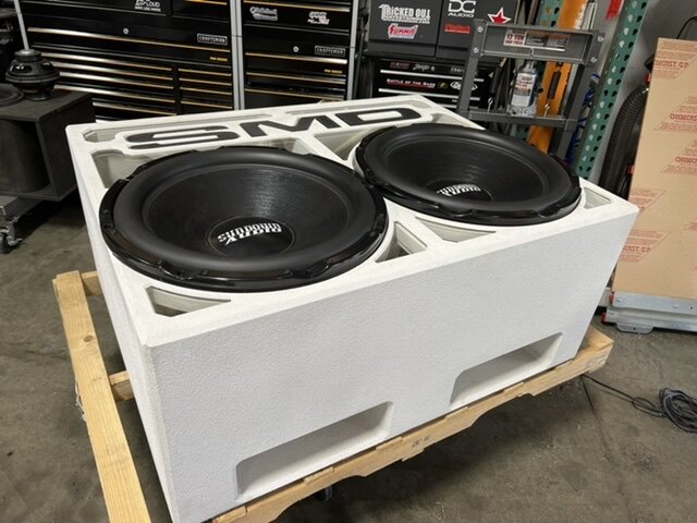

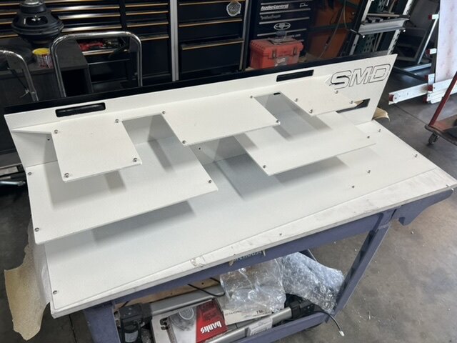

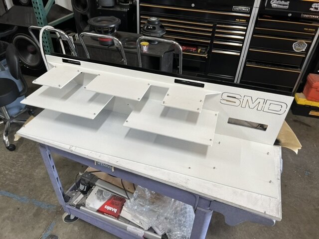

I decided to shoot it to match the box.  I didn't want to spend $300 on a full set (4 quarts) of the "Raptor" liner (in white).  I just needed enough to do this rack.  So i found some in a can at Autozone.  It's still Raptor liner, but in a can.  This took 2 cans to complete and i also shot the back and bottom of the rack in Black liner.
I don't have any shots of me shooting it because i forgot.  I was busy trying to get this done.

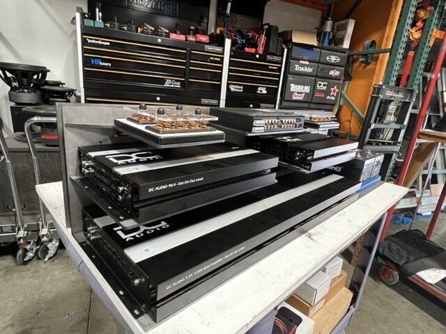

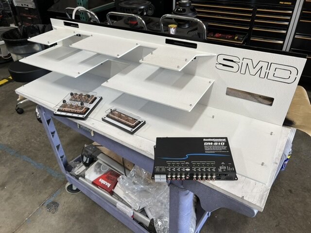

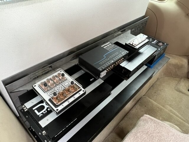

Holes were drilled and tapped for #8 x 32 stainless allenhead bolts.
