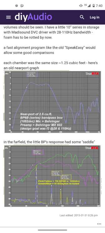

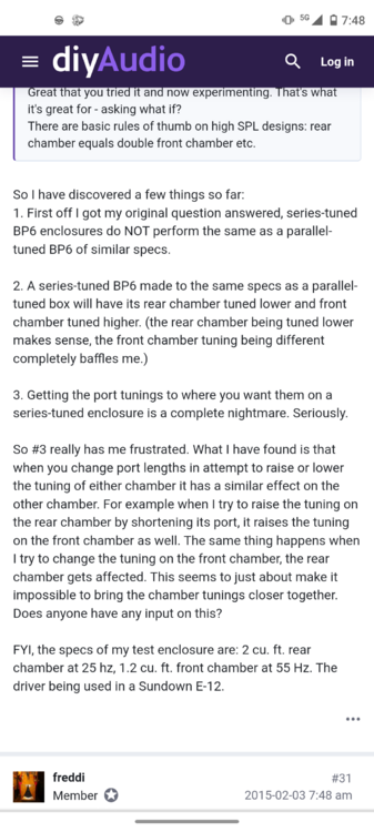

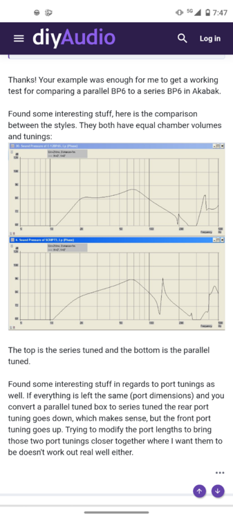

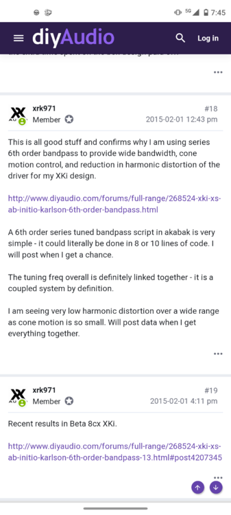

This is the most complete information I've been able to find thus far. It makes more sense but I'm still hoping to find formulas for modeling the relationship between ports.
