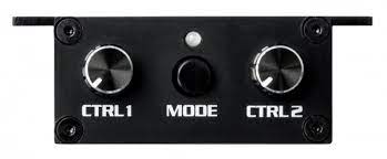

jmanjr82 Posted September 29, 2022 Author Report Posted September 29, 2022 Good info guys keep it coming! I like that idea. What do you mean by controller? I literally know zero about DSPs. So if a DSP has 1 input and several outputs does it matter what you use for the input? Example can you just run rca from the hu sub out to the dsp in and that's all you need? I am leaning towards running 1 4 channel 2 channels for mids and 2 channels for tweets for simplicity. If I need more then I can just double everything.
pnutz37 Posted September 29, 2022 Report Posted September 29, 2022 2 hours ago, jmanjr82 said: Good info guys keep it coming! I like that idea. What do you mean by controller? I literally know zero about DSPs. So if a DSP has 1 input and several outputs does it matter what you use for the input? Example can you just run rca from the hu sub out to the dsp in and that's all you need? I am leaning towards running 1 4 channel 2 channels for mids and 2 channels for tweets for simplicity. If I need more then I can just double everything. A controller is what does master volume and usually there's a separate knob/function for bass or it can be one button where when you push it in it swaps over to the sub volume. The mode button switches between tunes. You're also correct in how it works (For my helix anyway). Single RCA in to the DSP and your output from the DSP goes to the amplifiers. I had a 10 channel and have since downsized to 8 channel. Based on what you're wanting to do, a 6 channel would be ideal, 2 channels for mids, 2 channels for highs and then sub channel. I know that the helix DSP's are more expensive than most but they make up for it with a fairly easy format to do the tuning, RTA, etc
