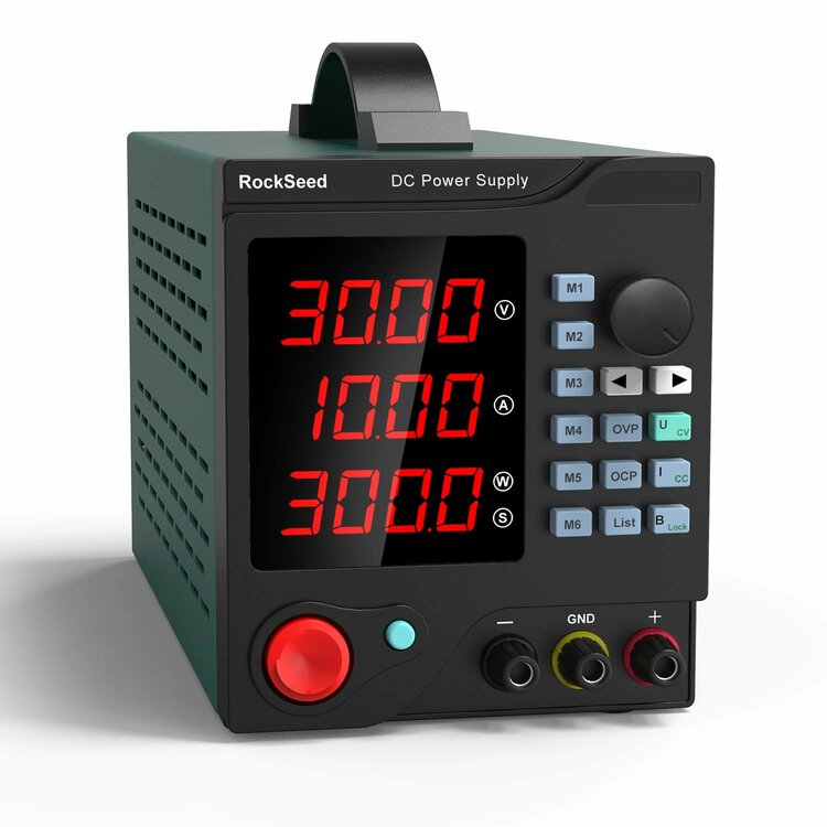

I have a ctek charger also, but its not that I know of meant for lithium. Link to his charger or do you know which one he has? They have like 2amp, 5amp, and 10amp.
I use my Noco-Genius charger. It has a lithium setting. Been using it for about 2 yrs on Headway cells with no problems.
On 10/11/2022 at 11:03 AM, jmanjr82 said:
Greetings I have 96 headway says and I was curious how they should be charged? I am currently going through them and most are showing 3.24volt, but range from 3.24 - 3.28 If they read 3.24volts now they don't need charged correct? They can just be made into the banks and charge from the alt? In the event they do need charged can I just use the limitless lithium charger I have? If not what charger should be used like 12v 5a? Feel free to link chargers. I do have balancers 1 per 64ah bank.
azon.com/HANMATEK-Programmable-Variable-Regulated-Interface/dp/B07SS77N7K/ref=sr_1_2?crid=22PHWX0MCNHQ9&keywords=rockseed
