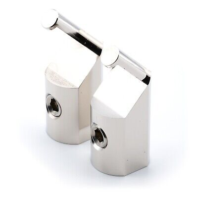

The T1500 inputs are super close together for power and ground...I tried 1/0 to 4 AWG reducers and they touch each other.  No bueno.  Also, the length of the 4AWG portion of the reducers was too short to reach all the way into the opening (the power and ground inputs are recessed) This would require custom made reducers.
