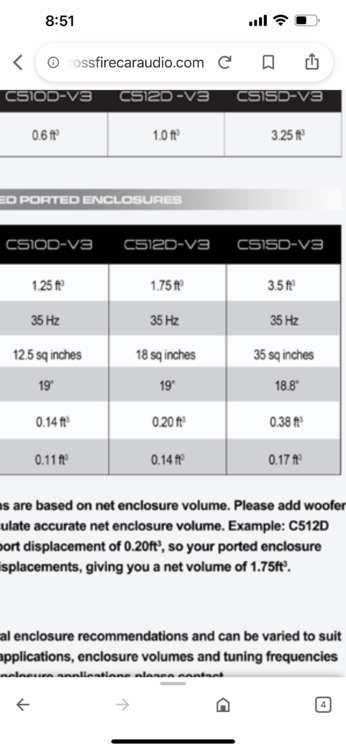

Most of the time, rear fire is louder in trunk builds, unless you completely, and I mean completely seal it off. Which rarely happens correctly.
  Running C5’s myself. 15s here. In a 7 cube enclosure. (Gately) on a damore 1500 at .5.
I think the 12s ask for 1.75 per. So 3 cubes after everything. You may wanna double check your vent/vent area. Look at the cross fire web site, and not down for sound or whatever.  I’d tune it a bit lower also, but that’s me, and what I did.
 Not sure what’s up with hours, but mine pound. Never get hot, have great mechanical control, dig deep, and sound great.  Greatly impressed with such a cheap driver. Glad I got them on a few friends recommendations that are on team Xfire.

Your box specs are like 4.2 net @32-33Hz with 39 square inches of port area. A little larger than spec but nothing crazy.
So what is your question? Not loud enough? No sound quality? Not low enough?
Anyways, what is the amp model, what is your electrical, do you have upgrades? etc.
