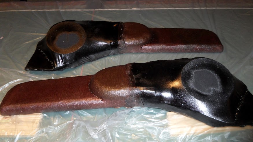

got160s? Posted April 16, 2013 Report Posted April 16, 2013 Door pods for these guys Making a template for the general shape of the pod from the door panel transferring them over to some of that pink styrofoam stuff cut out the foam and started to add pieces and shape it to get ready for resin and glass More foam went on after ^this picture was taken and then the foam parts were wrapped with plastic wrap so the resin and glass wouldn't stick to it. Then stretched the cloth and here is how they looked after the first resin layer. No glass yet. very nice fabrication work sir! Vehicle: 1999 Chevy Suburban AKA The Bammin' Beast Battery: 25 XS Power XP1000's Sub Amp: 3 DC 9k's Sub Stage: 18 DC Lvl 4 M2 12's in a Nasty 4th Order http://youtube.com/user/got160s Subscribe now! Prizes will be given away for every 1000 subscribers!
