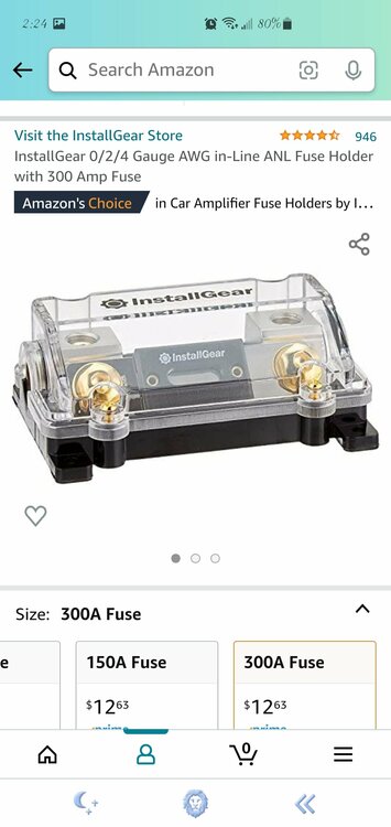

I stumbled across this while looking for a 300 amp fuse for my amplifier which was a kicker zx2500.1 and I'm wondering if this would work just as well as a fuse and if not can somebody Supply me with a link showing a photo of a 300 amp fuse and what type I would need to get. I found this on Amazon and here is the link for you to check out. This is what I'm thinking I'd like to go with if it is recommended if not I need to see the proper fuse type I can do the rest of the hunting. Much love and ground quakes from block to block making people think it's earthquakes.Tap here to see what I'm considering  if somebody can provide a link to one that is a good brand and is on Amazon that would be sweet but not necessary. I'm just stating that because I have an Amazon Prime account right now and it would be nice to order it before my account Runs Out. Thanks again

That's a breaker it will work but this is traditional

Much love and props for the quick reply. I see what you're saying and the one in the photo you showed me is what I'm used to but I could not find one that would hold the three hundred amp fuse and was the type in the photo. I'm going to grab one now and hopefully it will be here within a week or so but I can be patient because the payoff will be worth it. From what I read it's best to put one close to the battery and then a second one close to the amplifier on my positive cable which is 0 gauge. My ground is only two feet long and connects directly to frame so hopefully I won't get any alternator whine or any annoying sound of any sort. I'm also missing the bass boost knob and don't know where to get one for this amplifier other than the manufacturer but the amplifier is no longer carried by kicker or at least no longer produced so I'm assuming they have none left but maybe I'll get lucky and they will have a bass boost knob with wiring that has the funky phone cable and on The Wire that goes into the amp. I'm sure I can track one down and I'm not the only person who's ever needed a spare. Thanks again my friend you have led me to the pot of gold. Keep slamming.

You fuse for the wire near the battery then fuse for the amp(s) near them. The best method for me is a fused distribution block near my amps. Something similar to this: http://www.knukonceptz.com/mobile-audio/distribution-fuse-blocks/sp/bassik-2-way-10-to-4-gauge-fuse-distribution-block/
If you're only running 1 amp, a basic mini ANL or similar fuse holder will work fine.
If you have KnuKnoceptz Kolossus 4awg, it's rated at 150A so you'll fuse 150A near the battery, if you have 2 amplifiers, one 80A and one 50A, you'll do a distribution block near the amps with an 80A & 50A fuse. The wire's fuse doesn't have to match the max draw of your amplifiers.
