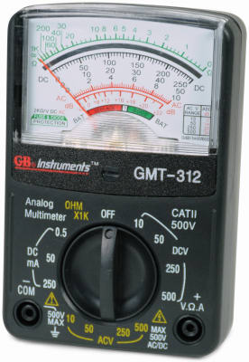

Terry Lee Posted July 4, 2013 Author Report Posted July 4, 2013 Also. You can't wire a dual 2 ohm sub to 2 ohms, only 1 or 4. i could do that, but i didnt know if that would be good or bad. its a 2 ohm sub, if i get this working would making it 4 ohm be better in any way? sounds like an electrical issue, perhaps. If the power wires are connected poorly, i.e. loose or dirty, as well as too small to supply the needed amperage the voltage will drop to supply the amperage to the load. voltage drop = protect mode on some amps. as well as input and output overload. i suggest running a test tone and observing voltage at the amp POWER connections while raising the volume..... you first may want to match the gain of the amp to the output of your head unit. or have someone more experienced (with a dd-1 perhaps) assist you with that. i just have one question to test the voltage.i dont know what im looking for with this crappy multimeter i have. this is a picture of it, can you please tell me what to set it for and what im looking for as a reading. i think it is the voltage system in my car, but my lil cop scanner thing has a voltage detector on it and says my car is fine, i dont wanna trust that, so this is an image of my crappy multimeter https://img2.activant-inet.com/coop/truserv/image/g585034.jpg

Terry Lee Posted July 4, 2013 Author Report Posted July 4, 2013 I meant that Isn't a possibility to wire it down to two ohms. 4 ohms might be your only option depending on the amp that you are using. i have 2 different amps. the one it came with, which was professionally hooked up as a 1 ohm, and the power acoustik gothic series, i have both of there info in my first post. its the one it came with, wired up as 1 ohm atm. i drilled a new ground, sanded it down, same problems, dont think its ground, but i dont know what to look for as a reading on this voltimeter, i know 12v is usually good, but i dont know how to check for 12v with all these diff knob settings

Terry Lee Posted July 5, 2013 Author Report Posted July 5, 2013 so, i just bought a new multimeter, digital auto type. everything reads right around 13.5 all around, but on the alternator, its like..... way to high, when i touch it it starts at 170 ish, and keeps going up and up and up, like its to high to detect, i pull off the altimeter around 280v. so alternator putting out to much juice would cause this problem right? just checking. i need to get a new one anyways if this one is doing some crazy stuff like that.
