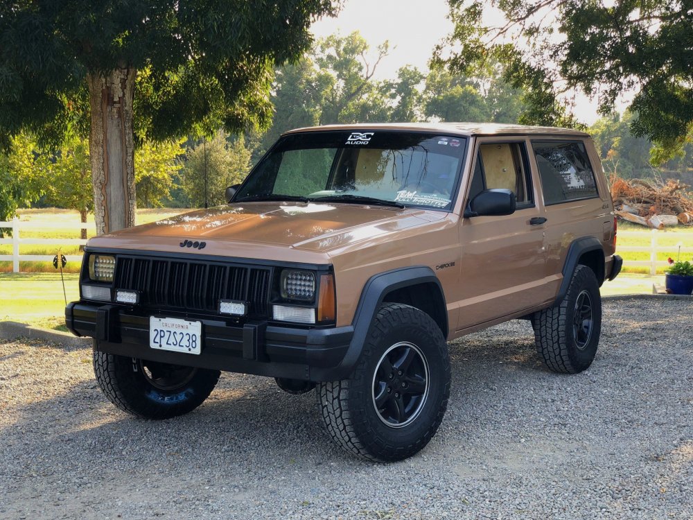

This was my long time daily driver and first car. Currently am running 6 12's in a series 6th order wall. I regularly take it to events across the western U.S. It has seen 7 builds as far as I can remember. The better known was the previous 2 18's in a flat wall boasting my best scores to date of 162.2db Db Drag style 164.2 USACI. Today it is on half that power but maintains mid 156's drag style at 26hz and 161s at 35hz USACI style. Defiantly a demo friendly build.
The Car:
(1990 Jeep Cherokee XJ 4.0L)
(6) JVF Customz 3.3 12s
(4 Pairs) Audio Dynamics 3000 Series Components
(3) DC Audio 3.5k's
(2) DC Audio 90.4's
(6) Full Throttle Group 31 Batteries
(2) JS Alternators
The Wall Build Started in November 2015
Last pics of the car before stripping it out (In near stock forum just after finals 2015).
